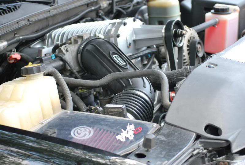

DAMNNNNNNNNNNNNNNNNNNNNNNNNNN thats sexy. Did you have to do an inline pump for fuel? Did you go with the 42# injectors? I bet she scoots man i love it!

The kit came with an auxillary in-line fuel pump and larger 42# Bosch injectors.

Which intake are you asking about...intake manifold or intake air box assembly? I re-used my aftermarket filter/airbox assembly (minus the tube) and put my intake manifold/injectors/fuel rail in storage in case I need it for whatever reason later.

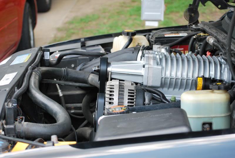

... on my Whipple I get no lag, the response is instant, if the Radix is twin screw it should be pretty much the same.
I don't know why I typed the Radix is a twin screw. It's a roots, and the power is defintiely there on tap.

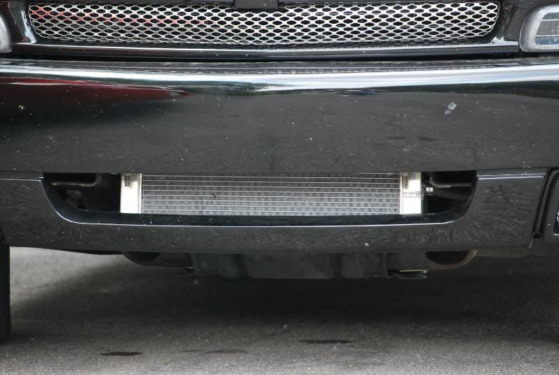

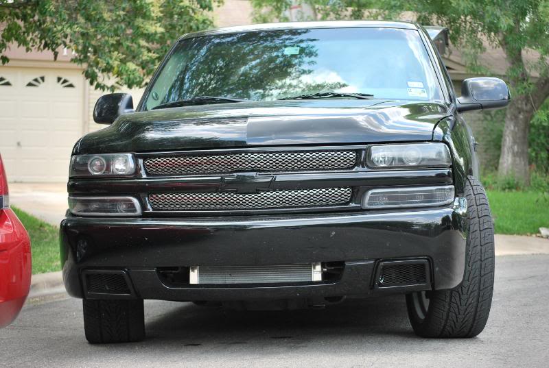

Couple more pics of the intercooler and blower.
