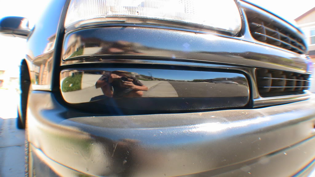

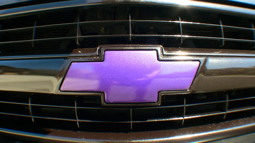

I painted my grille with adhesion promotor, etching primer, regular automotive primer and my body color mixed in a spray can with clear coat and this is how it turned out
grill and turn signal (blacked out with Rustoleum Lens Tint)
a close up of the grill

So you didnt sand or anything? I'm planning on doing my rear bumper as well, the only chrome I have on the truck is the grille, rear bumper, and front bumper. Not sure what I should do about the front bumper. Looks like im tackling this tomorrow! You think its ok to paint in like 60 degree weather?
