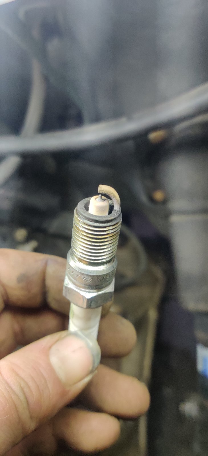

Are you going to swap that with another cylinder's plug to see if the misfire follows?
I'm not liking the condition of the wires, upon closer inspection.
Also I noticed the tiniest crack in the boot for the fuel pressure regulator vacuum hose

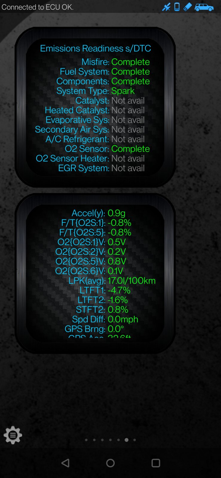

Well I swapped plugs cylinder 5 to cylinder 3. 5 still missing the most on the graph. Occasional cylinder 4 and 1 miss.
Spraying intake with water didn't change idle or fuel trims
Ltft1 reading a steady -2.34 and ltft2 reading a steady -1.56 at idle
