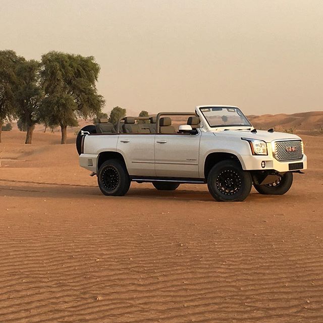

i think with this setup no more cabin pressure
