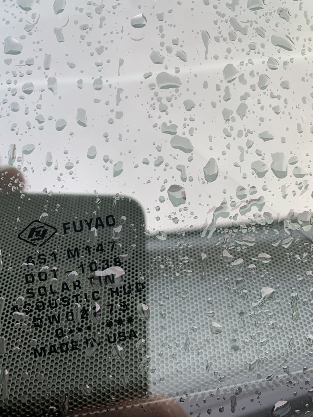

So it appears the windshield has been replaced at some point...
The wife informed me she noticed a whistling or “air moving” sound coming from the drivers side windshield area while driving the other day... I’m gonna hop in and take a spin, see if I can replicate that... if so I’m leaning hard towards a crappy seal on the replacement windshield...

So it turns out that the windshield was definitely the culprit. Took it to Silveira GMC and they put it through their rain shower.
The best news, however, is that the sellers have agreed to pay the full price of repair. Brand new windshield plus full front carpet and all the underlay. Total cane out to just under $2k, and the selling dealership is picking up the tab.
