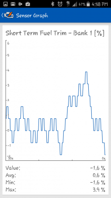

Check the fuel trims. My guess is you are running at least +14% fuel correction on each bank. At your mileage/age, that intake manifold is probably leaking if it's never been done. Also the spider injector units have been updated to have actual injectors at each leg instead of just pintles and fuel pressure regulators are also know to leak at that mileage/age.
I also agree with SUBURBIAN and everything he has said.

76elky
76elky
Jul 14, 2014
14
my fuel trims at idle
Screenshot_2016-04-12-16-58-43.png Screenshot_2016-04-12-16-58-02.png Screenshot_2016-04-12-16-58-43.png Screenshot_2016-04-12-16-58-02.png
