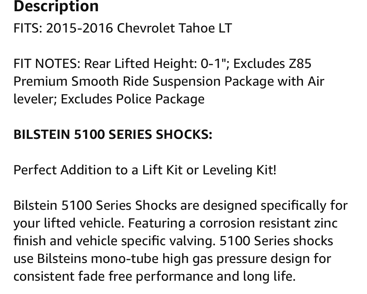

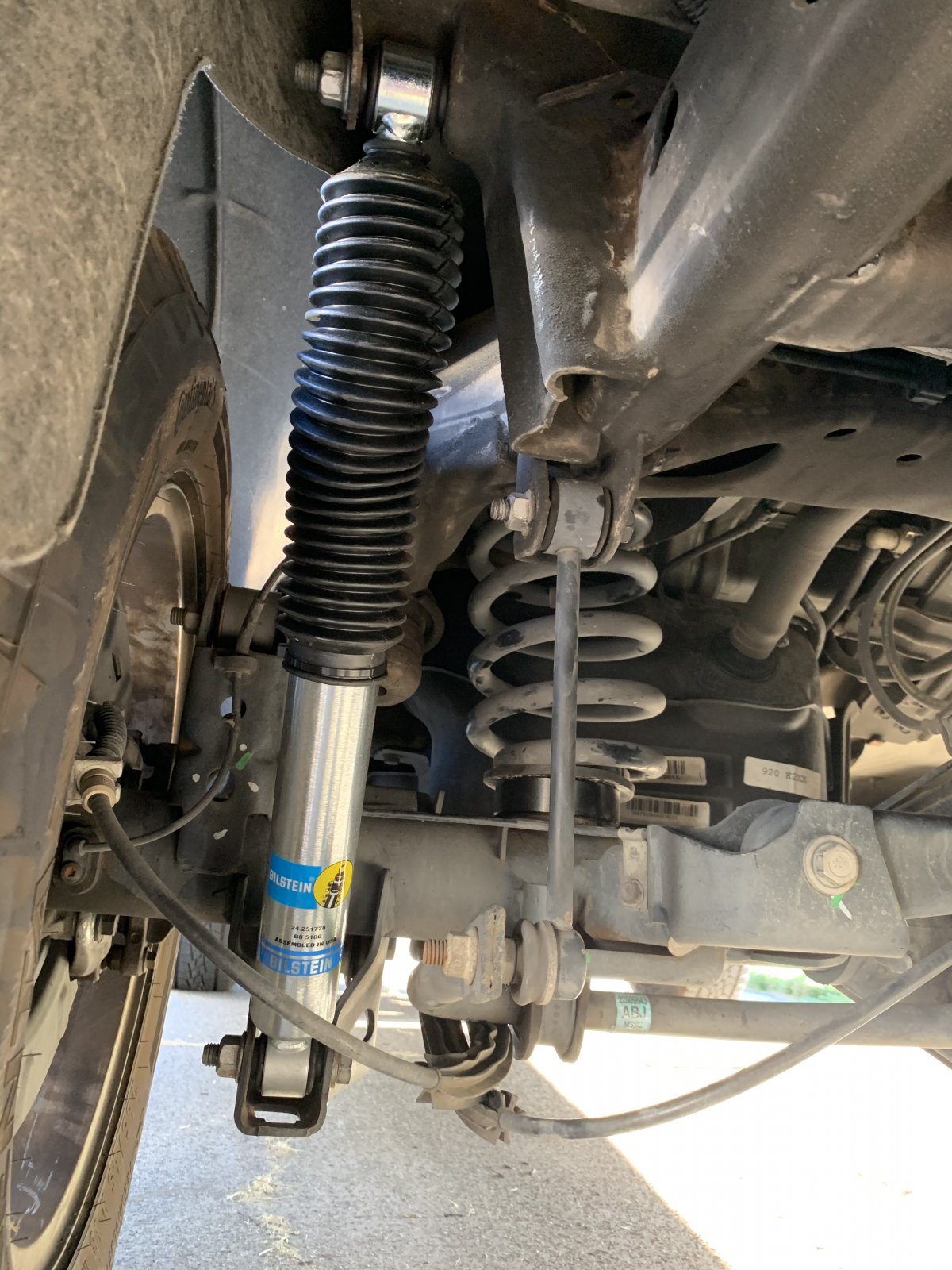

Just to close out this thread, I did NOT have Nivomats for rear shocks. (durr)
Replacing the rears was definitely worth it. The difference is night and day with 5100's all the way around, just like all of the other posts brag about.

did you use a spacer with the 5100s - or do they raise the rear by themselves?

The shocks themselves just allow for an extra inch of travel internally. You still need spacers or taller springs for a lift. The Chevy dealer finally got my insulators in so I’ll be putting 1 inch spacers in this weekend.

So it turns out I had regular shocks. No air or auto/self level. 2015+ ZW7 code "premium smooth ride" that does NOT have the accompanying G65 code does NOT have Nivomats. 2015+ may not even have them at all. Can't verify, though. A quick visual under the truck should tell you. Nivomats are girthier than a regular shock.

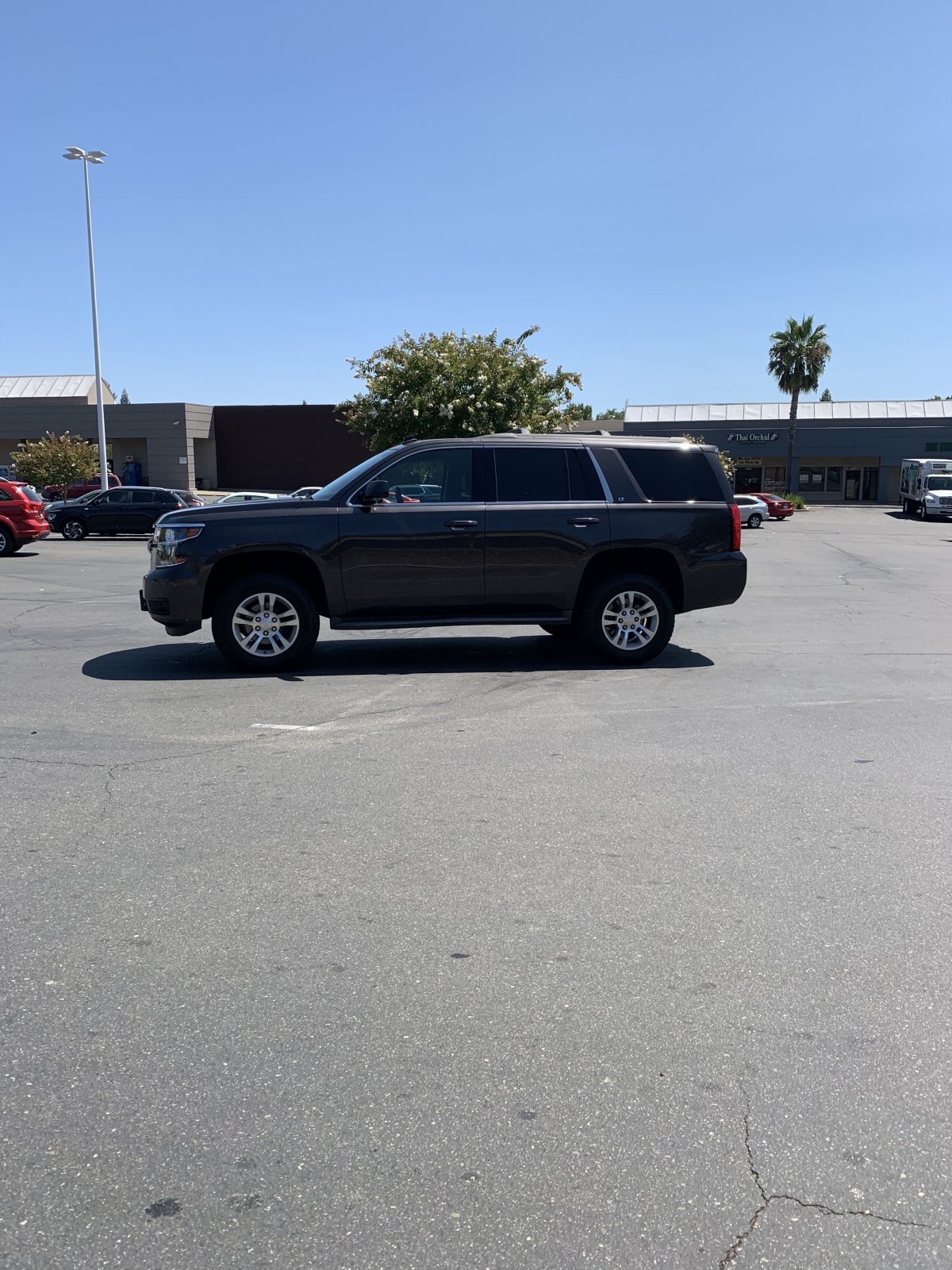

Finally done. Now it’s 1 inch higher in the back than the front with the 1 inch spacer and new insulators ( a 1.5 inch net gain ) I expect it to settle a little bit based on how pancaked the old spring insulators were. The bottom ones were almost worn through. Tops weren’t bad.
