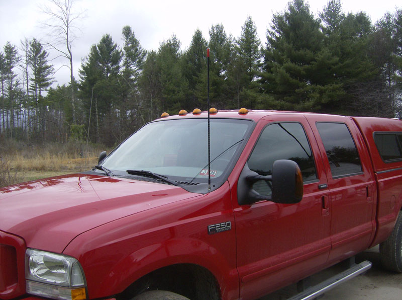

im gonna mount my antenna the same way as you want to, i bought a cb roof mount from firestik cause i already have a 5 foot fiberglass whip from firestik, good antennas, probably the best one ive ever owned and they are pretty affordable too, i think i got mine for like 35 bucks, and the mount is 15 so pretty cheap for a really decent set up if you ask me

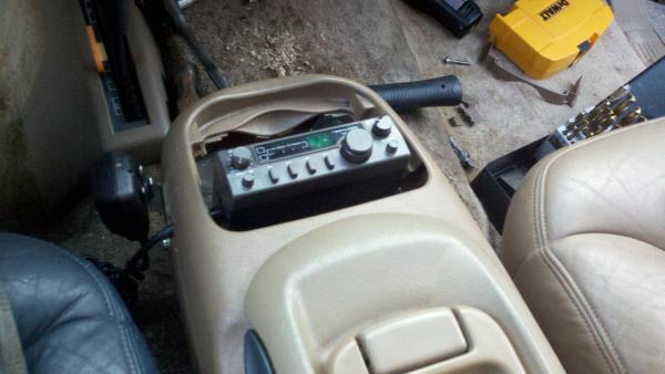

I hated the CD holder so I found a better use for it. Ill be trimming the door to fit around the radio as a trim piece. Hopefully it will look factory when Im done.

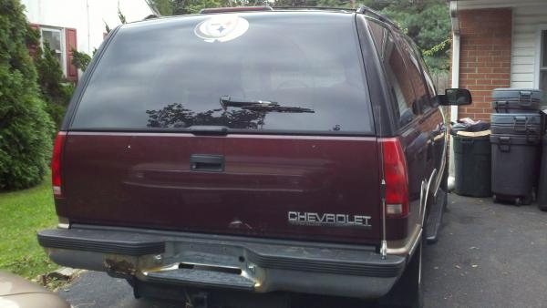

This is my placeholder for where my whip antenna will be mounted. Ill probably be getting a 6-8' whip and tying it to the roof rack when off-roading to keep better clearance. (Like the military HUMMER H1) I should note that I really only use my CB off-road to talk with my fellow trail riders, who are usually behind me awaiting me to test ground clearance :)
