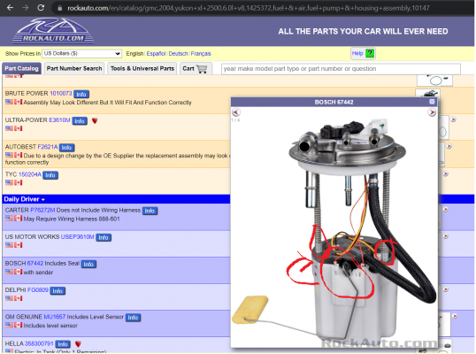

i have a 2004 yukon denali xl and my fuel pump failed, i started searching for a new one but the gm/acdelco is quite expensive.
i found this (Bosch 67567) in ebay and amazon but it says it doesnt fit my car, they show that this one does Bosch 67442, does anyone happen to know which one fits better for my car?

update: 1>
i should had bought Bosch 67567.
I ordered the Bosch 67442 and installed in my truck and it seems to fine, im getting better miles and the car runs smother, but i had this issue:
1. It didnt fit right away, i had to shorten the springs length and the two pipes holding the springs and pump together around 1cm (0.39 in).
2. Fuel Level Sensor its under the feeding fuel pipes (it works),and not in the side like the one I had installed which the Bosch 67567 shows in the pictures.
I had to improvise because returning the pump will take like 7-10 days and then ordering Bosch 67567 it will take the same days to be delivered ( I live in the Middle East and bought it from Amazon).
