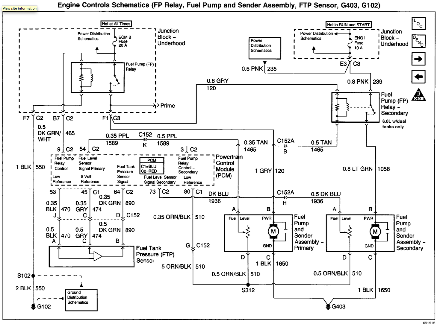

I installed a new A/C Delco fuel pump in my 2001 Yukon . I went to splice the new supplied connector but the wiring diagrams supplied by Delco do not match my factory wiring. I have an purple, grey, black and orange wire. There diagrams do not show an orange wire. Any help would be appreciated

Orange wire is actually Orange with a black stripe.
A - Purple
B - Grey
C - Black
D - Orange with black stripe

Why did you have to splice wires ? I just replaced mine and didnt have to splice wires. Mine is a 2004

There is an updated connection at the fuel pump. A/C supplies a new harness with there fuel pumps.
