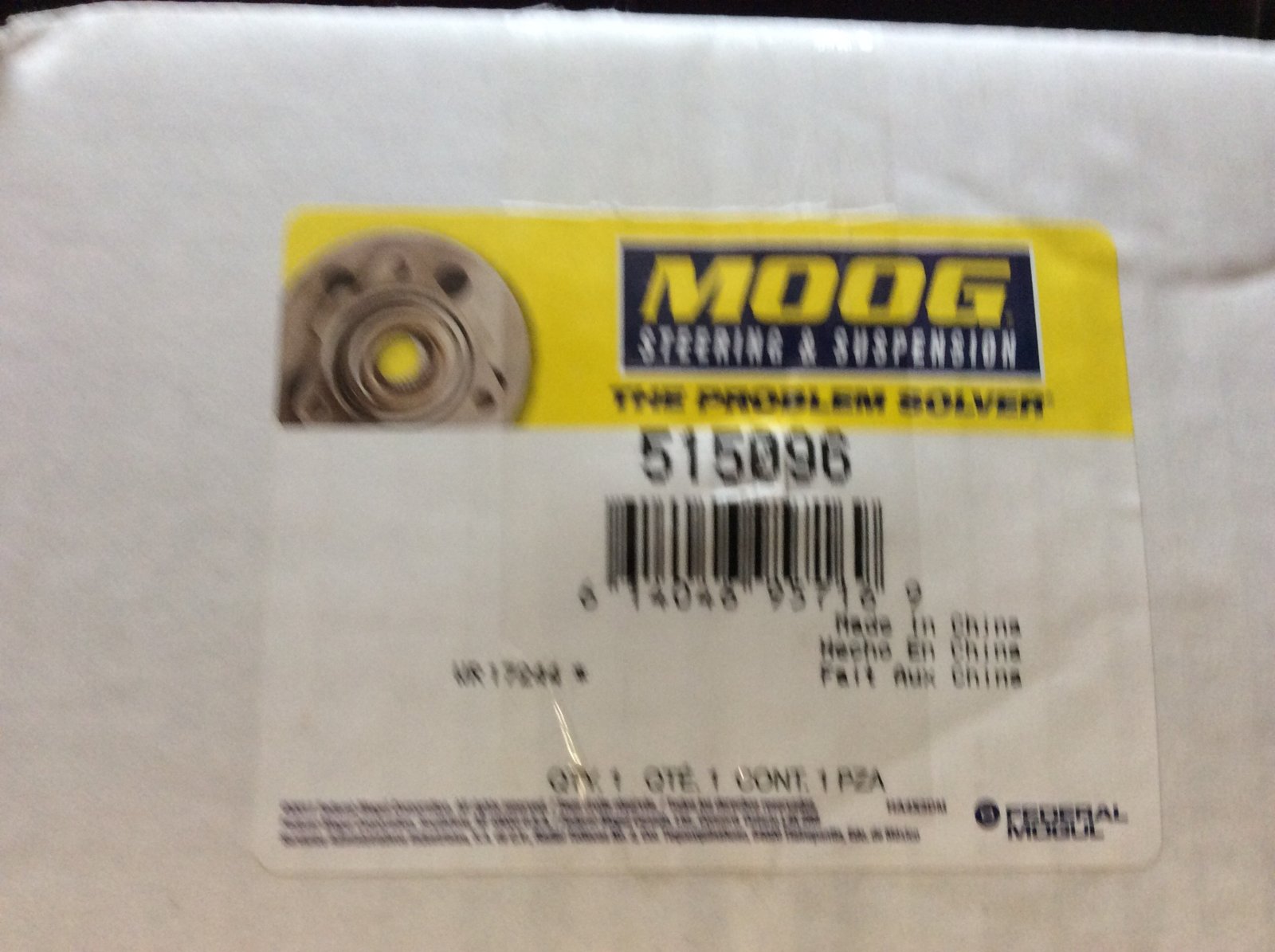

I used to use Timken but moog is pretty decent too and comes with a 3yr warranty instead of 1 yr with Timken
warranty's usually work out in my favor.......I buy lifetime products whenever possible because it then becomes a one time expense.

Your replacing the wheel bearing and hub correct? No point in just replacing bearing when you get hub, bearing and sensor for $120ish each... AcDelco/Moog replacement whenever possible. GM spent billions in R&D and Moog makes great parts.
https://smile.amazon.com/gp/aw/d/B003UEBQ2E/ref=ya_aw_od_pi?ie=UTF8&psc=1
Always use AcDelco site to find your correct part number.
http://parts-catalog.acdelco.com/catalog/catalog_search.php
you can't just replace the bearing.....not on the front anyway, it's a complete assembly
31,335
49,834
the moog is $123+ shipping and 5% off with the code on rockauto if you don't have prime
