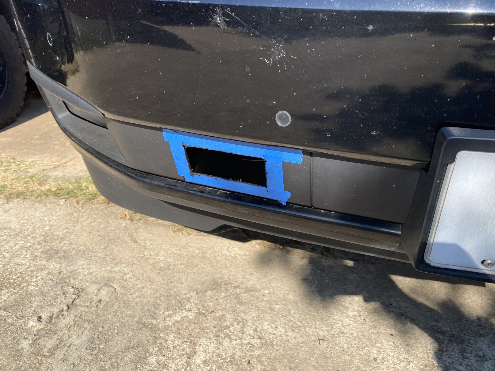

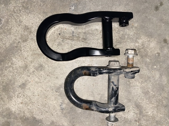

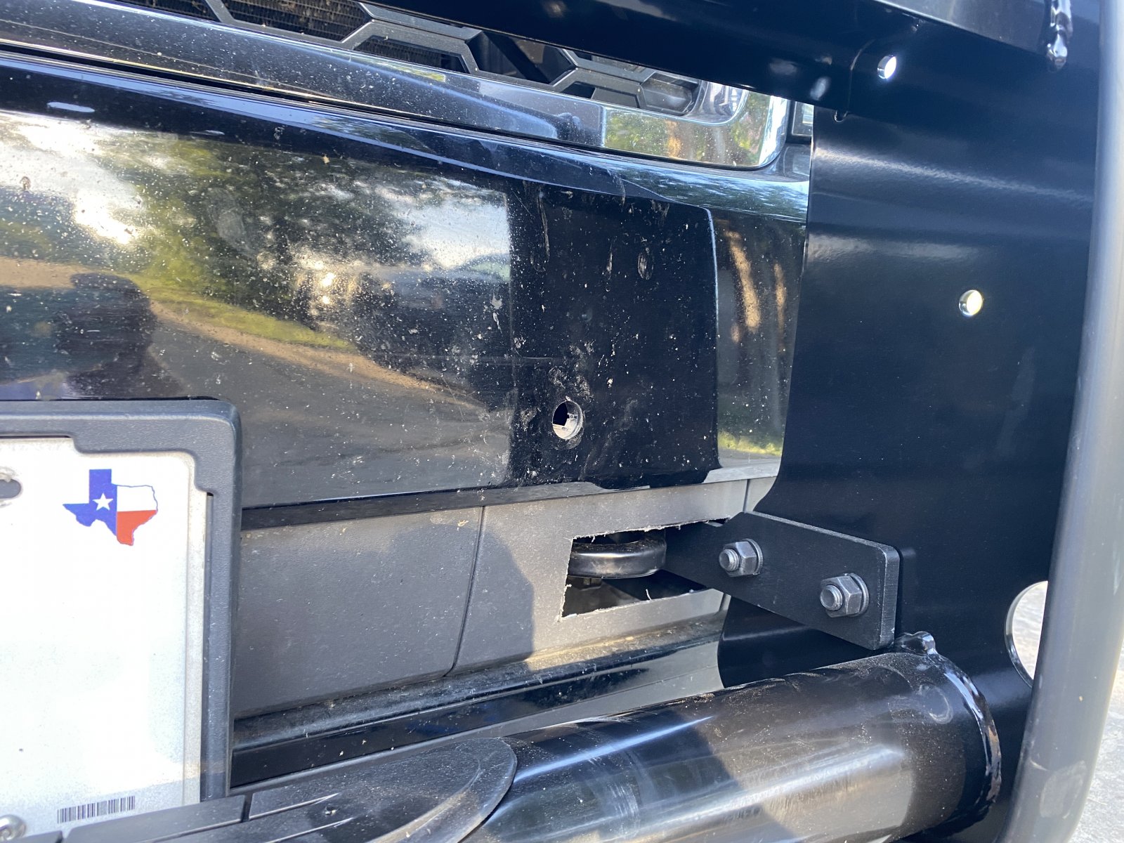

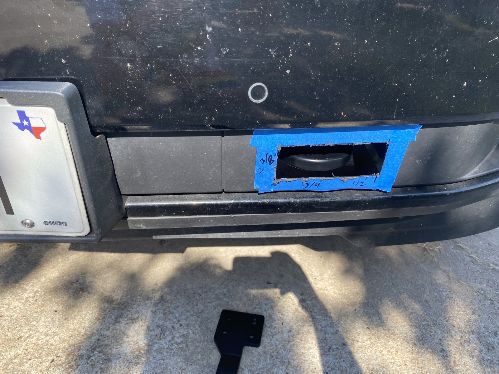

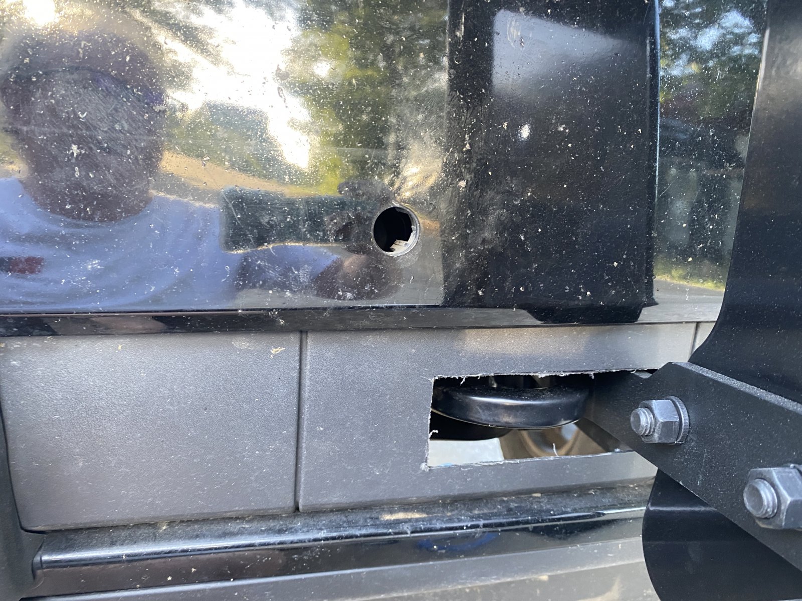

I added a GoRhino bar on mine. I added stock K2 hooks, and carefully opened up the fascia with a dremel. After I think I trimmed another 1/4” in width and height. Be sure to use K2 hooks, not those for GMT900, because of length.
