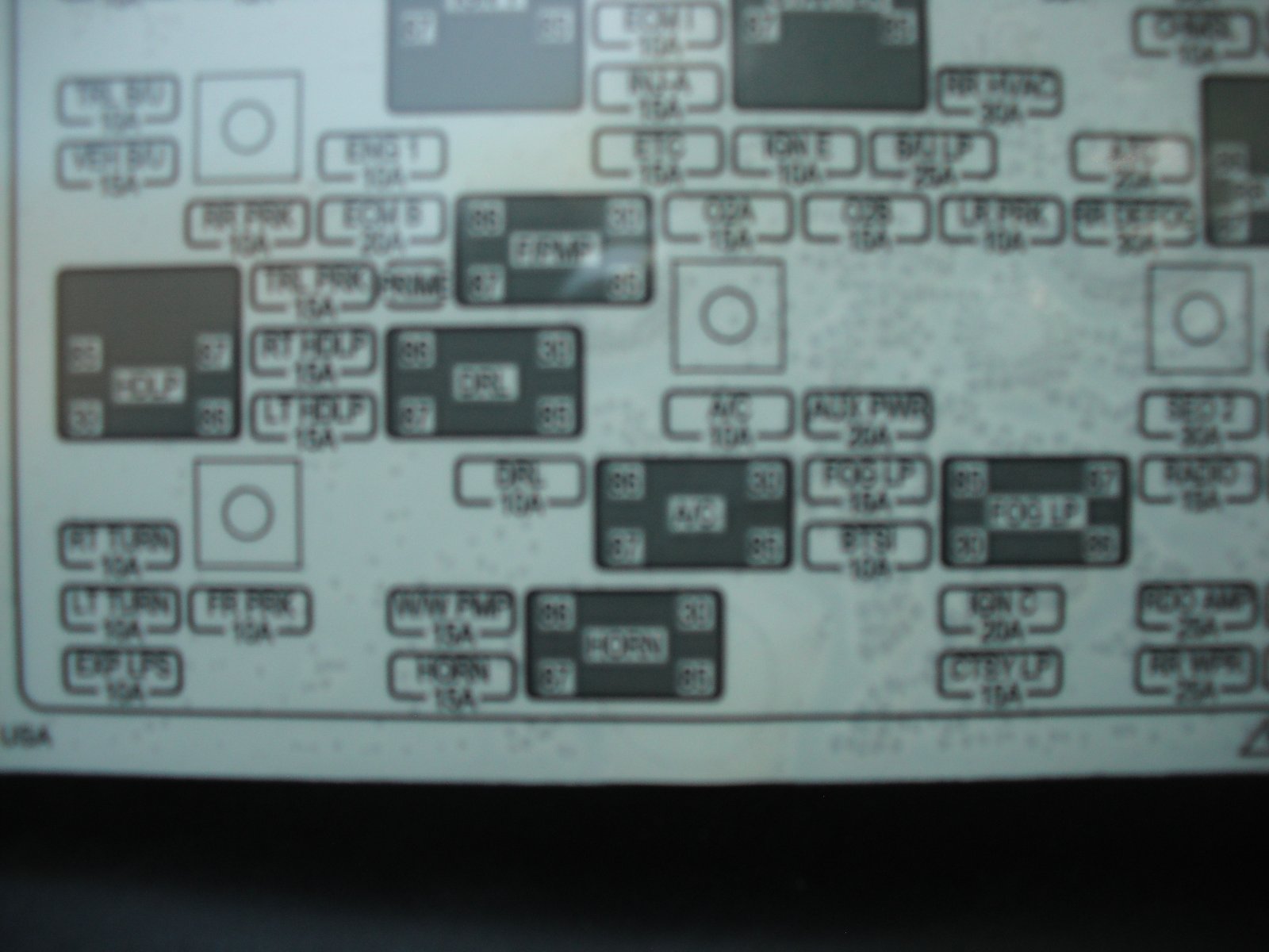

Ok the big fuse box under the hood also has a A/C Relay that is one of those big square things next to the little red 10A a/c fuse. It won't say A/C on it but follow your diagram on the back of the fuse box cover to see which one it is. That would be worth checking or replacing maybe that's your problem.
