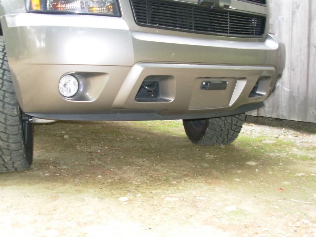

I took mine off and it leaves some plastic slots hanging down like 1/2" that the tabs from the airdam slide into to hold it on..if you ever plan on re-installing it then do not trim those mounts. I ended up taking mine and trimmed it so it was just low enough to hide the mounting slots, then I just mounted it up like factory, but gained the ground clearance that I needed.

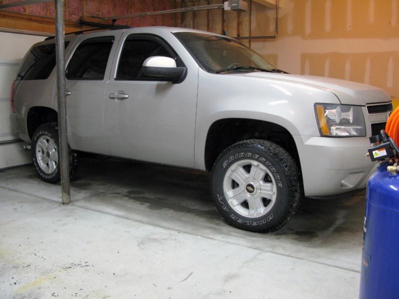

I did the same thing as InTruckDesign....The plastic slots/tabs were really ugly and unfinished looking.... It's super easy to trim as long as you have an air compressor, a cutoff wheel, and an orbital sander or even just a sanding block to clean it up afterwards...
You can kind of see the trimmed air dam in the pic I attached... InTruckDesign has a really good picture of his trimmed air dam...
