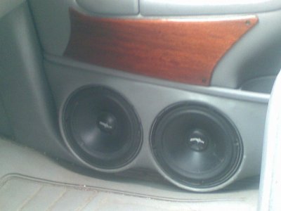

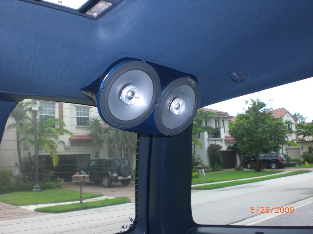

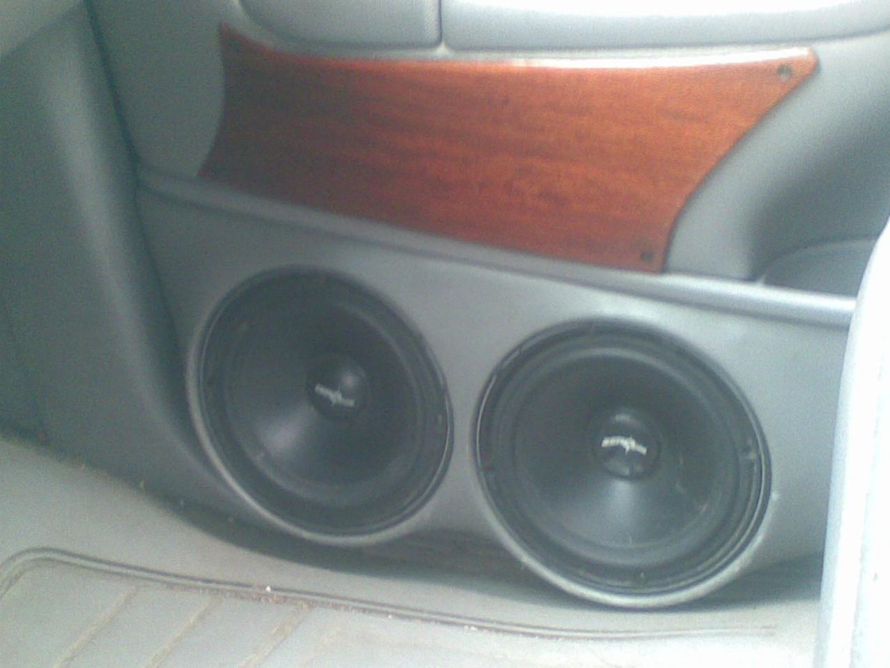

everything is relplaceable with a stock look. or you can do this..
doggworld1233
Jul 11, 2009
19
WPB,FL
i am the one who builds them... ready for paint is $120 or carpeted $65.. plus shipping from florida... these car be made for any size spaeker.. we did some for a 6x9 not to long ago.
