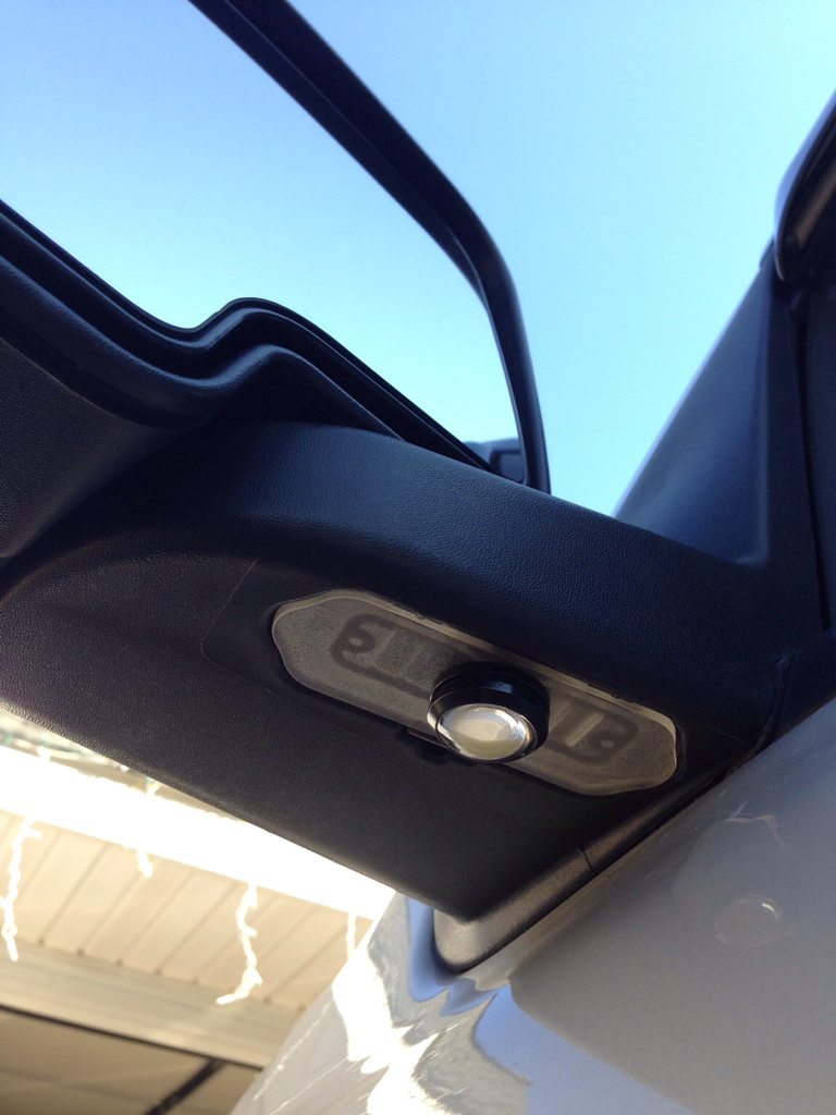

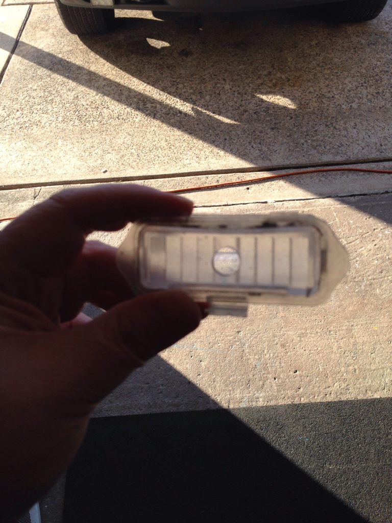

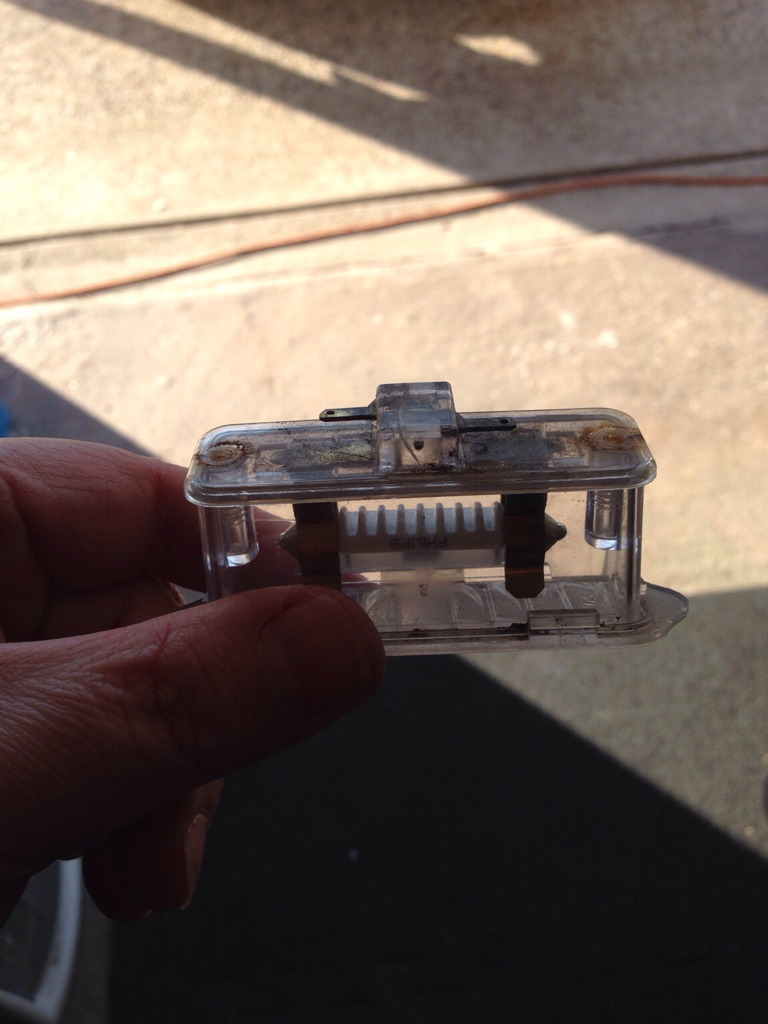

Some more work on her today... I picked up some eagle eyes led's and did my puddle lights cause they barely worked in the first place.
I did them this way for anyone that wants an easy/quick way to hook them up...
First I took them out of the mirror and took the bulbs out so it was just empty housings
Then I took a 3/8 drill bit and drilled a hole in the center of the housing
Now you would think that the opening isn't big enough for the nut but it just fits
Now just thread the eagle eye into the housing and hook up the wiring (keep in mind which wire in the mirror is positive and negative)
Then you have this roughly a half hour later...
Also note... The one housing was slanted and not straight up and down so you will have to trim some of the inside housing to make the eagle eye sit flush

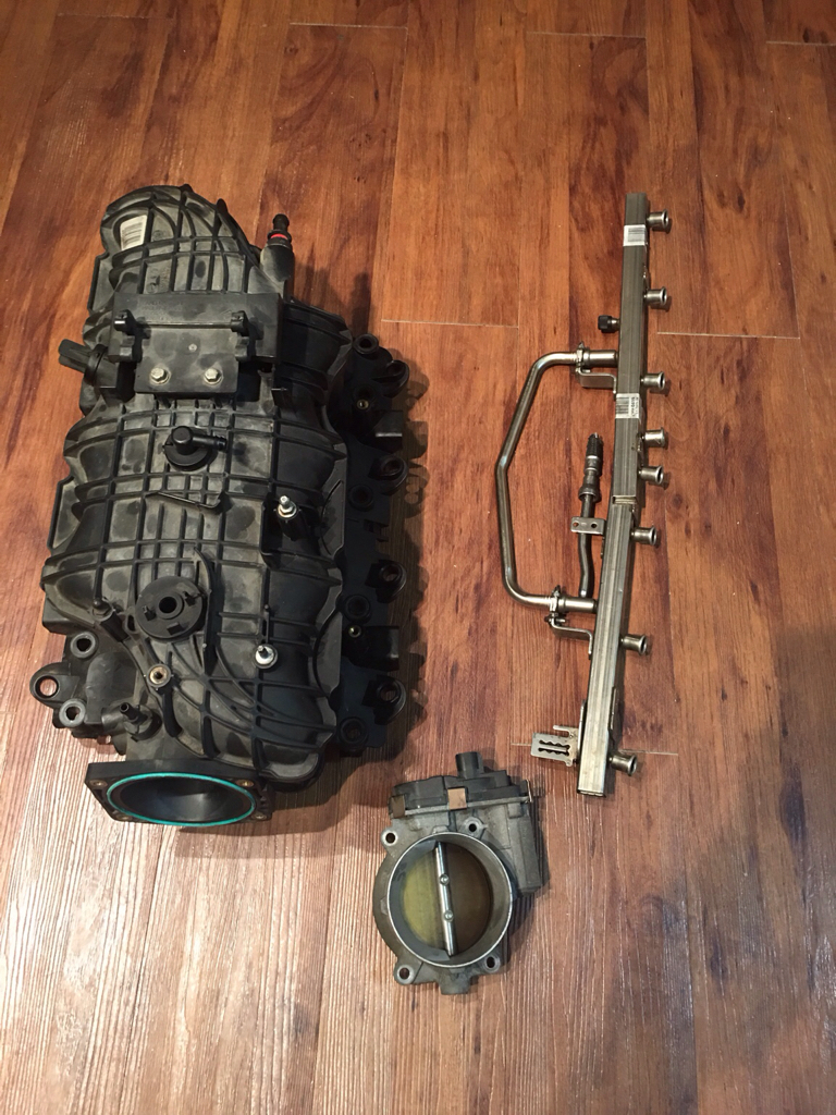

Some more goodies I found...
2008 TBSS intake, throttle body and rails. Just need my X-Link and little odds and ends and I'll be good to go

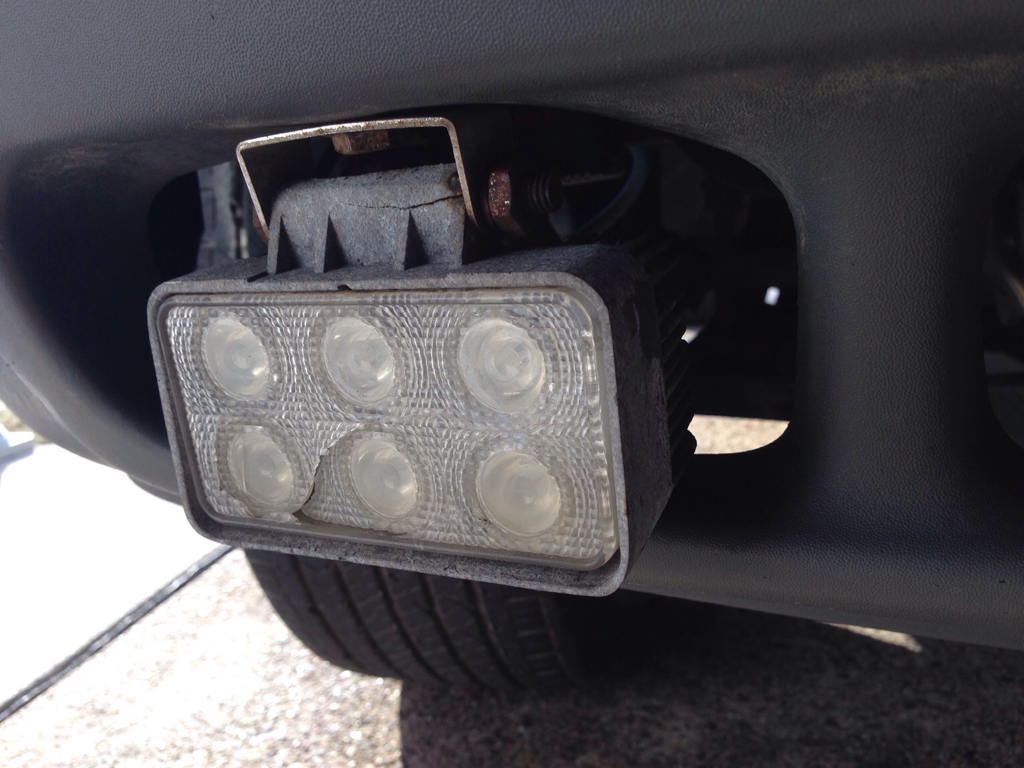

Eagle Eyes nice on the puddles. Fogs are fugly, but we all had a laugh at the start of this thread. I'm sure you'll put something in there better anyways.:thumbsup:
