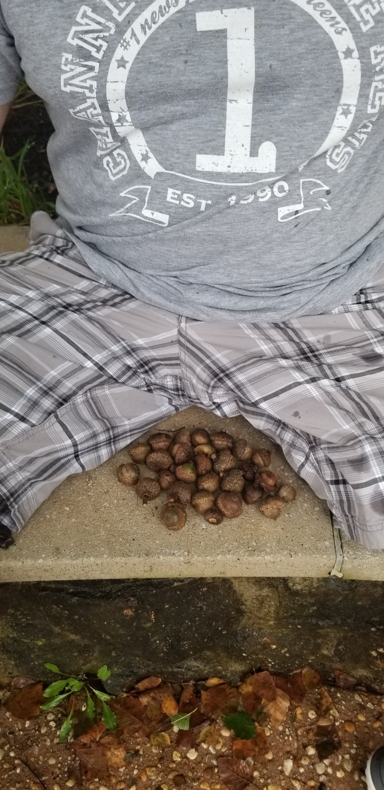

Polished and sealed my nuts.

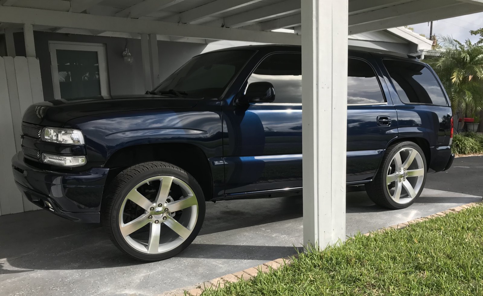

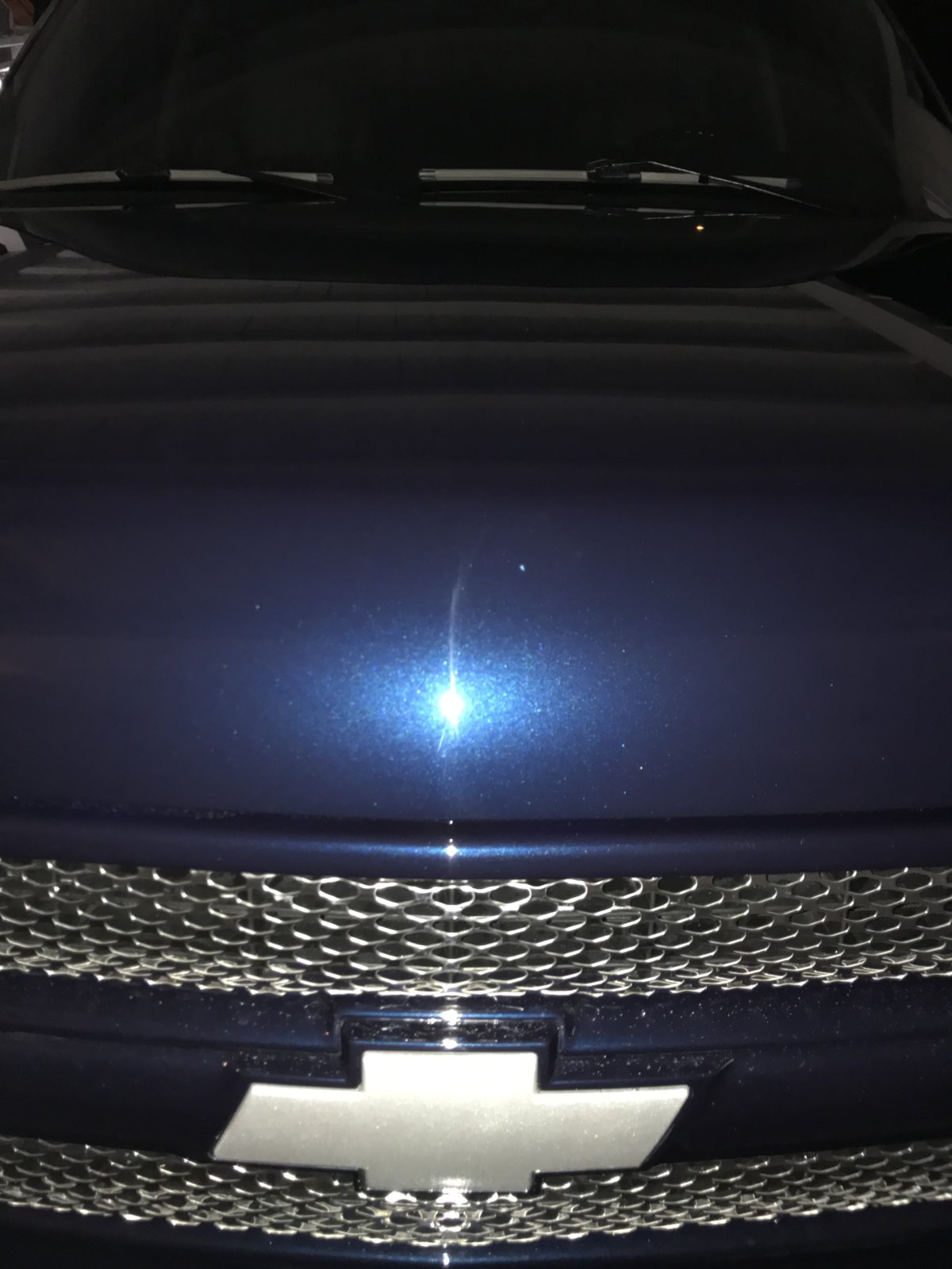

So I wasn’t very happy with the outcome of the last polish and Rejex sealant application.
The paint shined and the water beaded off, but there was just a noticeable swirly type haze to the finished product.
Not really swirl marks per se, but looked like it had not been buffed out properly. It was bugging me.

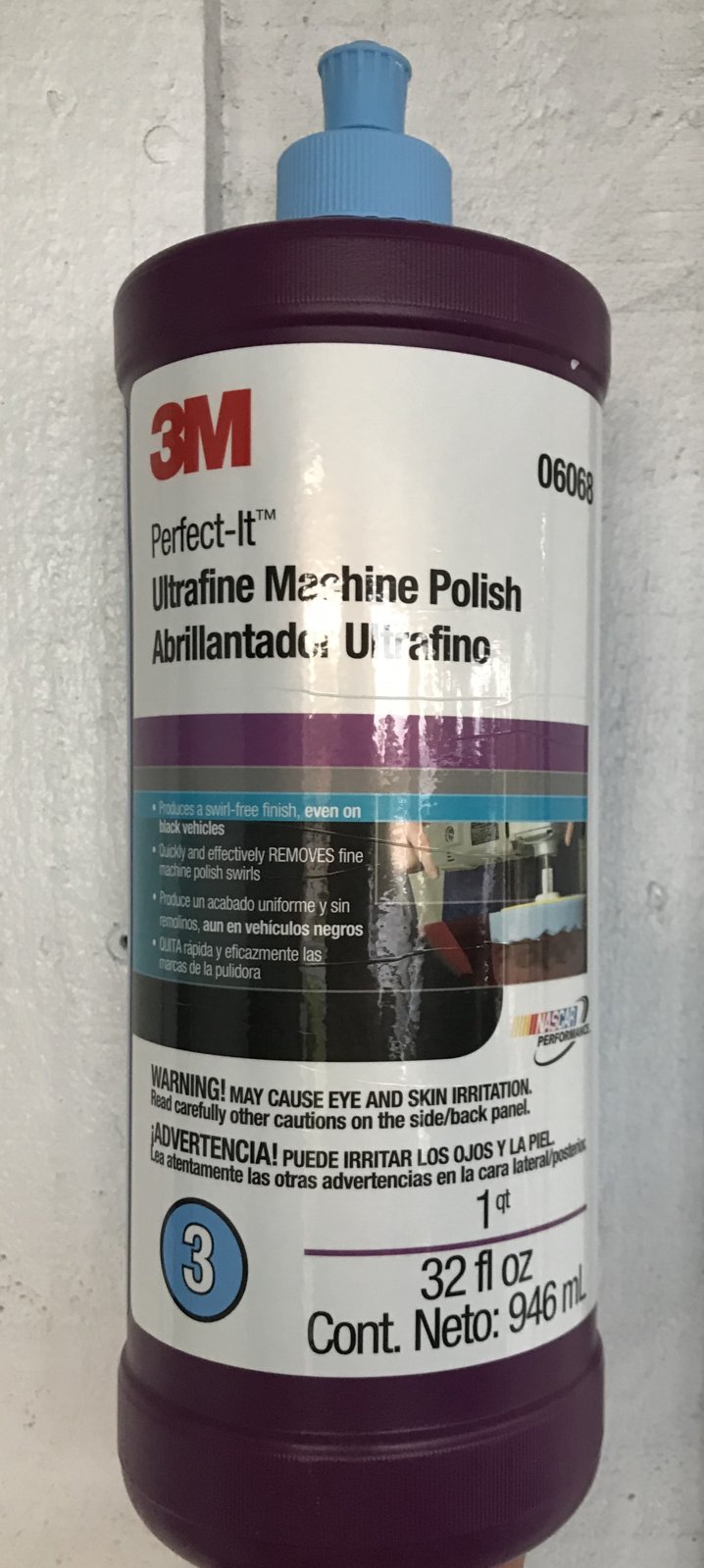

So I got the clay bar out again and removed the sealant and went back to my previous successful formula.

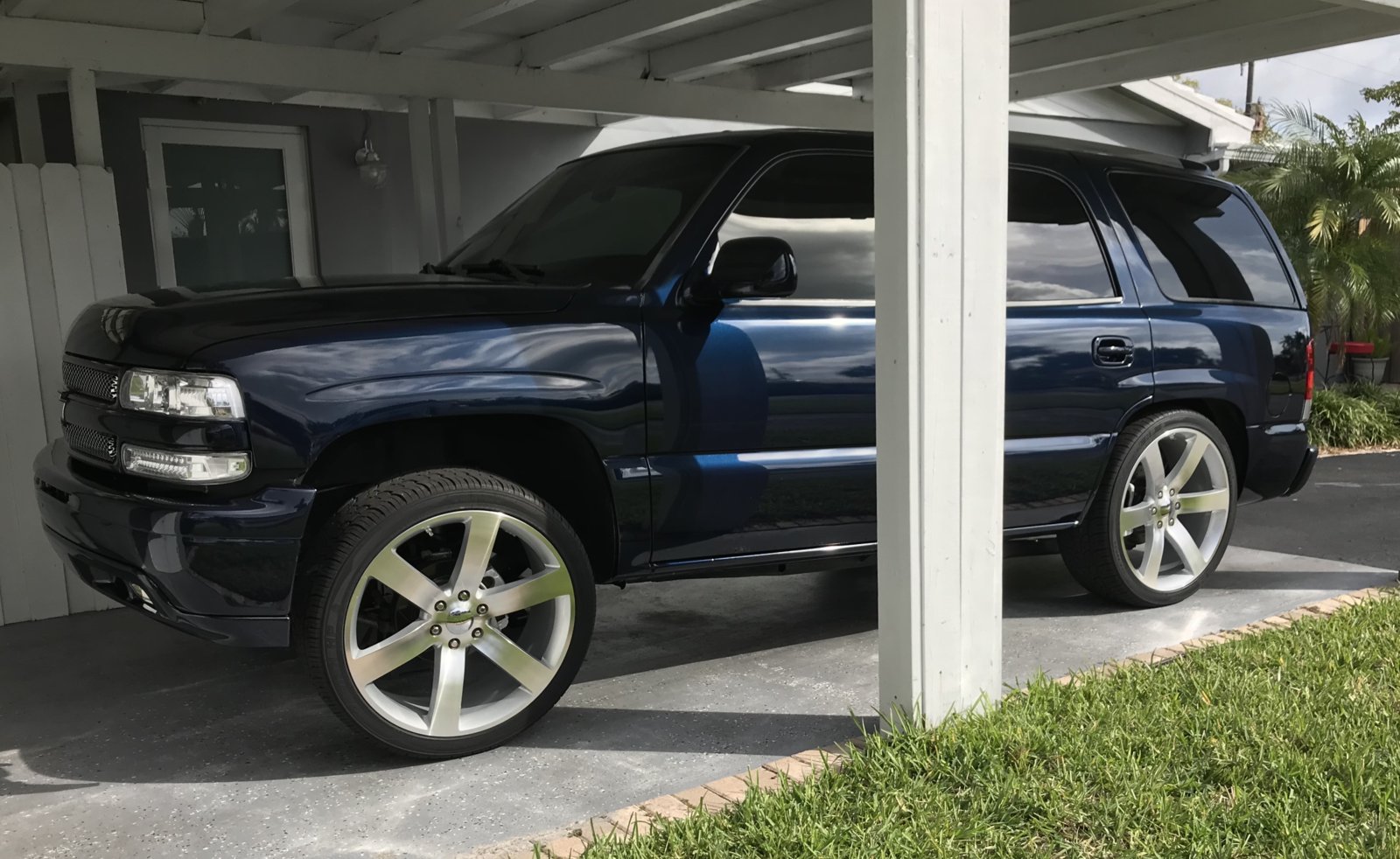

I hit the hood and all the major body panels minus the roof and bumpers.
I used a new pad, new microfibers and went back to my 3M Ultrafine Machine Polish step 3 designed for fine swirls, polishing out 2500 grit or higher and for dark paints.
Then I coated it all in Collinites 845 Insulator Wax and let it sit for 3 hours before polishing it out.
Looks wet and ready to roll.
This is the driver’s side.

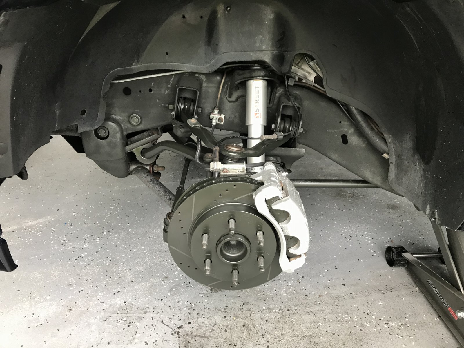

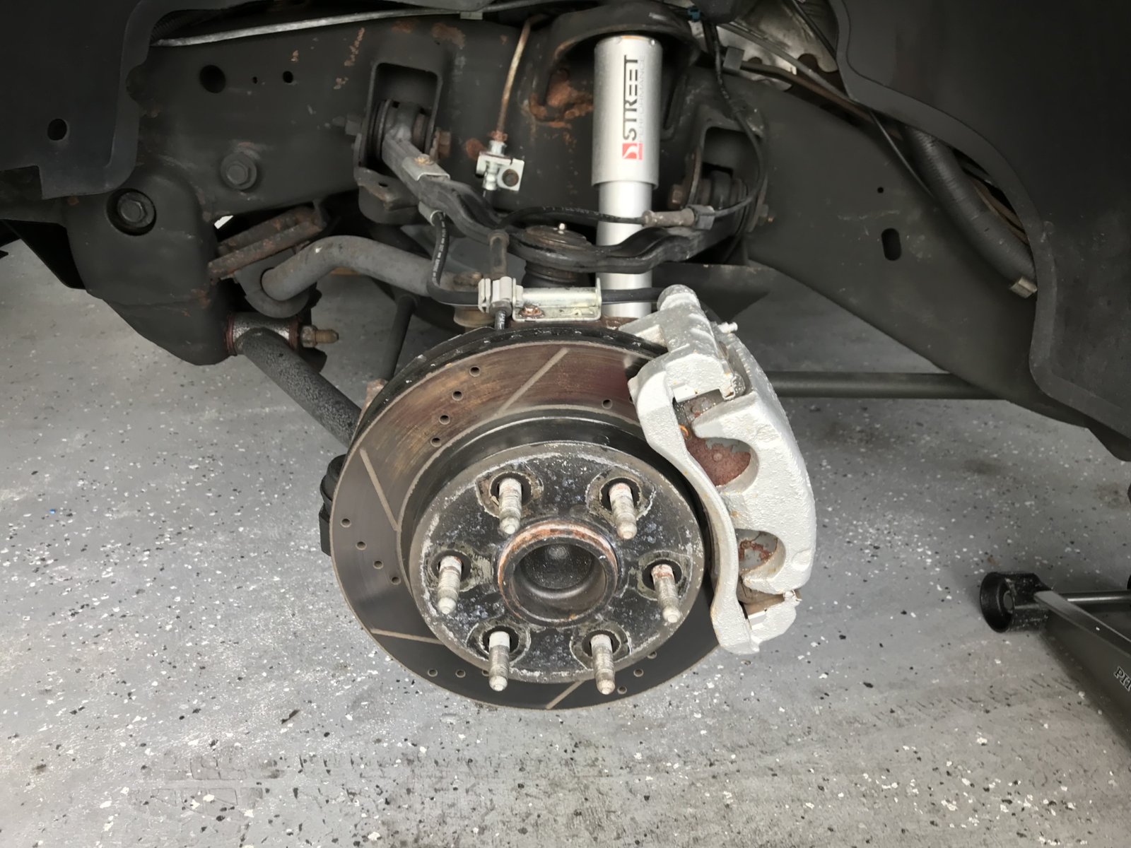

Made my way around to the front wheels today.
Painted the rotors, calipers and touched up the suspension components as well as any surface rust under there. Surprising how much of the OEM thick coating is still present on the frame and undercarriage.
Sanded back part of the passenger torsion bar as it had some flaky rusty bits that need needed to be knocked down.
Not showroom perfect under there, especially looking up under the motor, but pretty good for the age and location. Thankfully not like the salted road trucks must endure.
A purely cosmetic day and I asked myself if it was worth the hours of effort? I guess so.
I didn’t fix anything in terms of maintenance. The suspension bushings all look ok. Could probably use some new stuff, but nothing has disintegrated into dust yet.
Plenty of grease on the zerk fittings, and oozing out from the last time the shop overshot them and left it messy. I cleaned up the excess, but forgot the grease gun again. Doh!!

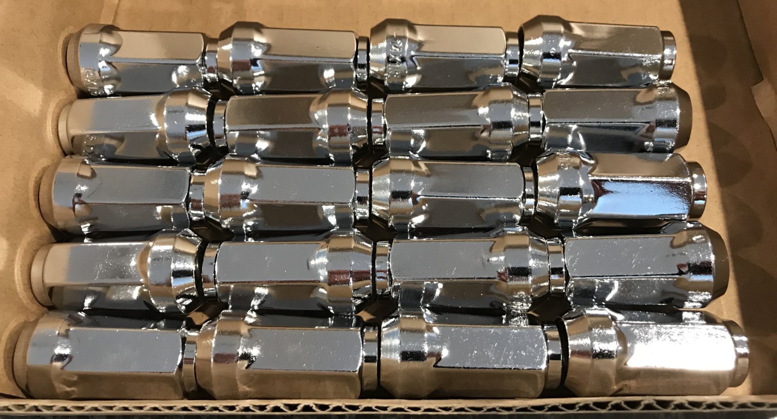

3 wheels have the new lug nuts installed, inner wheel waxed out, lug holes sealed as well as the lug nuts.
I found a few lugs on removal that were not really tight and a couple that were zipper gun tight.
Even with the 20” lug wrench, it took some muscle to break them.
I torqued all the lug nuts to 120, which seems to be in the middle of the road of what has been recommended and what is writtten. Just a bit extra tight than leaning on the lug wrench.
Or better yet, I know that all 6 are the same at this point.

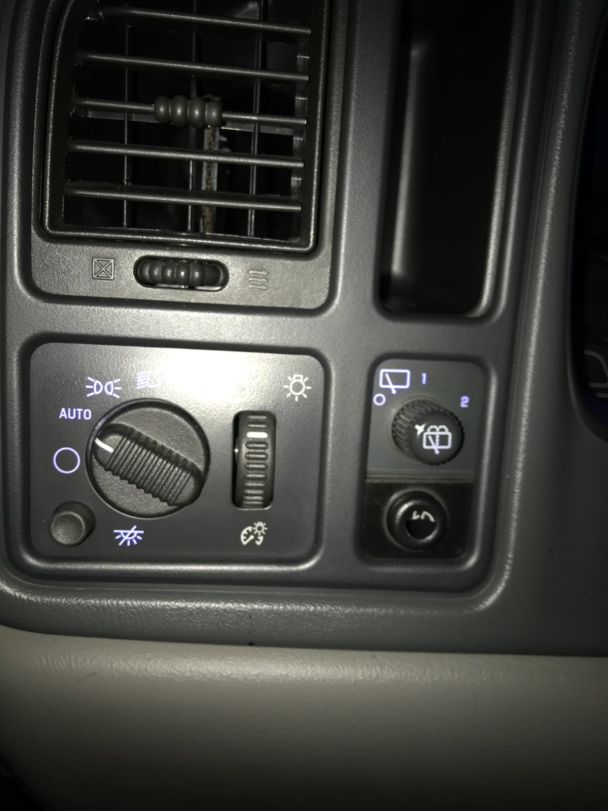

Then a quick run to the supermarket for family movie night food and a Redbox for the kids. I pushed the fog light button to test the lights.
It cracked in half and no longer lights up. The lights work but not the switch. Grrrr....
