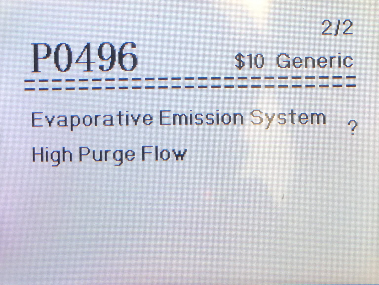

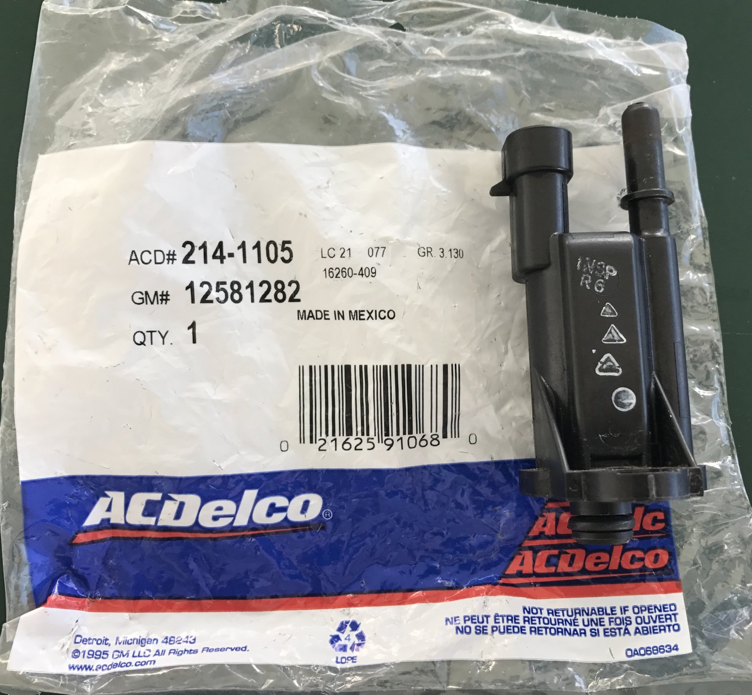

Yes we checked the gas cap first. Then we checked this part. He said sometimes it gets blocked, but you cannot blow it out.
There is another part of the system (I have not researched that far yet other than one video online) by the fuel tank that will be next on the list if the CEL comes back on.

If code 455 comes back then check the evap vent solenoid. I'm a service consultant at our local chevy dealership and our tahoe's are known for these problems.
