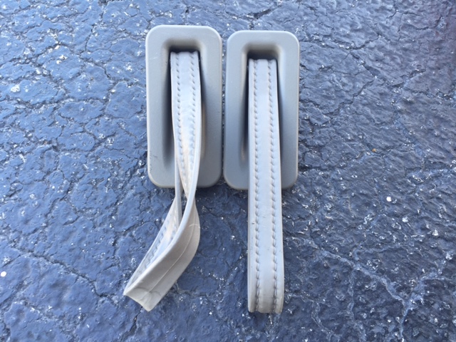

Found a few more parts at the junkyard the other day.
Changed out the rear liftgate pull handle as mine was almost cracked in half at the loop. Gave it a good clean and installed a like new part.
$7 for the handle.

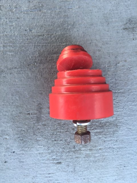

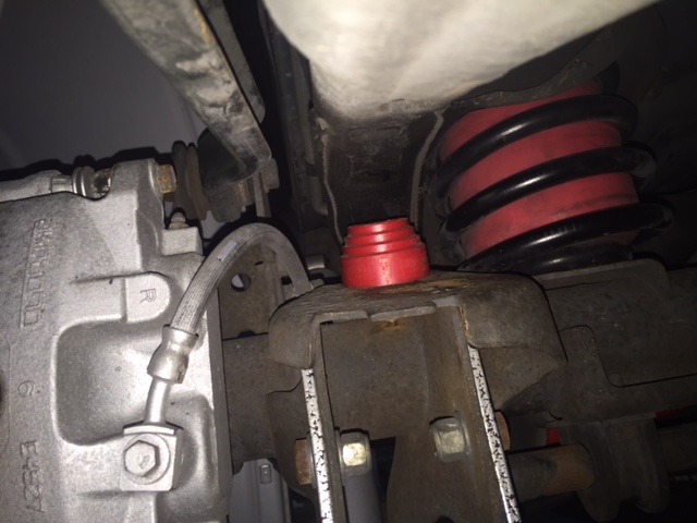

Pulled off the rear bump stops and cut off the top 3 layers, leaving about 1.5 inches from the axle pad/base of the bump stop. Have been meaning to do this to give the rear a bit more travel, but just never carved out the time. Should ride a bit better now with some gap between the bump stop and the frame.
Bump stop installed before being cut down.
Bump stop after cutting off the top 3 layers. Amazing how tough these bump stops are. They have taken some hard hits and only a transfer of paint from the frame shows up on them. No fatigue or marring was present when I removed them.
Installed after cutting off the top 3 layers.

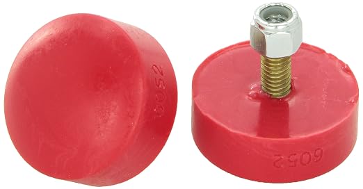

I had this shape originally, but the shop misplaced them the first go round, so the multi-layered ones were the ones I received last summer.
Put them on the axle pad as shown in the picture above. It's a little tight getting the lock washer and nut on, but a good, secure place with the extra travel especially after the free travel mod is done.

I believe there is a hole already there. I had a shop do the original installation. I removed the bump stop with the truck on the ground and it is a tight fit under there as you know. Getting the 14mm wrench and my hand in that tight spot to loosen the nut, especially on the driver's side with the gas tank took a bit longer than planned.
My setup has a lock washer and regular nut vs. a nylon nut. Good idea until I cranked down on the nut and compressed the lock washer a bit too far thus making the bolt come down closer to the axle. This would normally be a good practice to ensure a tight fit. However, I couldn't pull the wrench back out as it was stuck under the bolt from the bump stop and the axle. Literally by a thread. And you only have about 1/4 turn on the wrench to loosen or tighten the bolt and a socket will not fit.
It took a little extra channel lock work and hand turning to loosen the bump stop off of that lock washer and high enough to release the wrench. Then I just hand tightened it. At least I know the lock washer is doing its job and won't let the bump stop vibrate off. Just thought I'd share that little tidbit before you get under there and crank down on that nut and get your wrench stuck.

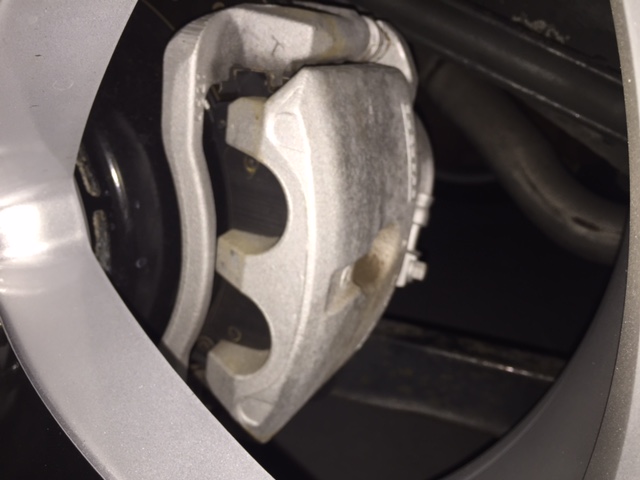

How are the painted calipers holding up? Has the heat darkened the paint? I am thinking about painting mine the same color as yours.

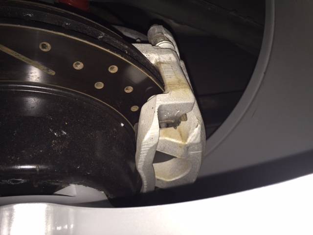

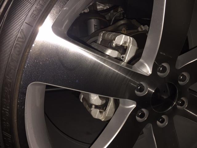

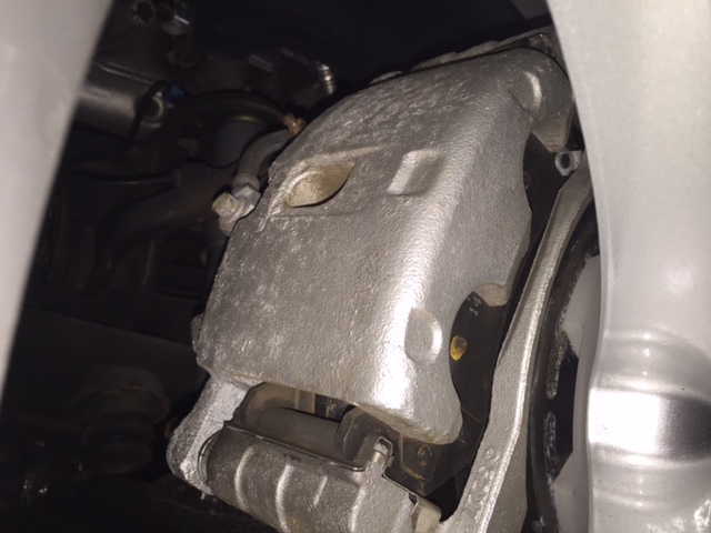

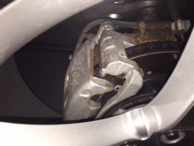

Here are a couple pics of the front and rear right hand side calipers. The calipers and rotors are both looking pretty good for 1 year later. For me, they could use a touch up, but they still look great. I still need to touch up the rest of the suspension components, but all in good time.
Front right.
Front right.
Front right.
Right rear.
Right rear.

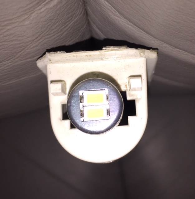

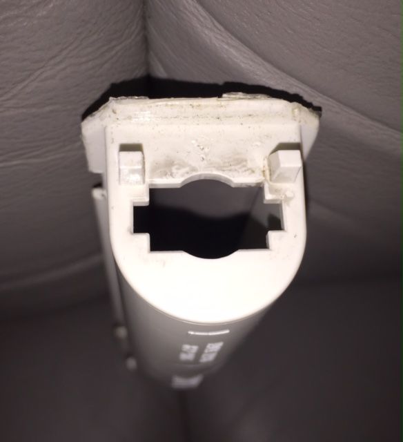

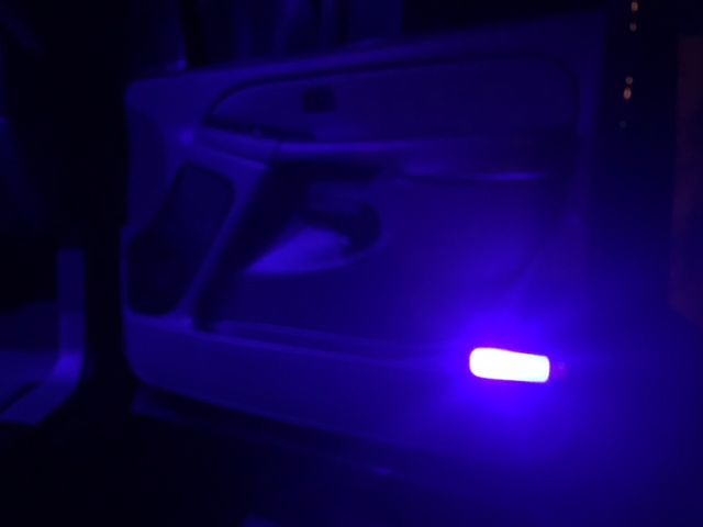

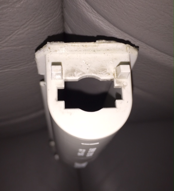

I ordered another $4.59 pack of blue LEDs to go with the set of front door courtesy lights that I found for $11 at the junkyard last week.
I had originally pried open the white and red courtesy light lense when I first installed the white T10/194 base LED into the plug and superglued them back together. Somewhere along the line, the passenger side red reflector went missing and the driver side LED had popped out of the socket and was just rattling around inside the sealed light. Grrr... (Online prices ranged from $10-$30 for one light, so it was worth waiting for the junkyard to find the pair for cheap.)
The light faces were not quite new looking, so I used some 3M Perfect-It Rubbing Compound, Step 1 and finished it off with some 3M Perfect-It Machine Polish, Step 2 to bring back the gloss. Still not a brand new part, but for such small piece that only I will look at, it is good enough. This time with 2 sealed units, I decided not to crack the lenses open. I used a pencil wrapped with some sticky 80 grit sandpaper and gently wallowed out the round part of the hole to accommodate the head of the LED light.
I plugged in the light, pushed it through the hole, snapped the clip in place to the light and slid it back into the door opening. Done. A small, but long awaited victory fixing those little courtesy lights. The little things.
Before wallowing out the hole. I forgot to take a pic of the slightly modified hole,
but both of the rounded parts of the cut out are just a little bigger to fit the LED light head.
Showing the LED head size relative to the opening in the courtesy light housing. Looks bigger
in this picture, but in reality there is only a little bit of sanding needed to make it fit.
The black clip slides into place and "clicks" in on either square side.

You can use a Uni-bit drill bit to open up the socket of those lenses so the larger head of the led bulb will fit in. I have done this to my last 6 trucks this way and have yet to have any issues. No need to remove the lenses to put bulb in and glue back together.
Fosscore
Fosscore
Apr 16, 2014
10,888
19,868
Yessir. That would have been much easier, however wanting to get them installed and not having a large enough bit handy at the time meant manual sandpaper and pencil labor.
