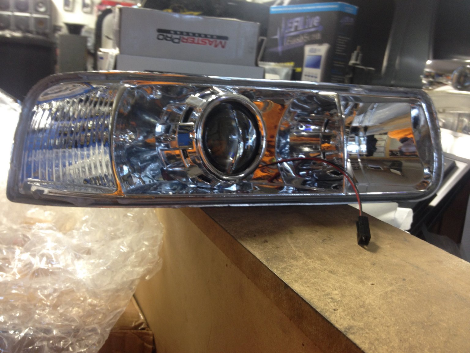

View attachment 57147 This is the headlight pretty much finished just gotta clean up the lens on the outside & drill a hole to pull the cord threw for the projector high beam & then they'll go on on. As you saw in the last one I'm out here in alsaka lol I myself I'm from Boston MA though I'm in the army so this is my duty station lol. Not bad here though not much colder than home & less snow
Is that projector a kit ? I like that look:waytogo:
Isaiah Thompson
Oct 20, 2015
It's kind of a kit I guess lol. It's a Denali retro fit. The projector has a little arm that blocks a small portion of the headlight so when you hit your highs you have instant more light while your waiting for your hids to warm up. That piece is what you could call a kit. It's made for a Denali headlight though & we are basically taking it &I putting it in the depo projector headlights for the Tahoe. Also have it wired up so all my lights stay on with the highs. Lows,highs,fogs & running lights. It's dark here in Alaska & I'm not about to put a big light bar on my roof or bumper lol.

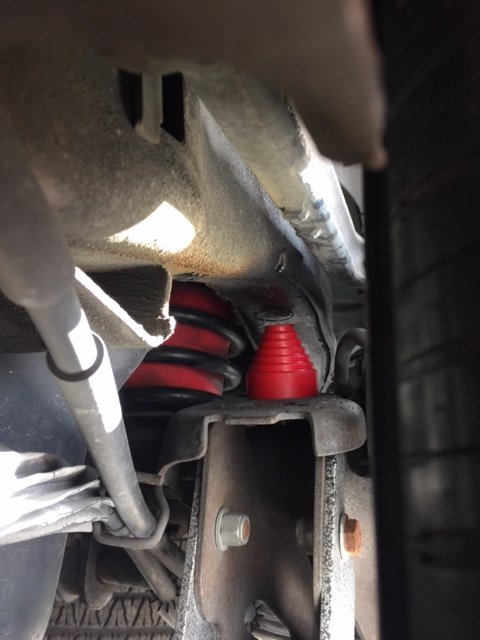

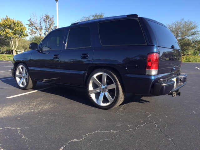

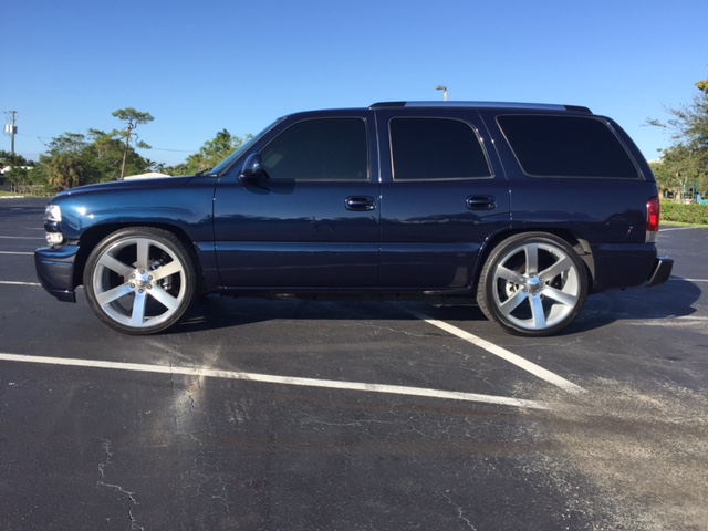

So I decided to drop the Tahoe down a little more last week as I wanted to tighten up the fender gap and have her sit closer to the 24s. I took the Tahoe back to the shop that originally installed the 3/5 drop and let them loose on the suspension to do the following:
1. Free travel mod
2. Remove rear coil spacer
3. Install new red bump stops on the axle pad
4. Crank down on the keys
5. Alignment
After everything was completed, I went to pick up the truck, but noticed that she was sitting a bit ass heavy as soon as I drove up. I pulled the tape measure out and sure enough, with the bags aired out, she was up in the front by about 1 - 1.5 inches. We measured ground to fender lip, discussed the bags and climbed under to check the keys again. Plenty of room to get another 1-2 turns to bring her down in the front, air out the bags and close up that fender gap.
The tech did not realize that the bags were aired out and had not turned the keys down far enough. Out of time for the day and no appointments until the following week, I drove her home, aired up the bags and leveled her out at 34 inches. Not low enough.
I took her back today to have the the tech turn down the keys about 1 1/4 turns, air out the bags and put her back on the rack to be aligned. (They did not charge me for labor or the second alignment since they did not address the keys enough the first visit). That's taking care of your repeat customer. Thanks to California Custom Sport Trucks for your work.

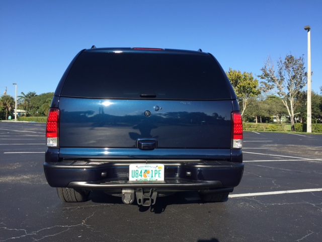

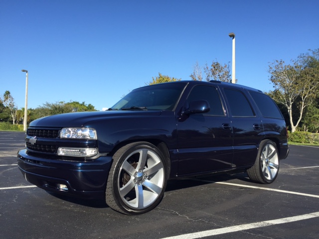

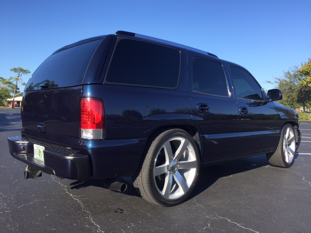

The front is now sitting about 32.75 inches and the rear about 33 inches. The fender gap is minimal and I am super stoked with how she is sitting now. Gotten quite a few compliments. The truck hugs the road a lot better and without that big sway and dive like the OEM set up used to be.
Thanks to Tony @NORCAL SS for answering a lot of questions and hooking me with suspension kit and TBSS wheels. Hope you guys like the stance and outcome.

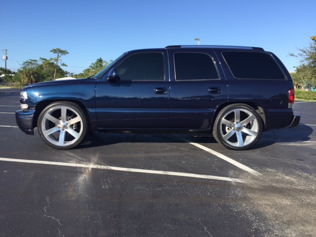

Here's a look at the setup after the free travel mod and with the new bump stops installed on the axle pads.

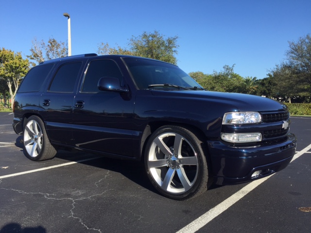

The finished product and lower stance.

Looks damn good, but that sure doesn't leave much room for axle travel.
Is that considered a 3/6 kit??
Yes it is. I used Tony's NorcalSS 3/5-6 kit.
http://tbssowners.com/store/index.php?act=viewProd&productId=88
So far the ride around town has been good. Firm and tight. Need a few more runs to see if I need to cut anything off of the new bump stop. You can see by doing the free travel mod, it gets you a bit further down in the rear. There are a few different levels on that bump stop that I can cut it down if/when I need to.

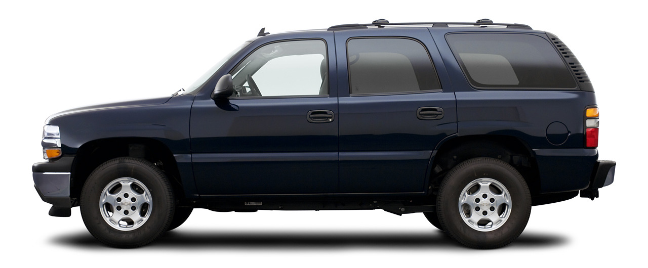

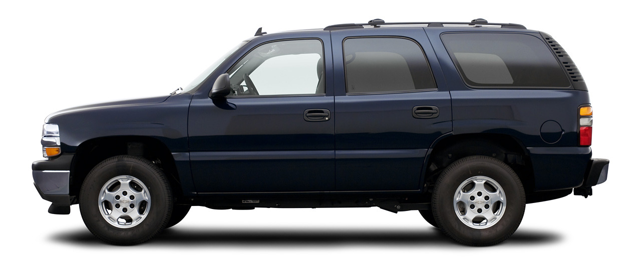

Bone stock 2006 Tahoe LS. How I started driving her in February 2009.
How she sits now in November 2015.
#1taho
5150TAHO
Dec 10, 2013
1,814
1,175
niagara falls ont
I liked the stock look. Why did you change it ? LMFAO
The look you went for or have achieved is awsome. If my beater grows on me maybe I will lower it and put nice rims on it. But for now it's just the winter beater.
