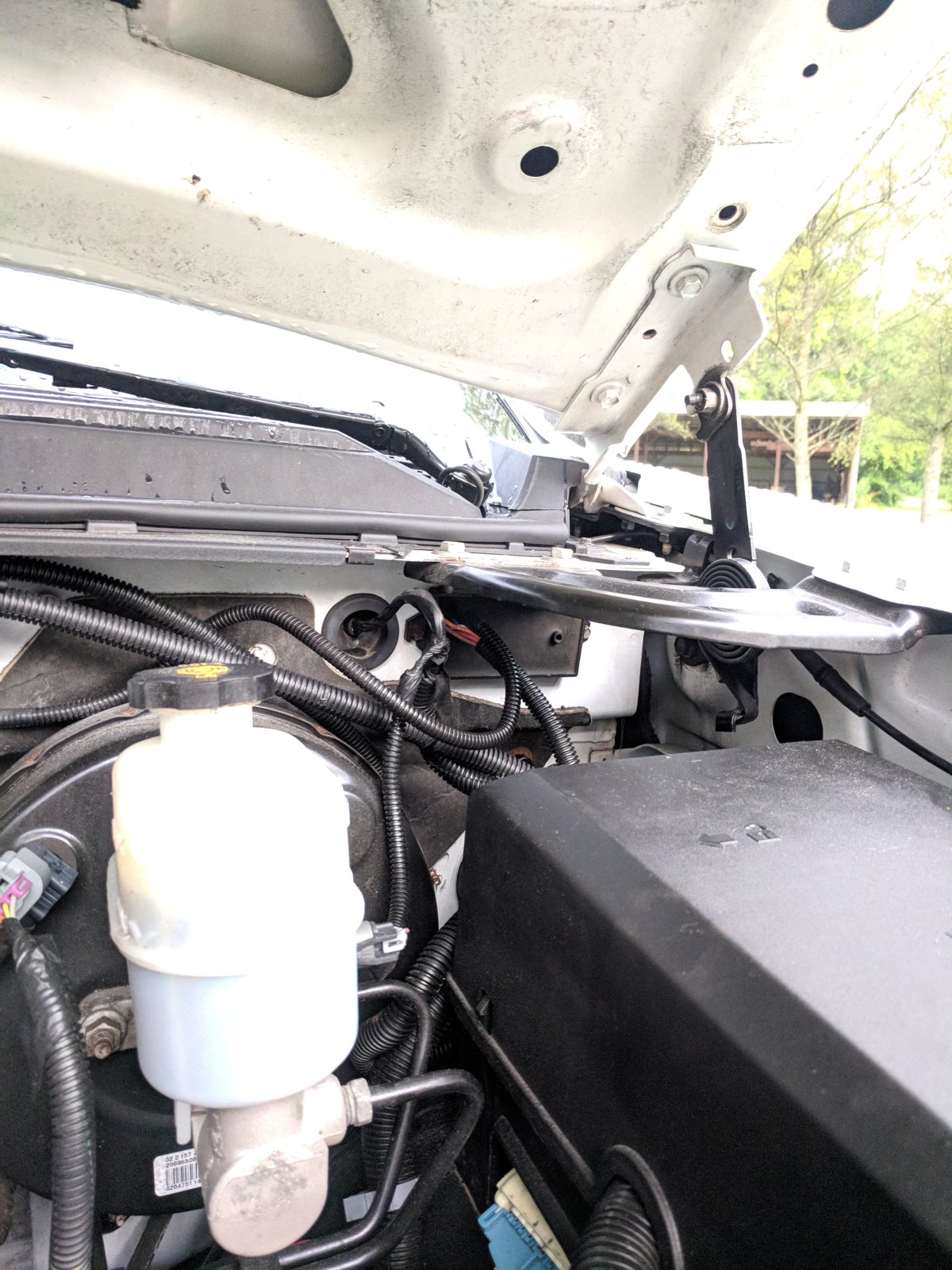

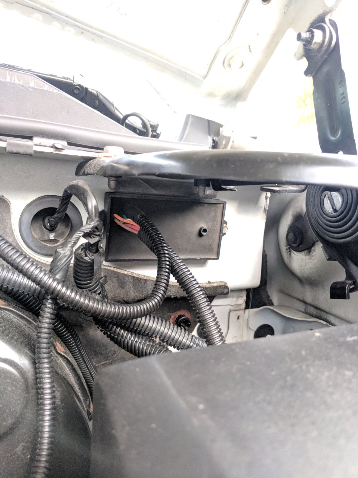

My question stems from when I was pulling the remaining police wiring back through the firewall. There seems to be two factory wires that were cut and spliced into the police wiring. The wires originate at a module of some kind, about the size of a sponge, northeast of the brake booster. There are about 5-6 wires that terminate at the module. Does anyone happen to know what it is/what its function is? (Yes I did search first and didn't find anything. See attached pics)

not sure I think it may be some kind of control module for lights, someone else on here probably knows, does it have a part number anywhere?

I looked at mine and I don't have that terminal block. If I had to guess maybe it is a factory brake controller.
As Wes indicated in the post above It might be a flasher module, but they are located in the right front bumper/fender wheel well area.
Follow the wires!
Oh and yea I forgot to say WELCOME Morgan!

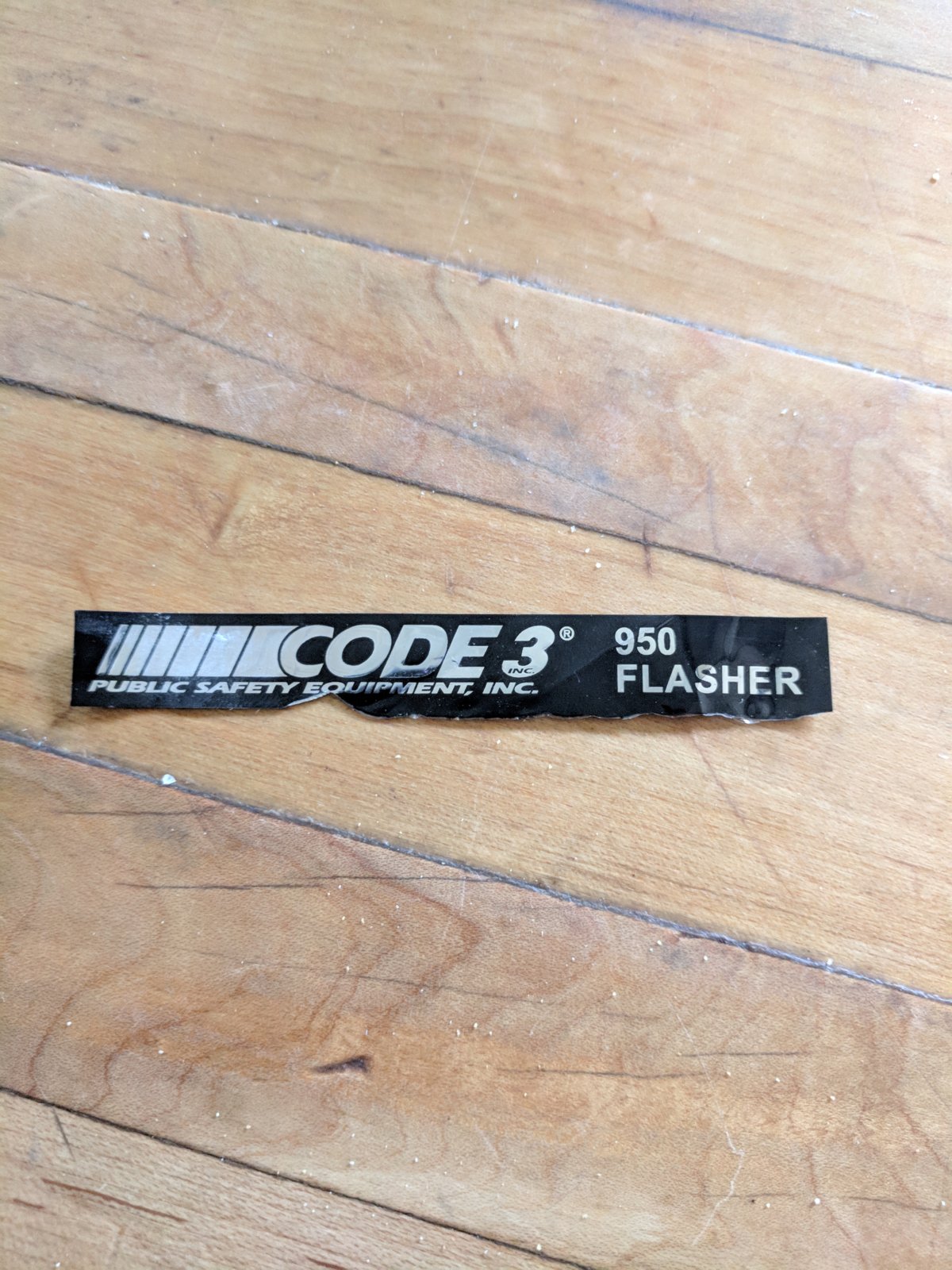

So, upon further investigation it looks like its just a flasher. I felt around the module feeling for a embossed part number when I noticed a manufactures sticker that had peeled up and was sitting flat on the firewall, with the words inward. I tore it off and this is what I got:
Feel kinda dumb now but it looked factory. Also, the Tahoe is a SSV not PPV. Not completely used to the terms yet.

I would just follow the wires on that module.
