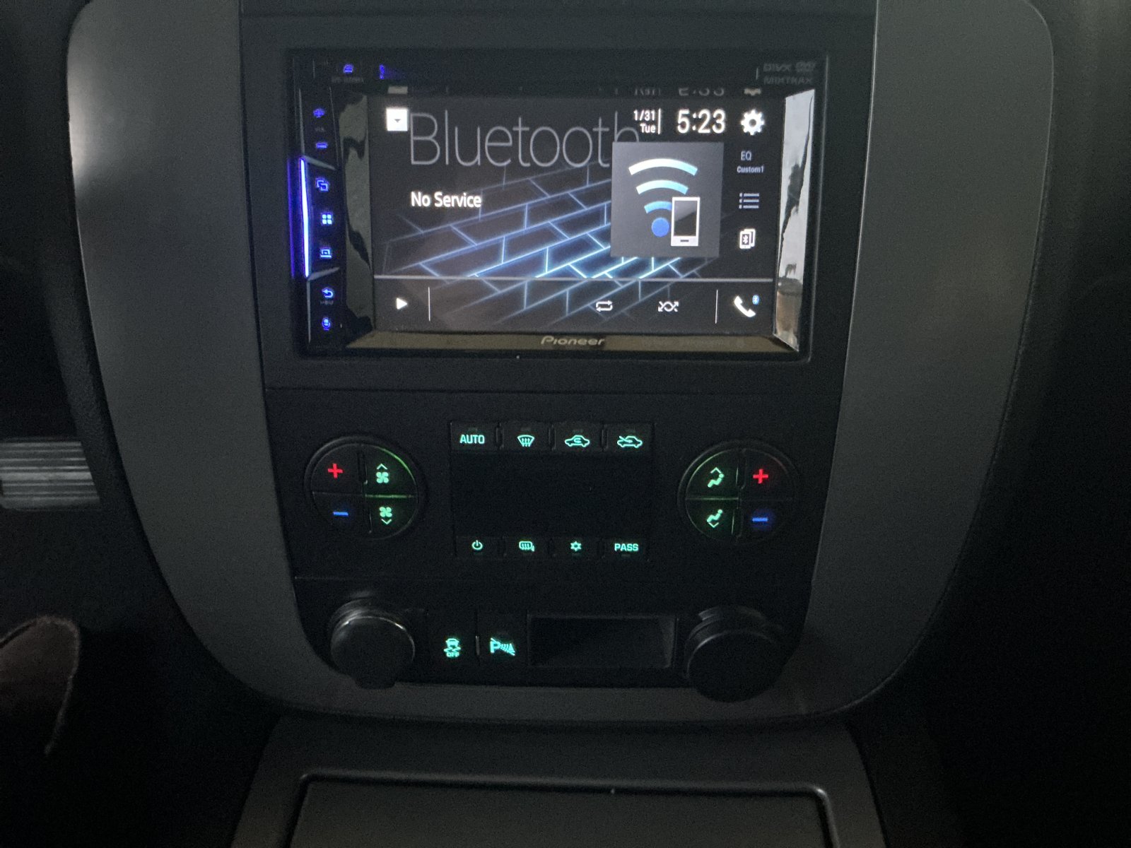

Did you scrape the old labels off or just put the new over the damaged ones?
Big Mama
Jul 21, 2015
3,639
2,295
Virginia
I put the stickers over it. At night it doesn’t look great but it wasn’t a big deal to me.
20,307
27,872
If there is a lot of wear on the original buttons, you can scrape them clean so the blemish doesn't bleed through at night.
Mine weren't so bad, we put the stickers right on top and they've been on almost 8 years now.
27,754
42,179
my preference was to replace the control, didn't like the look of the stickers, a new one does have to be programmed (or should be programmed) for proper operation
in my case it made the rear only make heat if it was set to 90, put it on 89 and it would go cold, programming fixed it.
