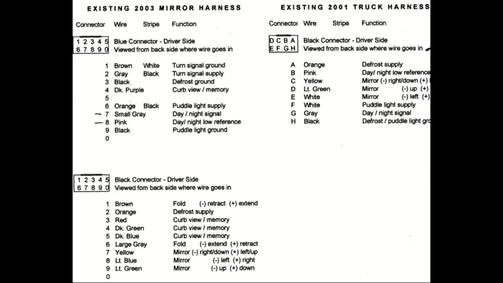

I swapped mine out for 03+ power fold and used the escalade power fold button. If you go that route let me know I could send you the diagram for the wires. Great mod to do on 00-02 non power fold. Btw you can find the Escalade power fold button on eBay for around $30, that's where I got mine.
I would love to get a hold of that diagram if you wouldn't mind passing it along my way when you get a free moment! Would love to do that to my 02 denali someday soon!

Here you go, this is what I went off of to wire the 2 03+ harness plugs to 00-02 harness. What I did was just splice into each harness just incase I decided to go back to stock all plugs are still there.
