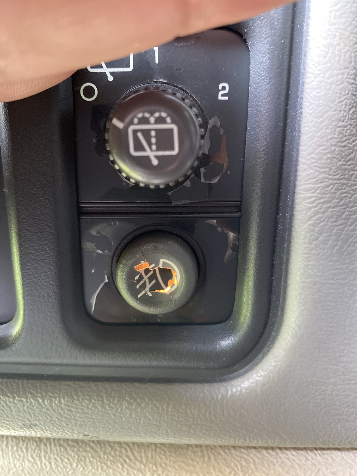

can't tell if that is lit up or not, when the plastic wears off it will show up as that blonde/natural color plastic underneath.
you stated that you replaced the switch already, does not appear to be the case based on your photo.
per your initial post.....
"I need help in why my fog light isn’t turning on in my 02 Yukon. I replaced the fuse, the relay and the switch"
