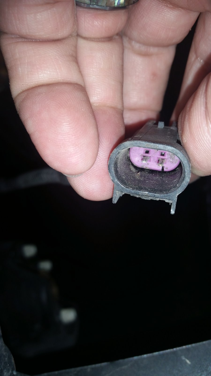

I need your help. When I joined the forum I mentioned that I had a issue with hooking up my fog lights.
I got under there and snapped some pics. I found some connectors on Ebay that are for the correct bulb number on our fog lights (non Z71). But the pics will show what I have. Am I missing a part of the harness or is my connectors for something else. I tested and they have power when the fog light switch is on.

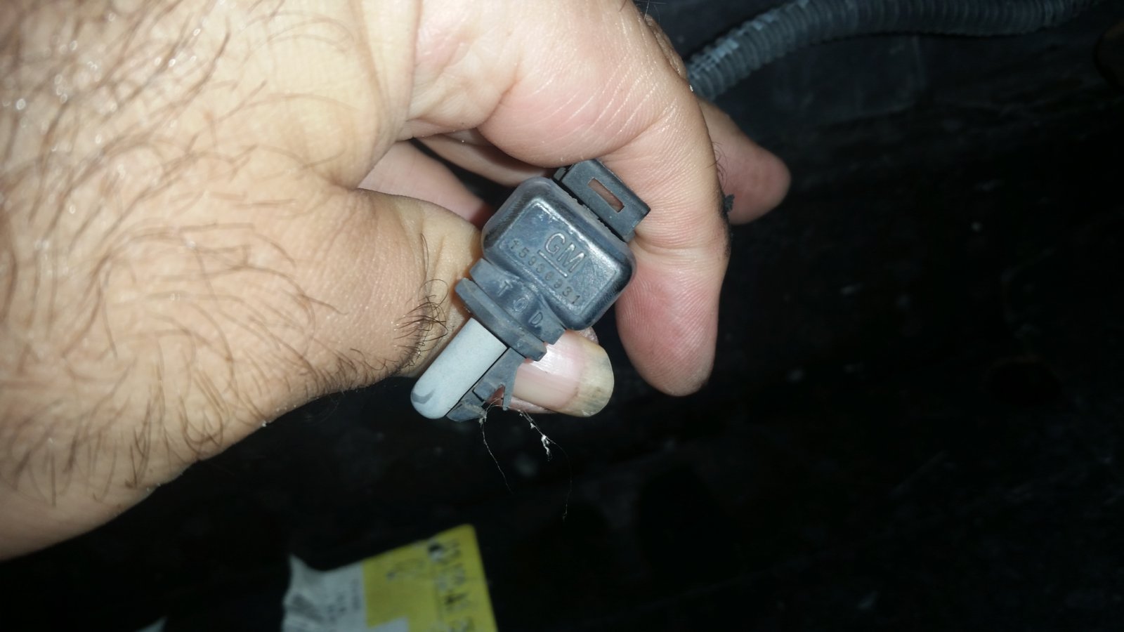

Also while I was under there, I have another object just hanging freely around the middle of the front bumper. I wonder if anyone can tell me what this Gem is. EDIT. I found out this is the ambient temp sensor. Obvioulsly some tabs are broken off. Does anyone know where it is supposed to attact underneath?

Did you get this worked out? The connector in your hand (for Z75) is not for the plug below which appears to be for RPOs X88 or Z88 (GMC). The number for the plug that would fit those 5202 bulbs is 15489797.

I found the appropriate plugs and spliced them in. Shortly after I did that, I found out that the plug in the pic above plugged into another "pigtail" that plugged into the fog lights. I guess someone before me took the harness off when the bumper was replaced. In the future since the fog lights are just about useless other than looks, I plan on adding a light bar behind the grill and using the factory wires to power that from the dash switch.
