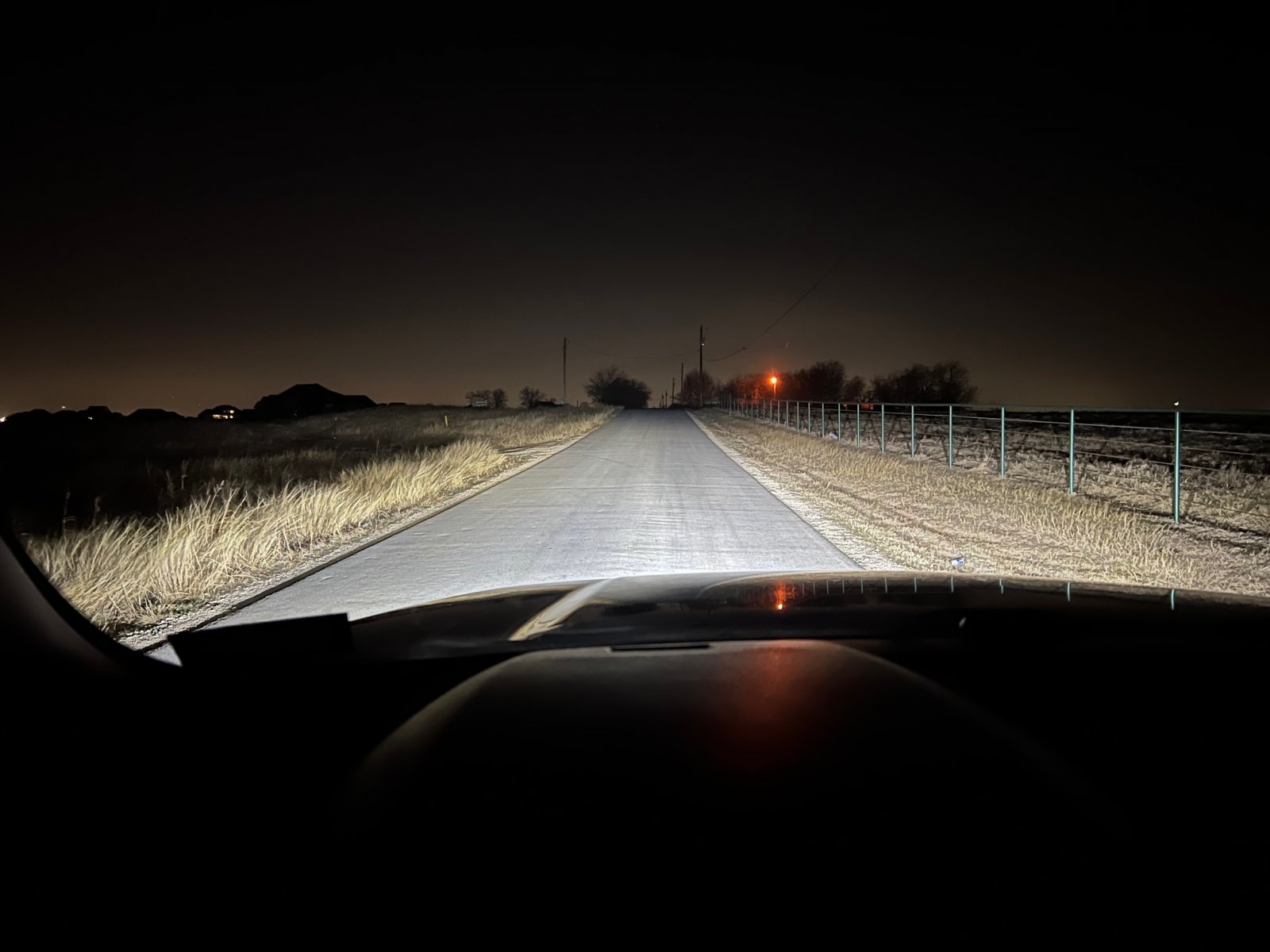

Update to close this episode.
Kudos to TRS for excellent service and warranty fulfillment. As I mentioned above, FedEx lost the original warranty replacement shipment. We both filed complaint with FedEx, but of course they denied. Whe FedEx was "investigating" the issue, TRS sent another pair, this time via UPS and they arrived safe and sound in three days.
Finally got around to installing them last weekend and all systems are a go. At least for now. Drove around and hour or so both on Sunday and last night and no more flickering, so I guess I just got bulbs from a bad batch or something.
With the Gen5DIY fog light retrofit harness (fogs on all the time with low beams) and Morimotos also in the fogs, that thing sure will be seen and you can see much better than before. LOL! I'm happy and pretty sure my wife is too now that she can see.

Is this picture just your lows and fogs?
If so, this output looks great! I would even say better than my OEM HID's in my '15 Yukon Denali XL even with OSRAM CBI bulbs.
I've been looking into a retrofit or at minimum a projector swap/upgrade to my OEM headlights. The output is terrible...
