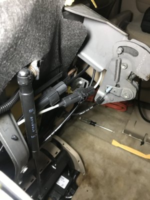

With seat base stuck down, I had little to no access to inspect and clean as suggested in some other threads. I did manually cycle the release on the back of the seat base about 50 times, and this resulted in the inside latch releasing. Outside latch remained stuck, so I removed the plastic trim as much as I could. A couple of machine screws (torx) and a plastics push rivet gizmo. Otherwise, the trim pieces latch together. Of course, with a 12 year old vehicle, the plastic brace attachment “posts” from the trim pieces which were secured to the metal seat base broke in the process. No big issue.
Once access gained, I worked the release again and again. All cables connected and looked good as far as I could see.

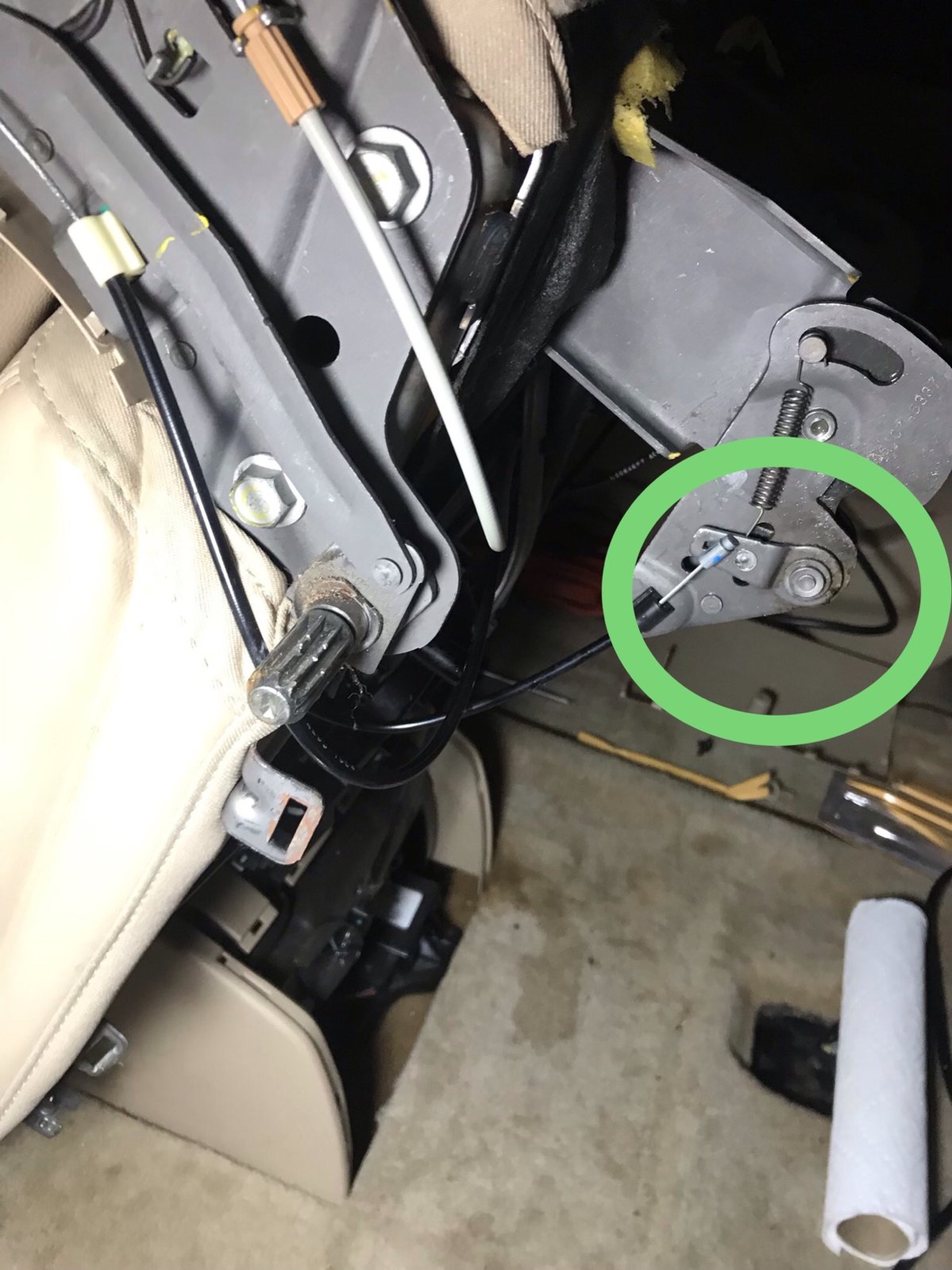

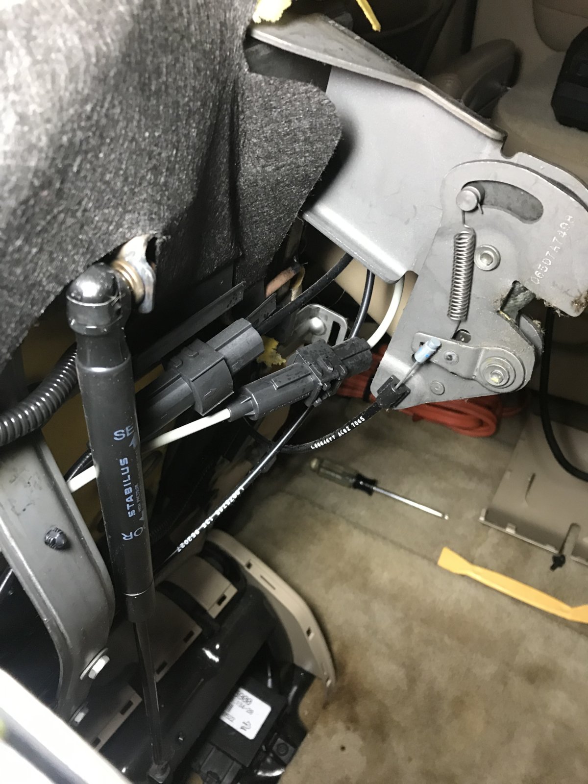

In pics I will be attaching, the lever bracket circled was the problem. Either from lack of use or spilled drinks from previous owner, it was stuck.
I fixed stuck with a hammer and WD 40. Tapped the metal level (circled in green in pic) back and forth a few times and it freed up and started moving easily as it should. Cleaned it up and put some lithium grease on it.
FYI if the lever stays stuck in the other direction towards the front of the seat, the seat back can not be lifted upward to the original position.
Now works without issue. I’ve just got to put it all back together tomorrow.

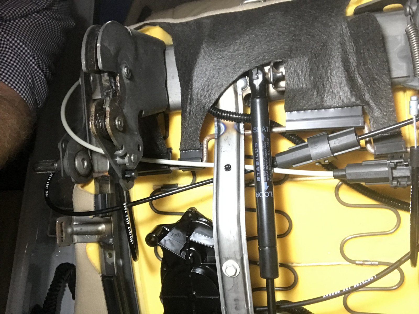

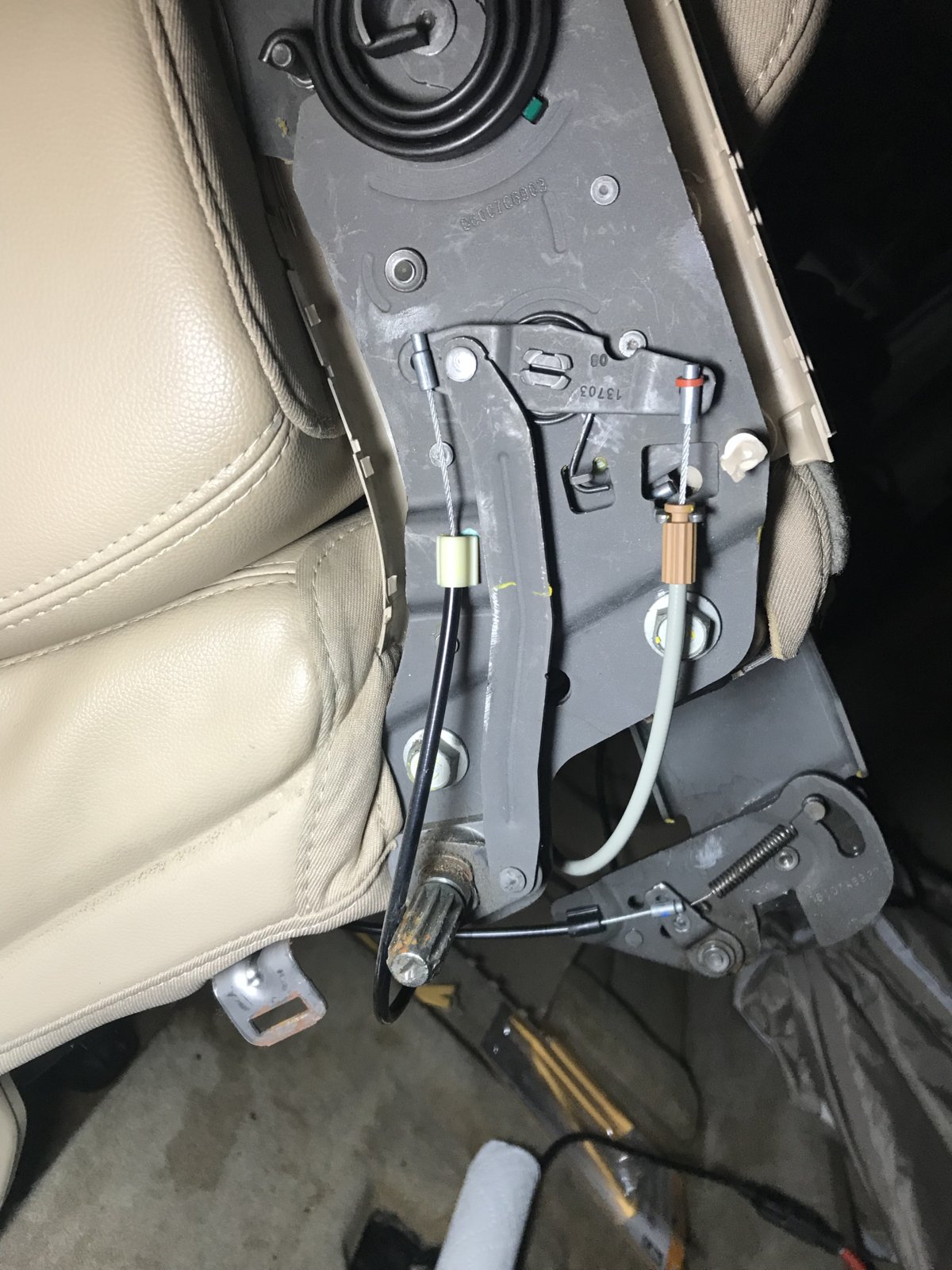

Attaching a few extra pics for reference. There is another one of these levers on the inner latch as well. They, and the plats-tic lever on the side of the seat, all attach via cables.
