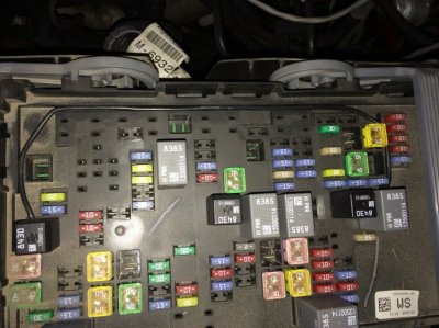

I wired my fog lights like the photo below and they work perfectly. They come on with the headlights and stay on with the high beams. I've not had a problem and this is the second vehicle I've done this with. I just used a single piece of wire with no diode. The photo is the fuse box from my D-Max but it works exactly the same way with my 2014 Suburban.
