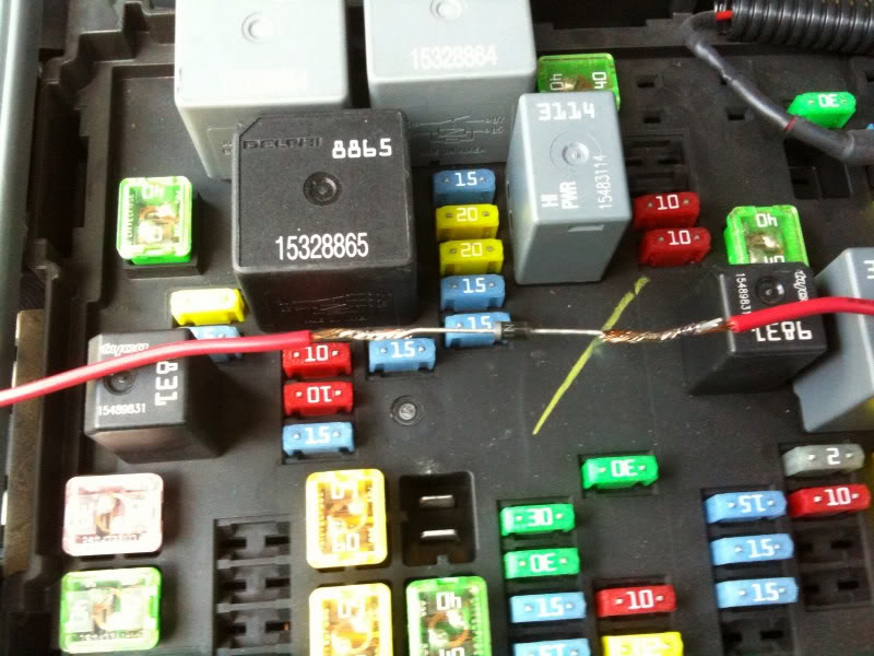

Or...if you wanna do it like the pro's...you can do the following
take 4 inches of 16-18 gauge wire
cut it in half so you have (2) 2 inch pieces
solder each piece of wire to each end of the diode
now you have wire-diode-wire...all connected to form one long piece
now cover entire piece with heat shrink...and bam! it looks factory! :)

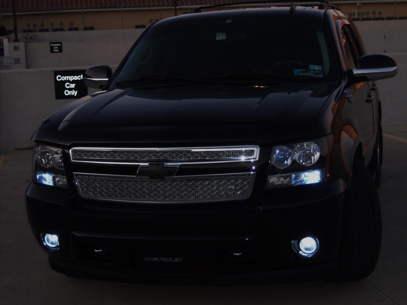

LED's look cool I may go with those, how bright are they?
This bright, even brighter in person but not too much like HIDs, plus they don't get hot at all.

Exactly what I did and works like a charm. If you want to get carried away, access the underside of the fuse panel and wire in to the harness. Either way works perfectly.

I remember someone mentioning in InTruckDesign's thread it heated up the wire/diode rather quickly...any issues like that for you guys?
Damn I love the way your Hoe looks. Good job. :Handshake:
LED's sound perfect for fogs because I don't want them to be just as bright as my HID headlights.
Did you also use LED's for those parking lights? Is that even legal? Lol :D
Yep, i remember something about that too. What's the verdict, gents?

I haven't had any problems. I've had it setup this way for some time and have also drove through the night for 5 hours straight with no issues of any kind.
Thanks man. :cheers:
And yes they are 3157 LED parking lamps that kind of look a bluish/white, in Texas turn signals that are white/amber are legal so I'm good to go.

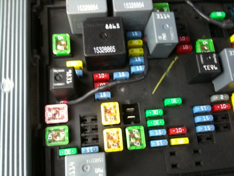

I learned this because I had it plugged in and went to move the wire with the headlights/fogs on and burned myself, freaking hurt, I've been running it for a few days and no issues so far, I changed how I ran it in the pic because since it was so hot I didn't tuck the wire, it's rigid enough from the heat shrink that I left it sticking up

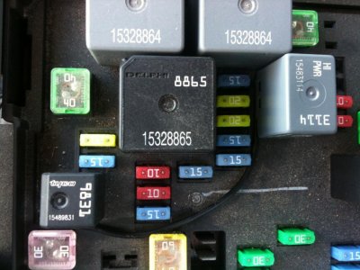

Well i did mine today, however when i used the 1N4004 resistor it worked fine but as soon as i would turn the high beams on it would get hot and start to smoke now i let it do it for about 8 minuntes and then eventually is would just burn through the diode and fogs would turn off. so what i did was just ran a 16 guage wire from relay to relay and every thing works fine no heat issue at all the only down fall is what another member said earlier if i want just the parking lights and fog lights on i cant do that it makes the low beams come on as well. no big deal IMO if i really want the fog lights on only i can just pop the hood and pull the wire out temporarly.

Is just using the wire safe? Any consequences? Also, does this work for 01-06? i have an 01. thanks guys! good write up!
my buddy just traded a 04 hoe and he jumped his wire to keep the fogs on with highs but not sure how he did it. is it safe what i did i believe so. now i am no electrician so b carefull but it runs between two relays so that is a part protecion plus the high beams and fogs are fused. but the way i did it i could turn all the lights on and hold the wire and it was still cold after 5 or 6 minutes
