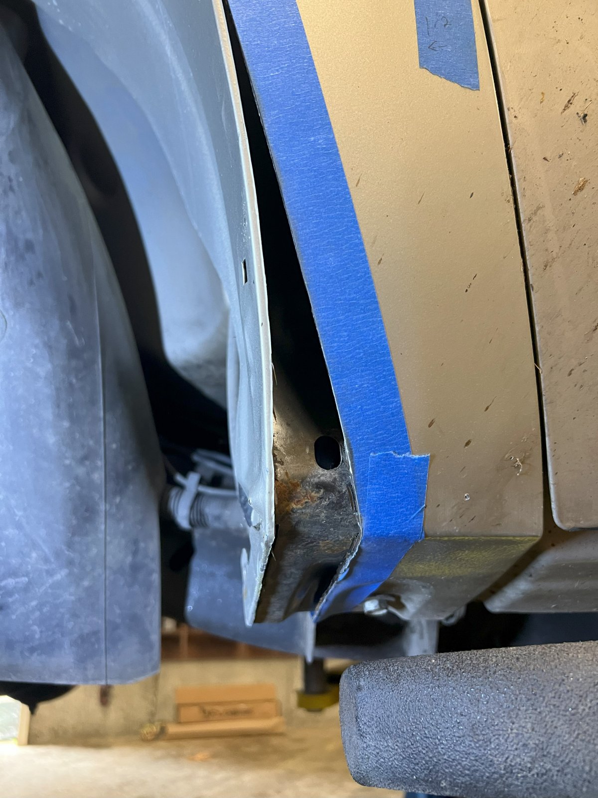

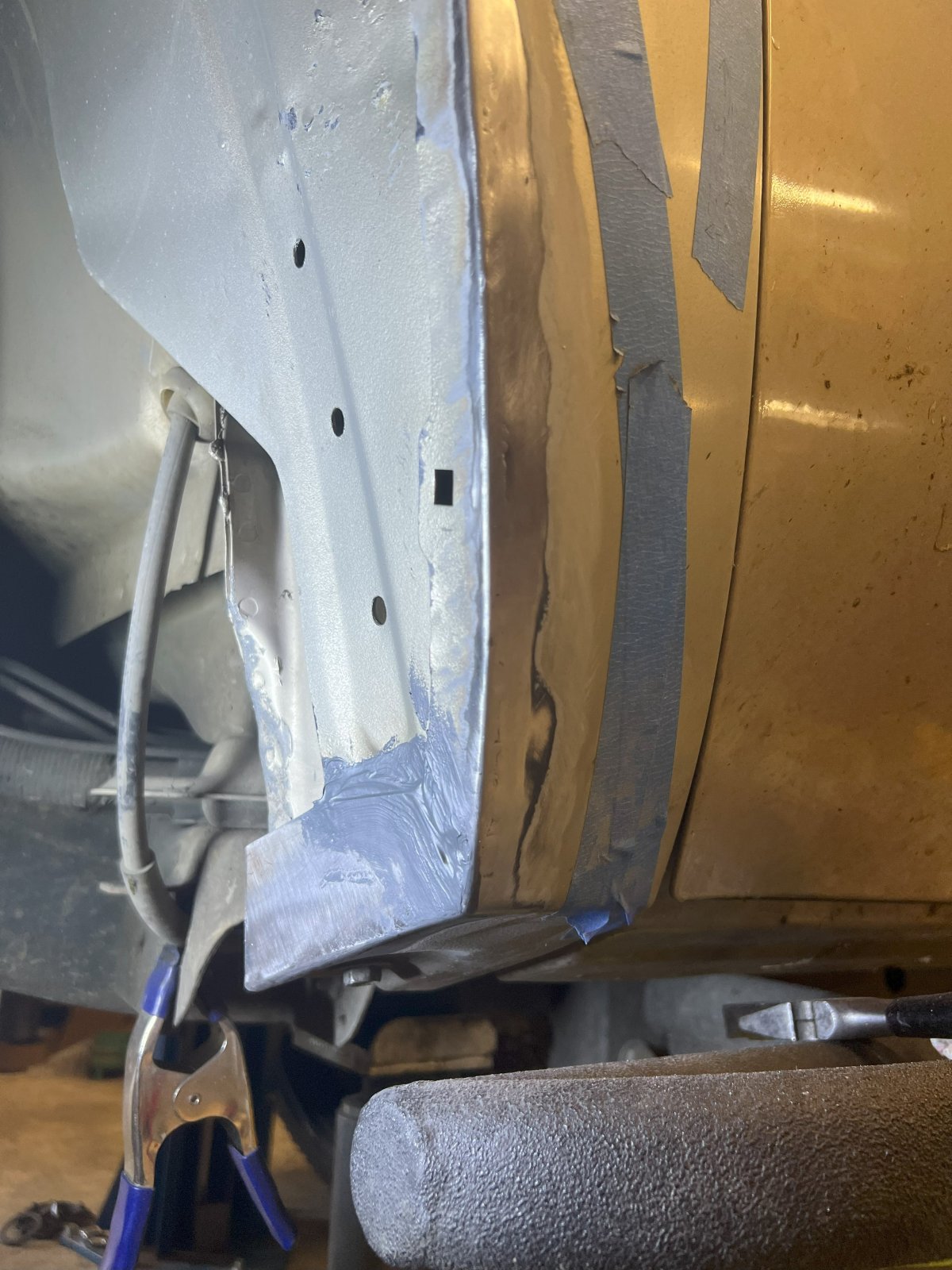

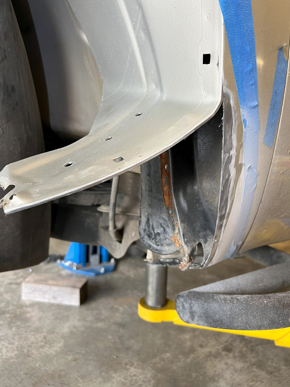

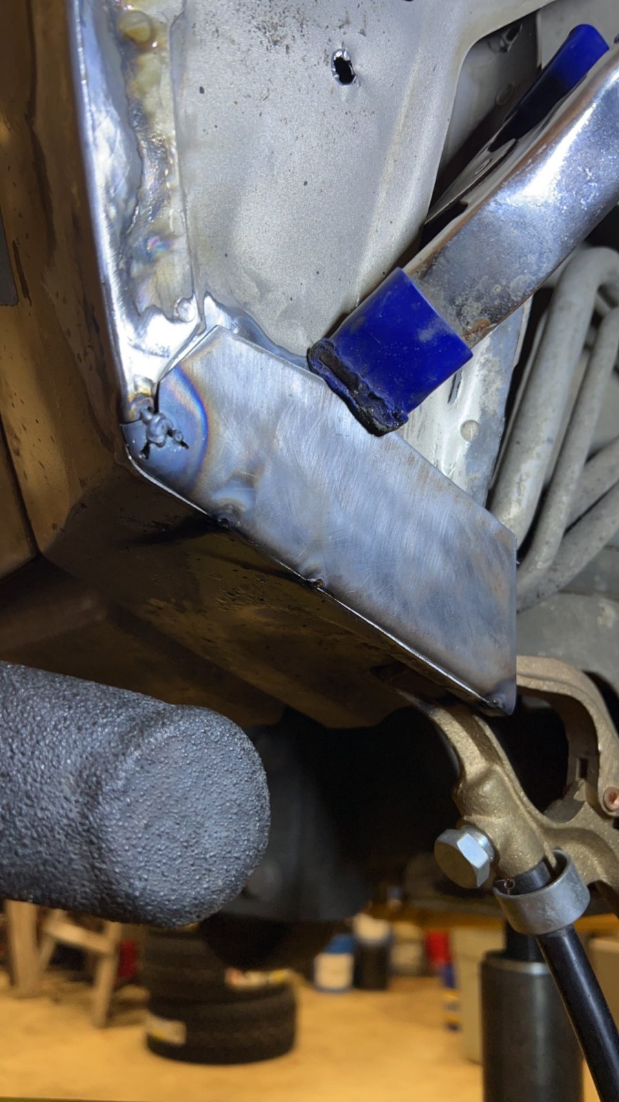

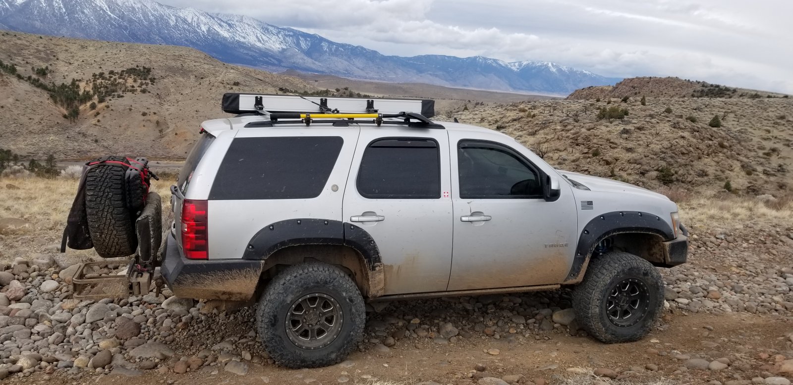

Thought I would share what I did to make 35's fit on a 4" fabtech lift. black rhino 18x9 -0 offset. Falken wildpeak 35x12.5
Cut out 1 1/2" from the bottom of fender and 9" up trying to make the line look decent. Peeling back the outer part and cutting the inner part of the fender was the hardest part. Cutting out that much left me short on the bottom so I just made a new bottom piece.
I have plenty of room to the sway bar but its damn close to the upper control arm full droop turned all the way. Rubs on a small part of the inner fender but planning on making a mount to pull it in.

I have not flexed it out yet with the them installed, but when I was using the wheel fitment tool I unbolted the coil to jack up and turn the wheels. Cleared no problem doing that.
