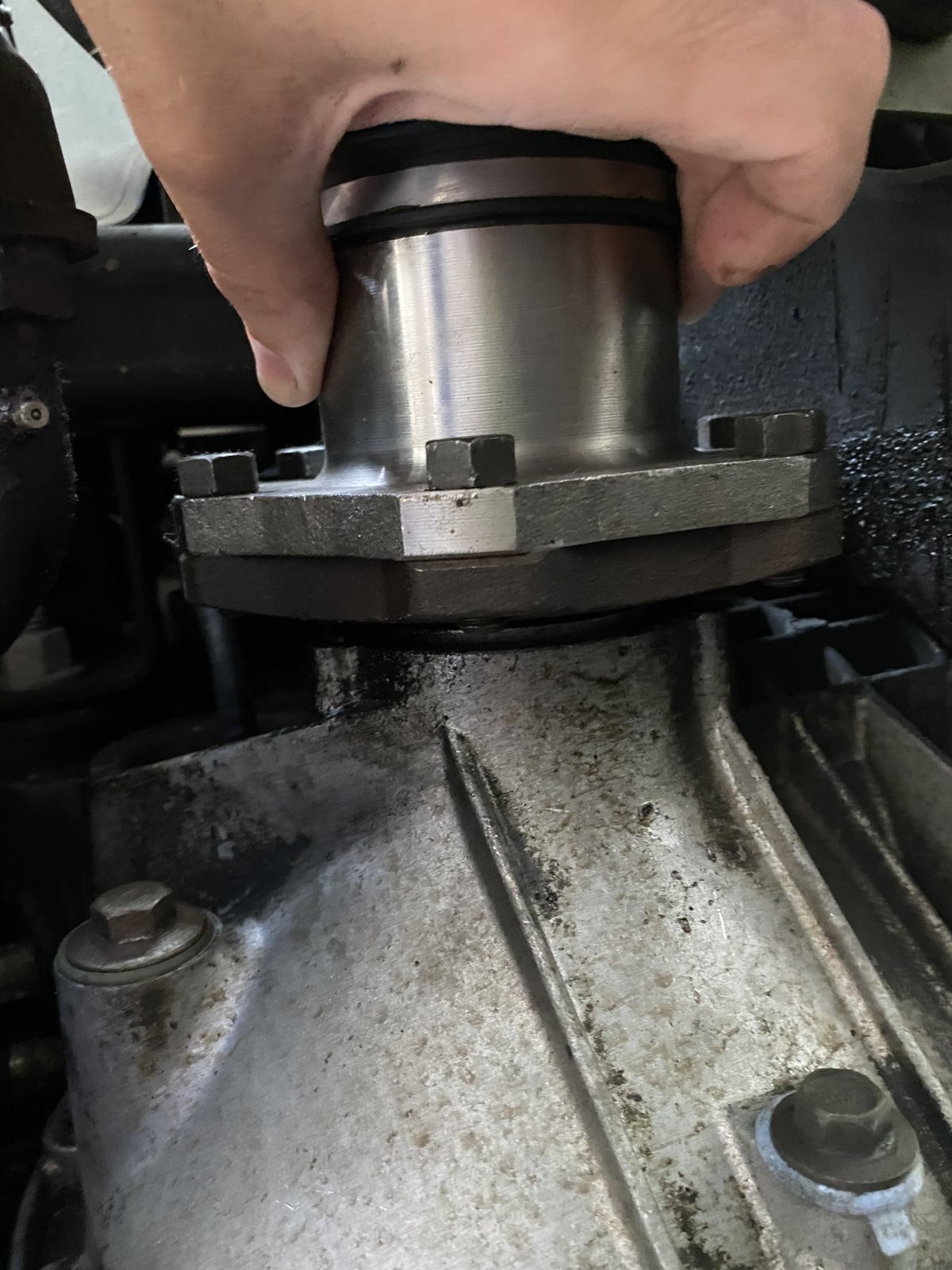

Wheels don’t wiggle when put on Jack’s, however, there seems to be a lot of play where the Axel connects to the front differential and notice what appears to be some kind of fluid possibly leaking around it.....???? I posted a picture, it's the driver's side front. I'm guessing the play is not normal since there is QUITE a bit. Trying to find info on a possible rebuild.

Thank you! It does appear that it might be the front diff that is the culprit, there is major play where the Axel bolts to it. Seeking info On rebuilding it.
The front diff shouldn’t make it feel like the wheels are falling off. That sounds like hubs.
