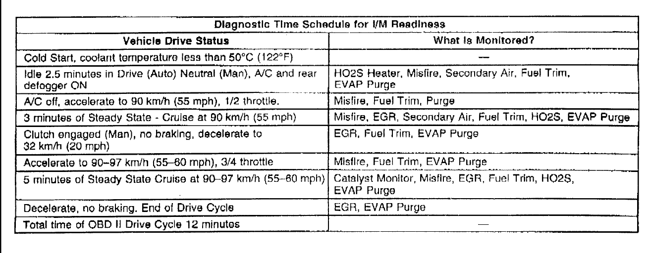

Thanks sunlit. That's the conclusion I was starting to come up with. I took it back in after driving it for 15 miles on the highway and it still wasn't able to register the monitors. The cat and the O2 sensor monitors aren't ready for testing so I'm gonna make a little road trip today and hope that helps to do fix it. I had read somewhere that using all your accessories like AC rear defrost etc. would help the computer kick in due to high use of the vehicles features. Idk if it's true but I'm gonna give it a shot

I got everything good to go this morning but the O2 heater still won't go and I've idled with the brake on and off with AC etc running for the 2.5 minutes. Any other suggestions? Is it maybe time to replace the O2 sensors?
