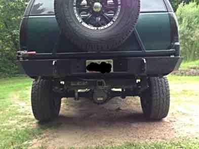

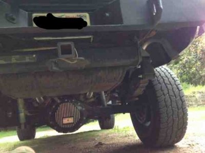

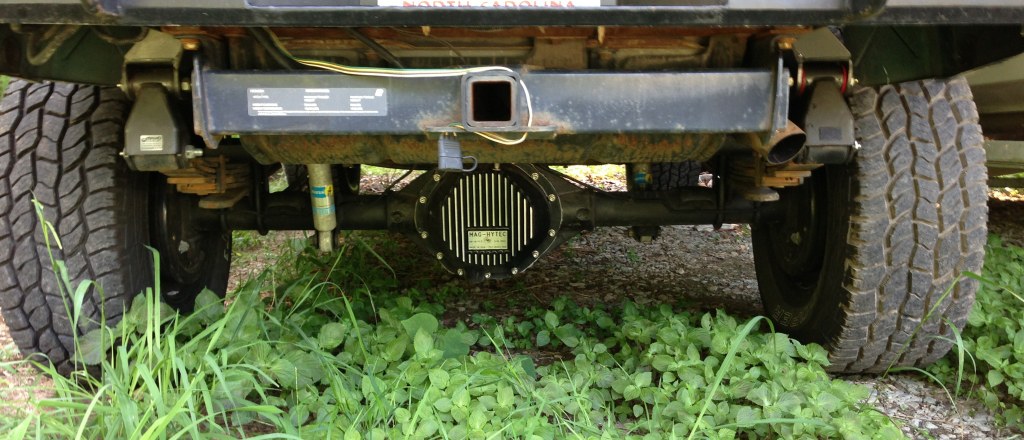

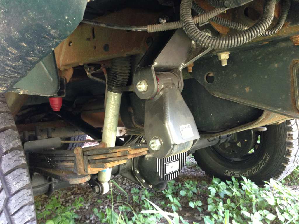

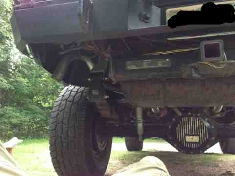

Don't know about exhaust on shackles flip. But mine was dual out the back. I just chopped it off to the doors. Yu got a pic of the hoe with the shackle flip I migh just be I retested in doing it for my 2dr. How did you get the front up
matthop53
matthop53
Oct 8, 2010
41
Springboro, OH
The lift I put on as an RCD knuckle lift with Bilstein shocks all the way around. You'll notice in the picture the red bushing that was a replacement after the exhaust was cut. The heat from the exhaust melted the bushings that were in there and had to be replaced the exhaust then was slightly rerouted as you can see in the picture but there really isn't a lot of room. I am thinking about just keeping things simple and running all the pipe and muffler in the stock location just doing a dual in and single out muffler with a single 3 inch pipe coming out of the muffler. I am pretty happy with the shackle flip as well as the 14 bolt rear differential I installed at the same time. The power transfer due to the larger diameter axle has been much better with the larger tires that are on my truck.
