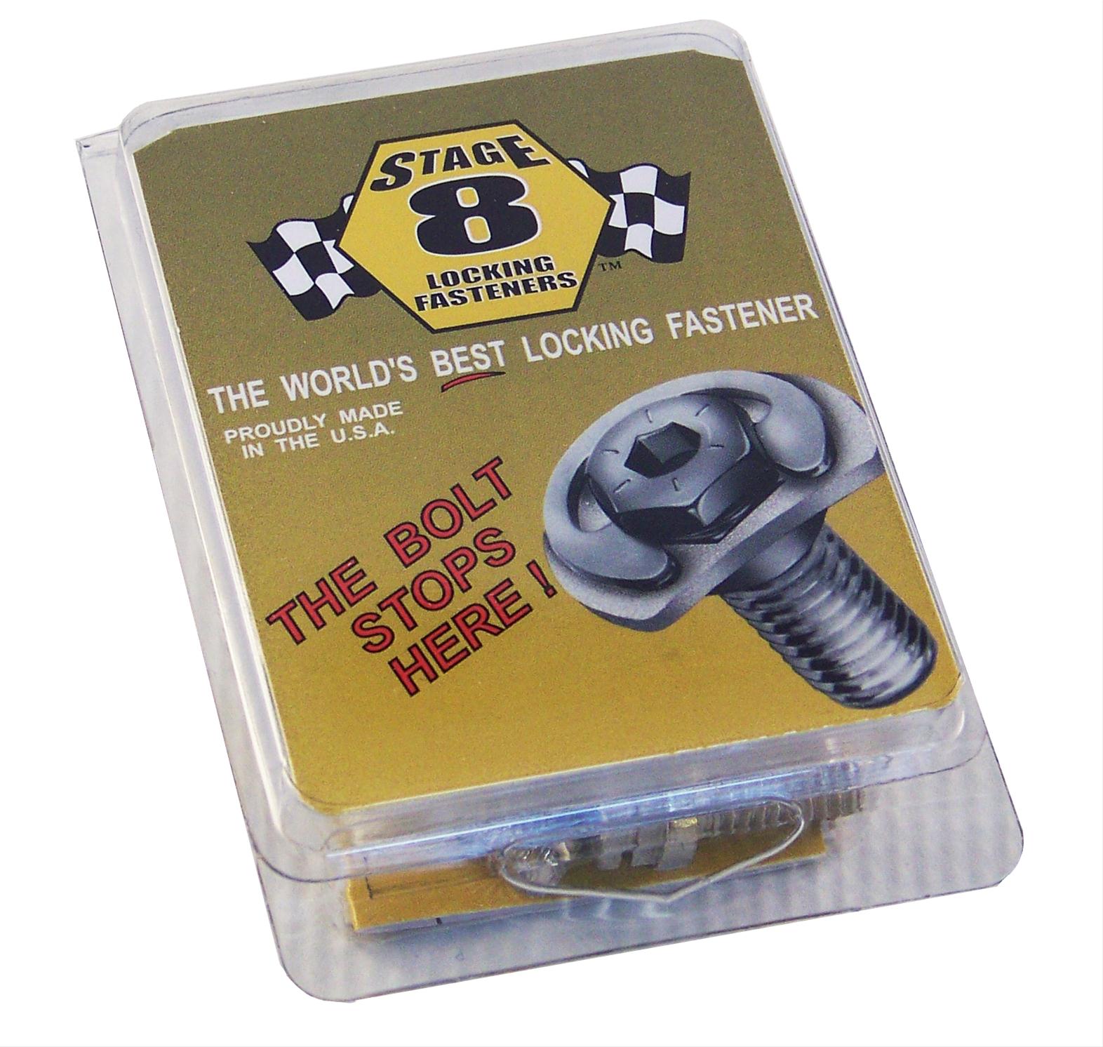

You might wanna try "Stage 8 Locking Fasteners" sold at summitracing.com etc.
