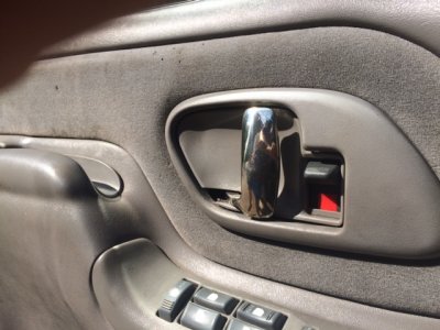

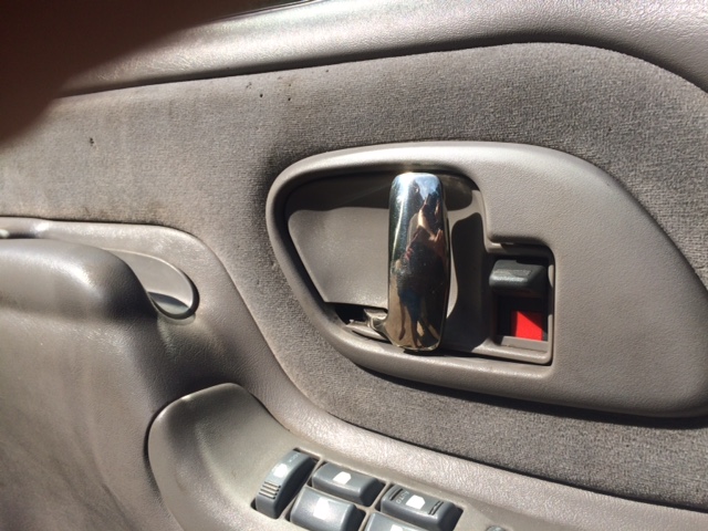

The first thing I did after acquiring Suburban 1999 was to fix the handle situation.
Although, I still have whole ones.

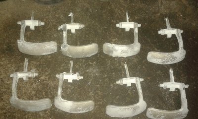

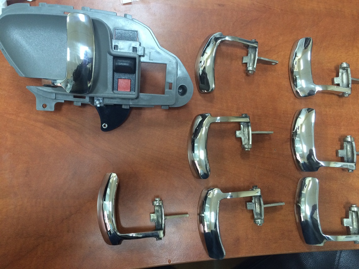

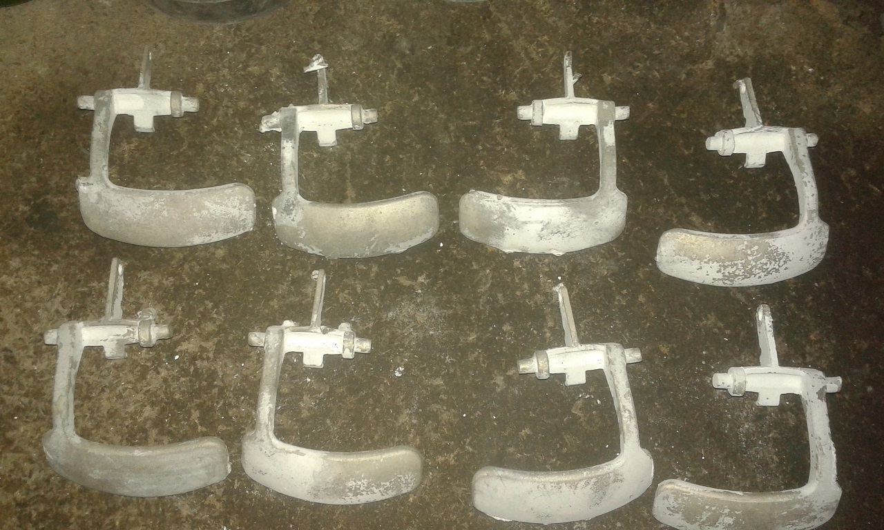

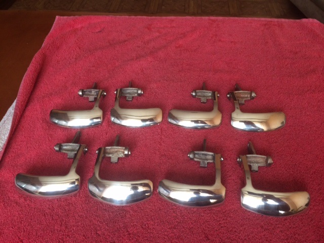

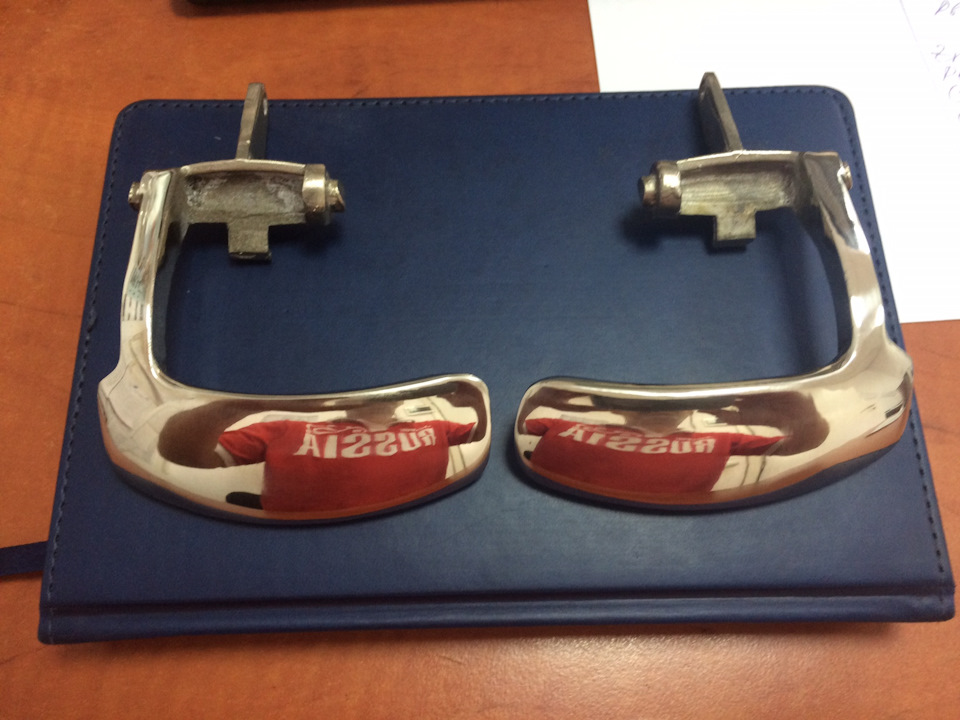

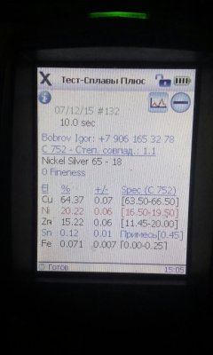

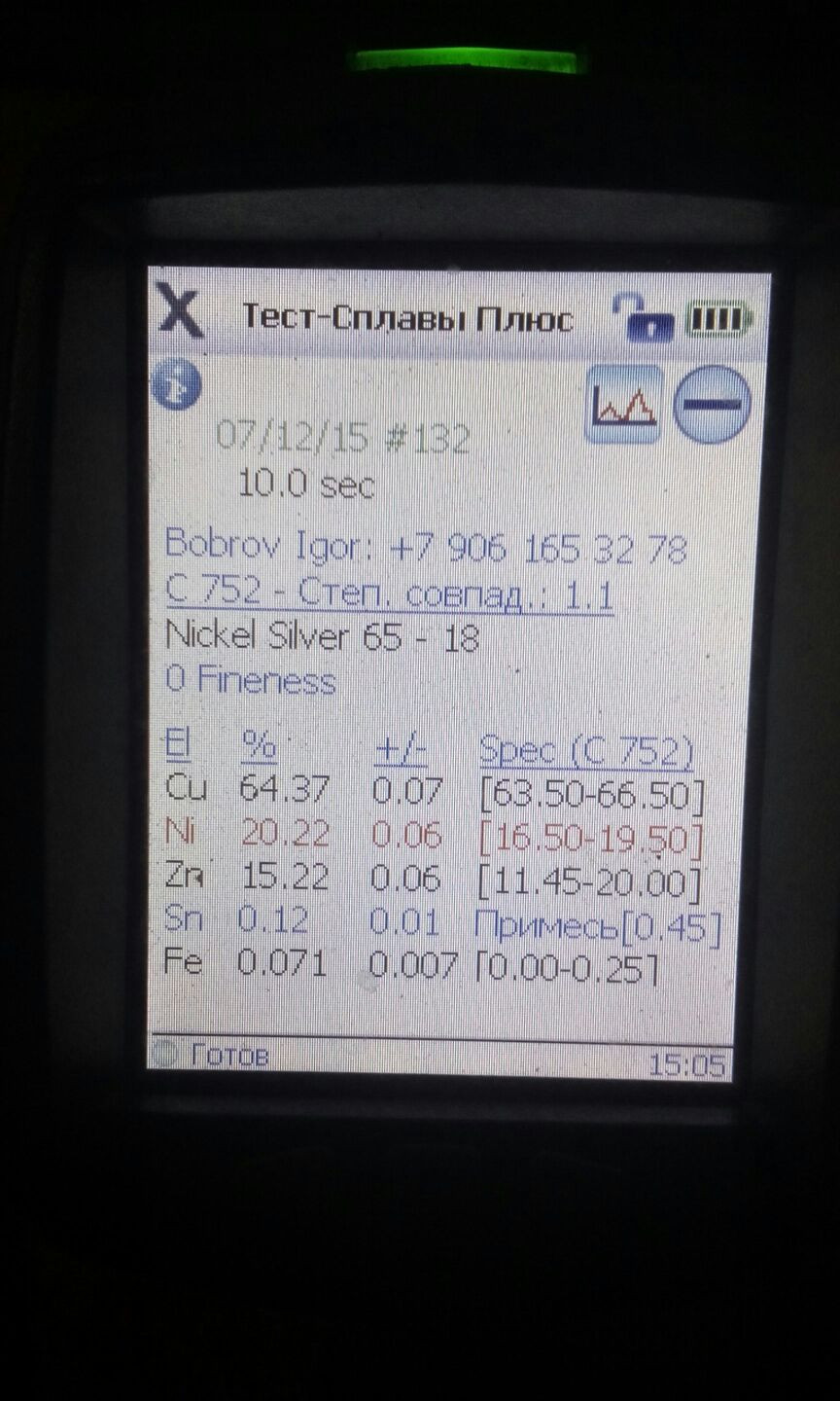

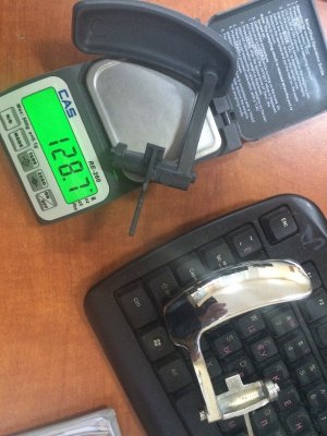

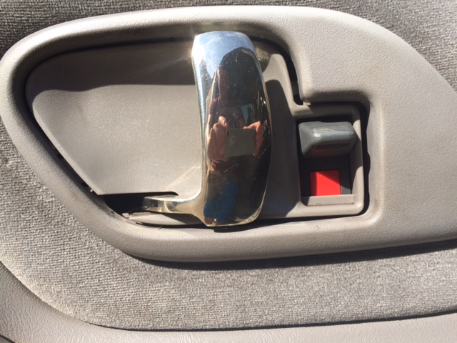

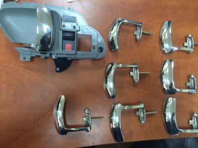

Thought to make them from nickel silver. Magnificent alloy. Analogue cupronickel, but it is perfectly polished and does not darken.
-Bought new pens.
-Specialists made a mold for casting.
-Gave casters, copper, nickel, ...
- Casting + grinding + polishing.
So, the result .....
