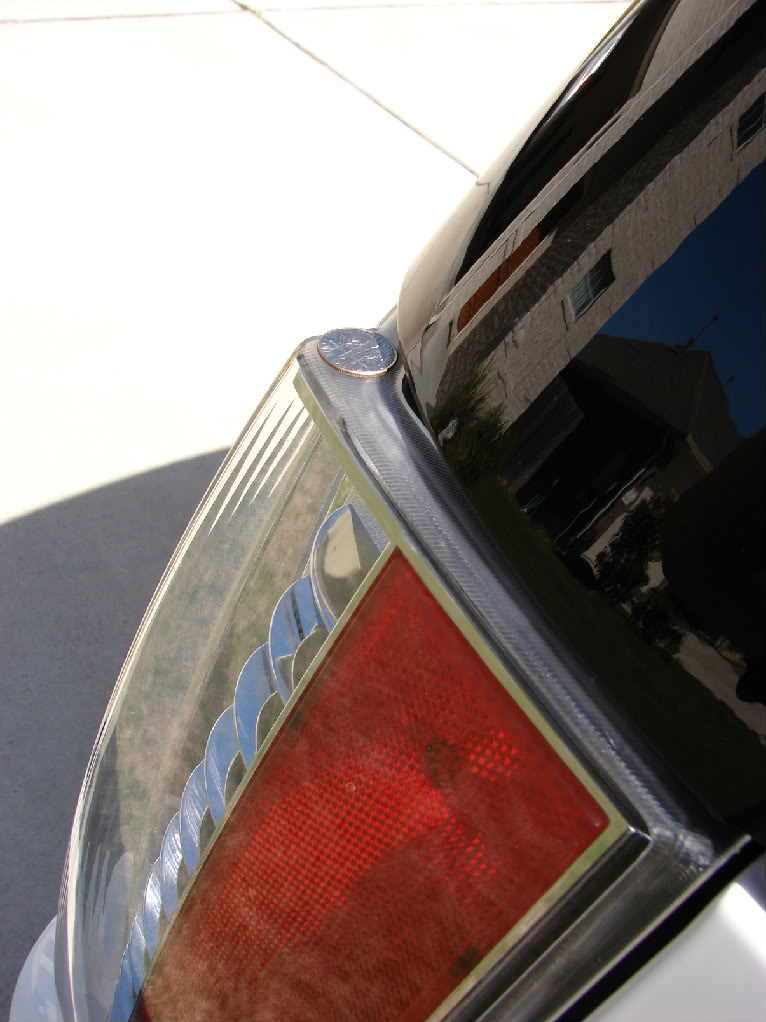

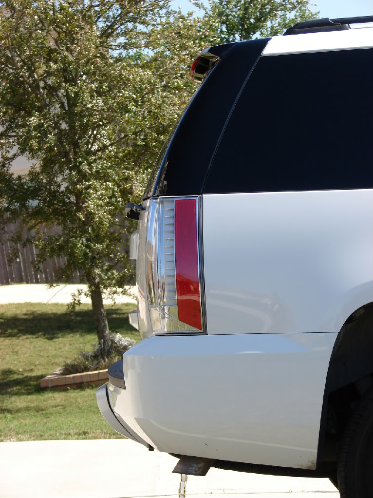

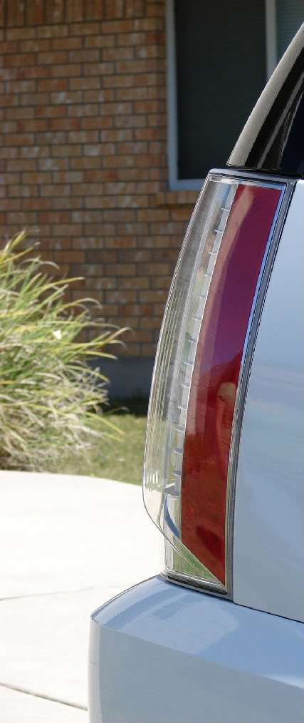

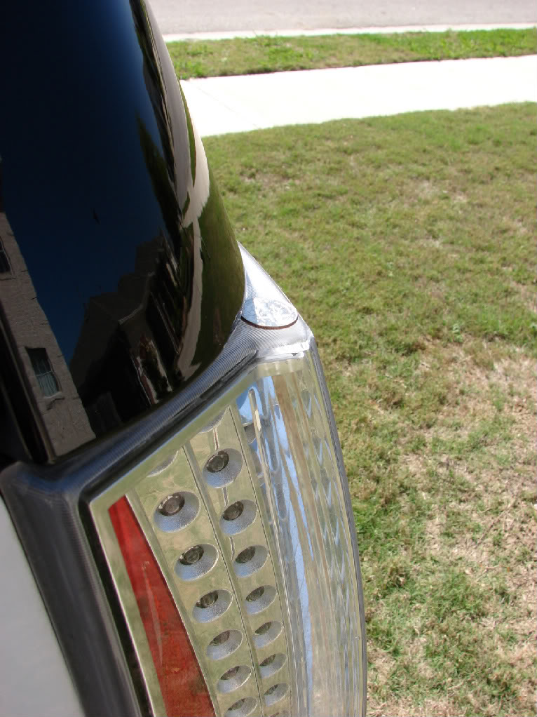

KMeloney is correct, there is a slight difference that will be noticeable if Esky appliques are not installed. Here are some pics from different angles of the shape difference when the Esky appliques are not used in conjuction...
