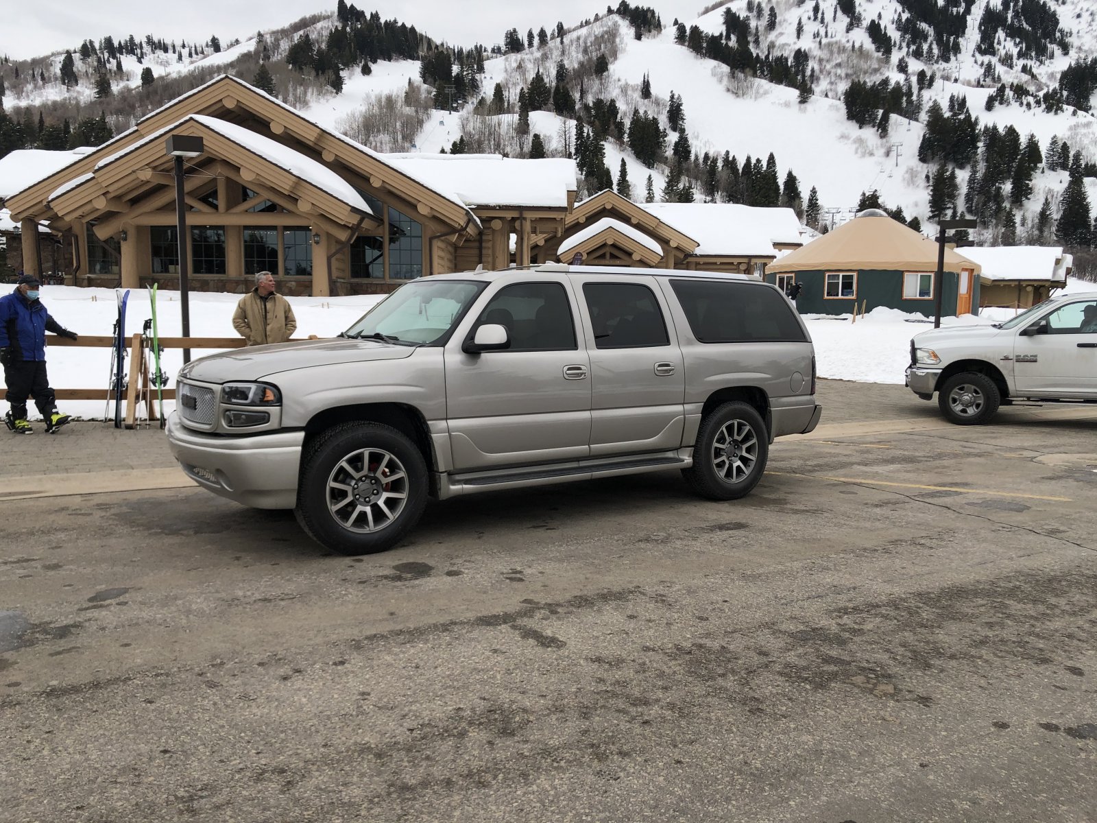

so would the esv rack fit a yukon xl?
Yes. Zoom in on my pic and you can see the ESV rack on my XL.
