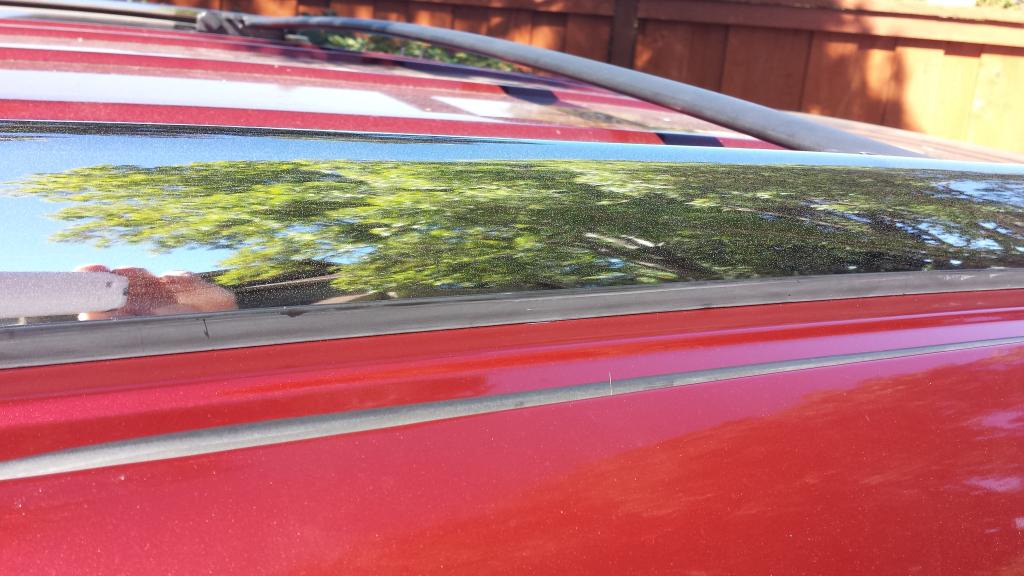

Just got home...here are 2 pics. Used roof rack & I'd say everything is in grade A- shape. I have an 03 Tahoe & this came off an 03 Escalade.
Outside looks good...
Inside looks like this in the middle...
Everything seems to go together ok. That collar/retainer doesn't seem to do much other than position the rail...doesn't do anything to actually pull it down onto the body. Is there something I'm missing?

Looks like when it was packaged or laying on a stand that it warped the plastic. you may try to heat it up and reform it. Or it may do it on its own after sitting in the sun for a while.
