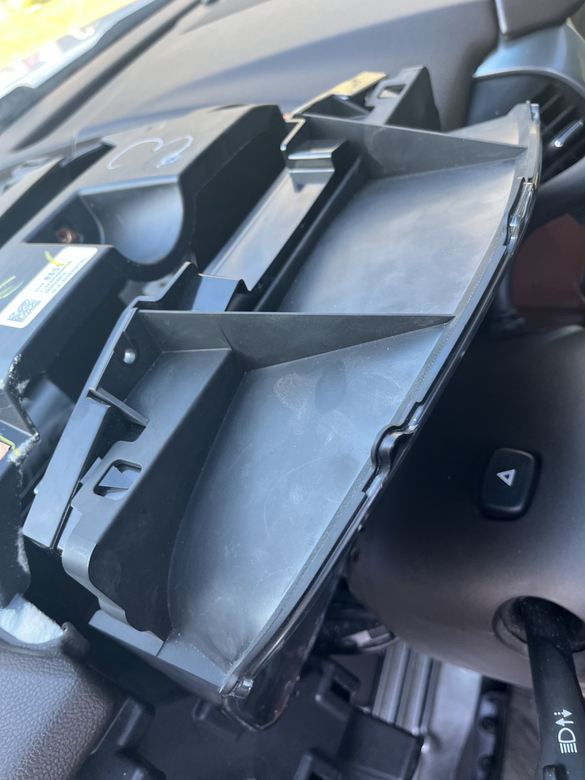

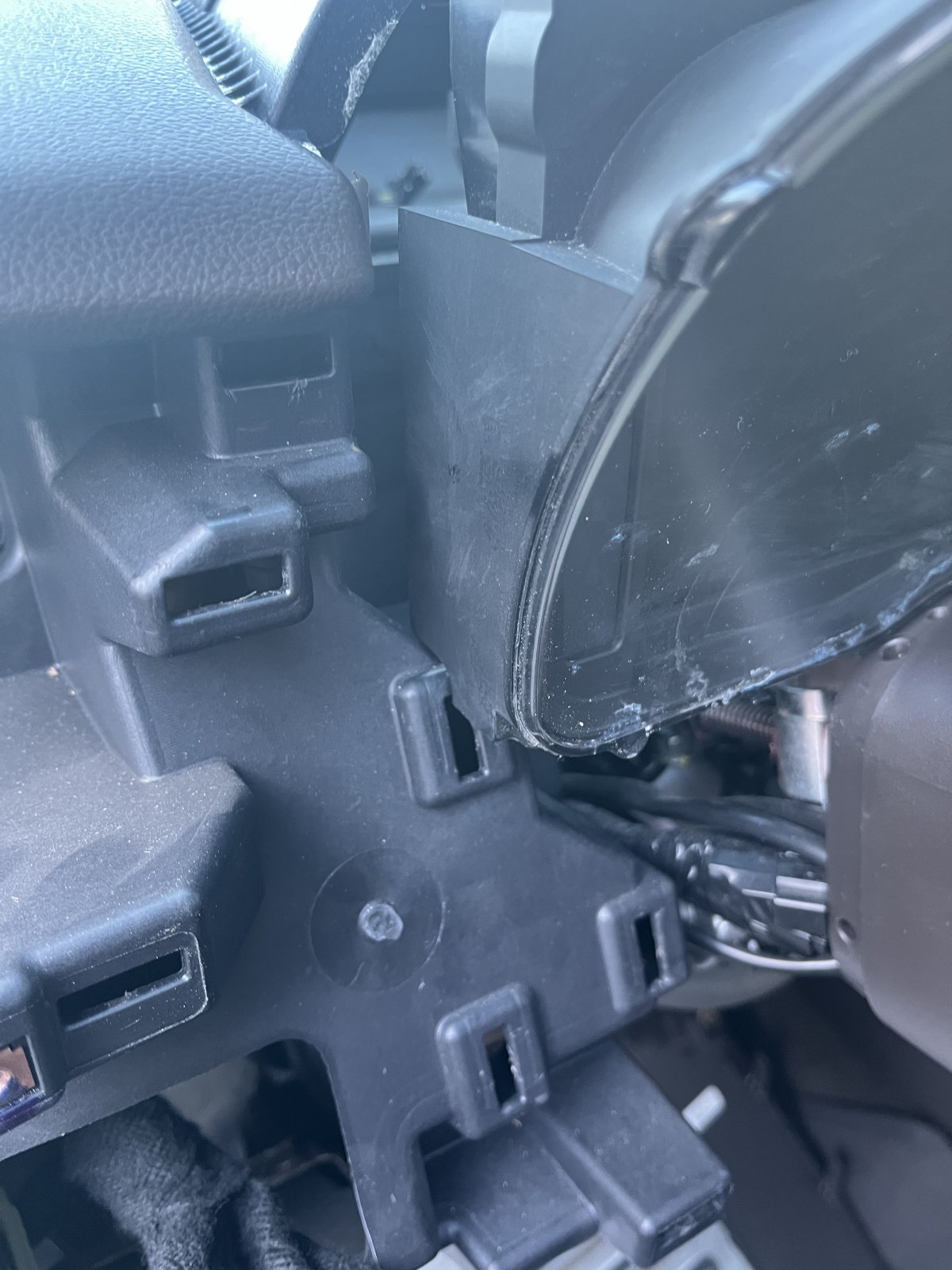

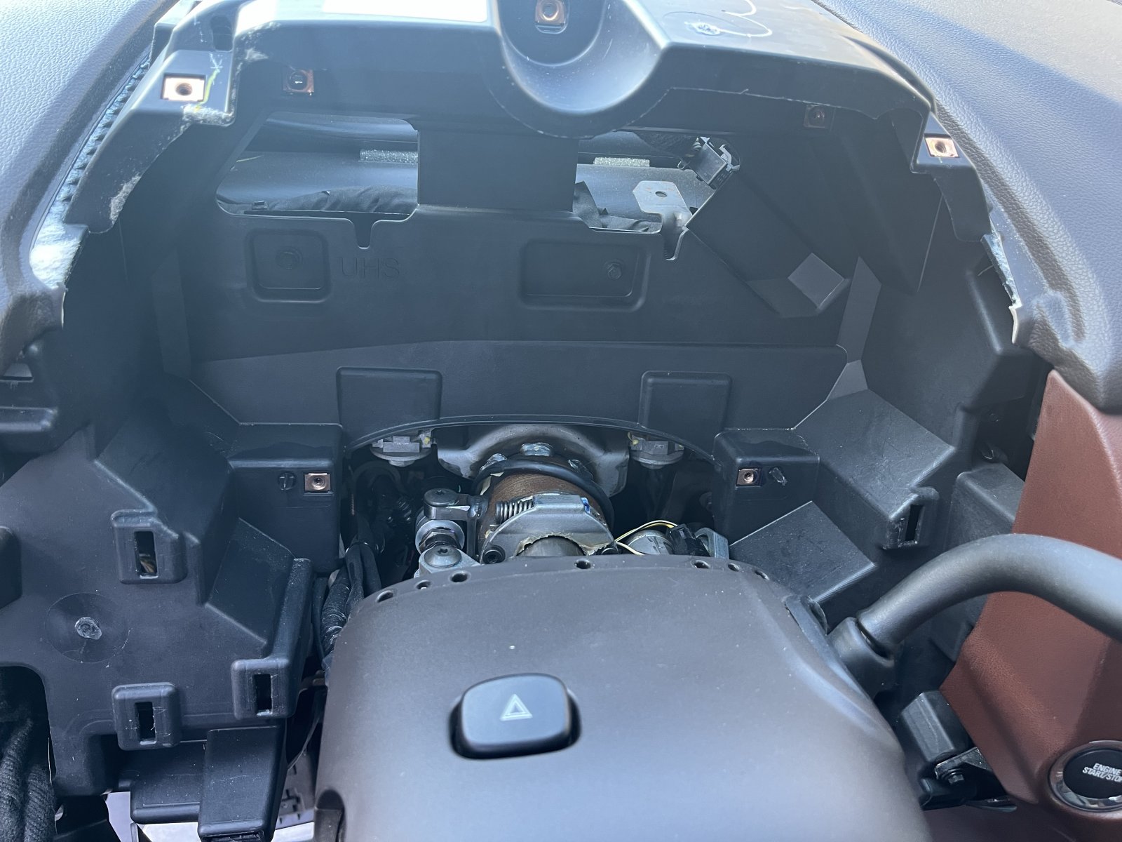

I we talking about the cluster ? i can confirm it works the plugs all line up, all the functions work ect. just the odometer was blank. none of the mounts line up and its noticeable bigger in size, the lower dash does not let it sit in place. I'm picking up the escalade cluster trim tonight and maybe will get some pic tomorrow

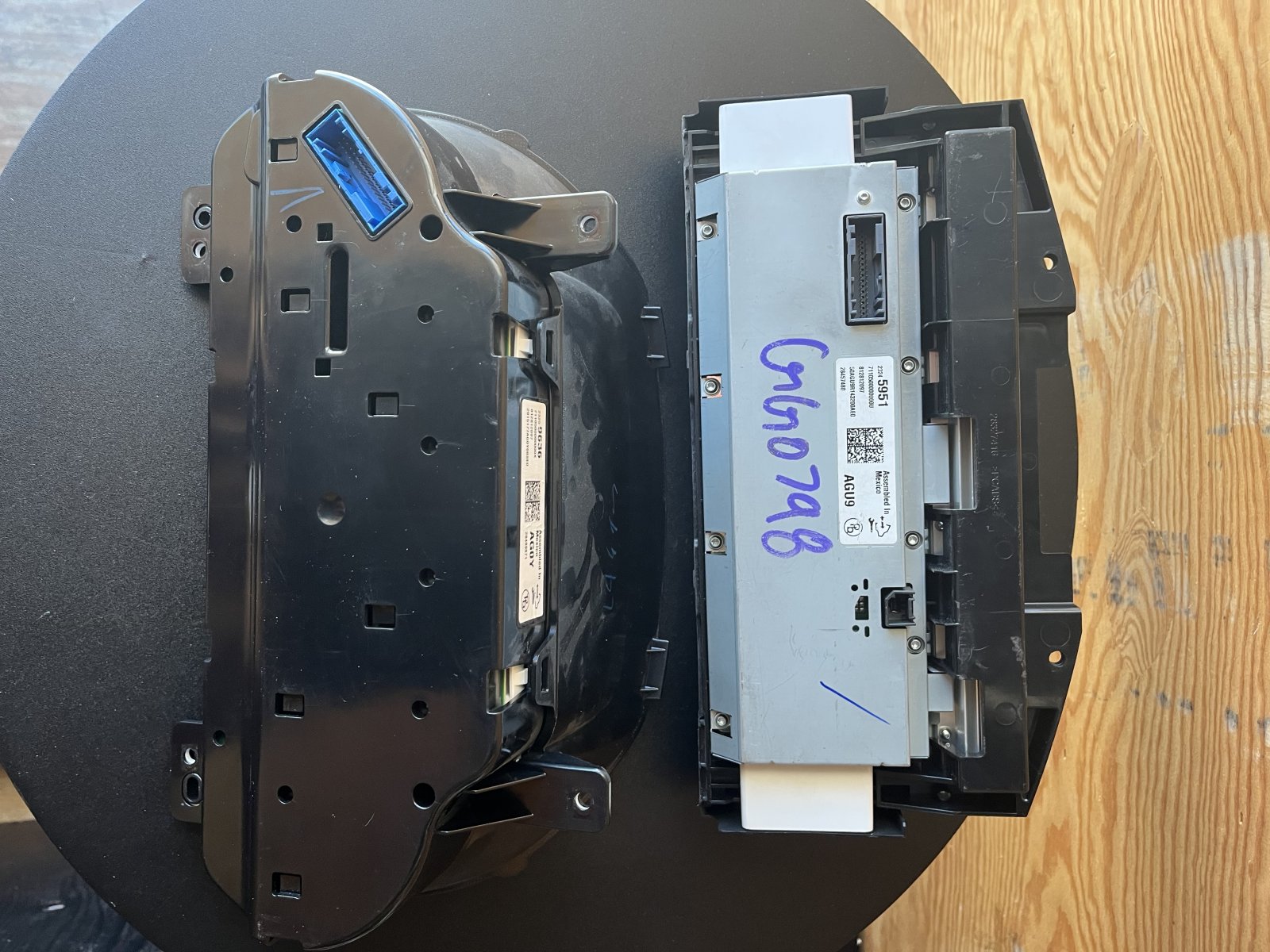

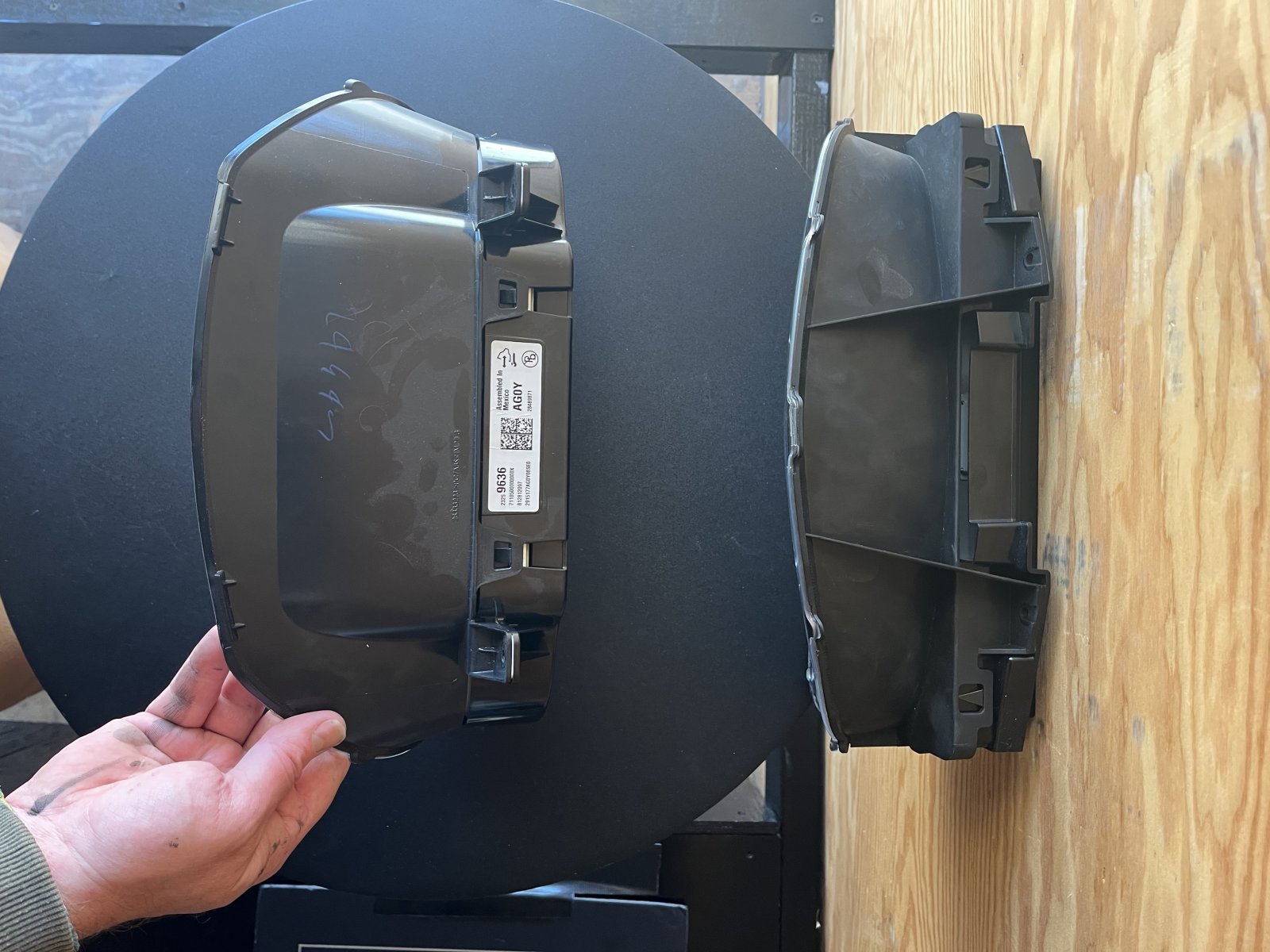

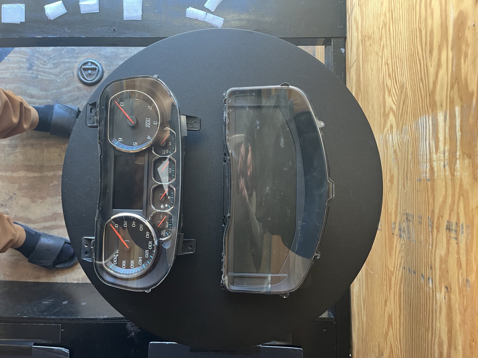

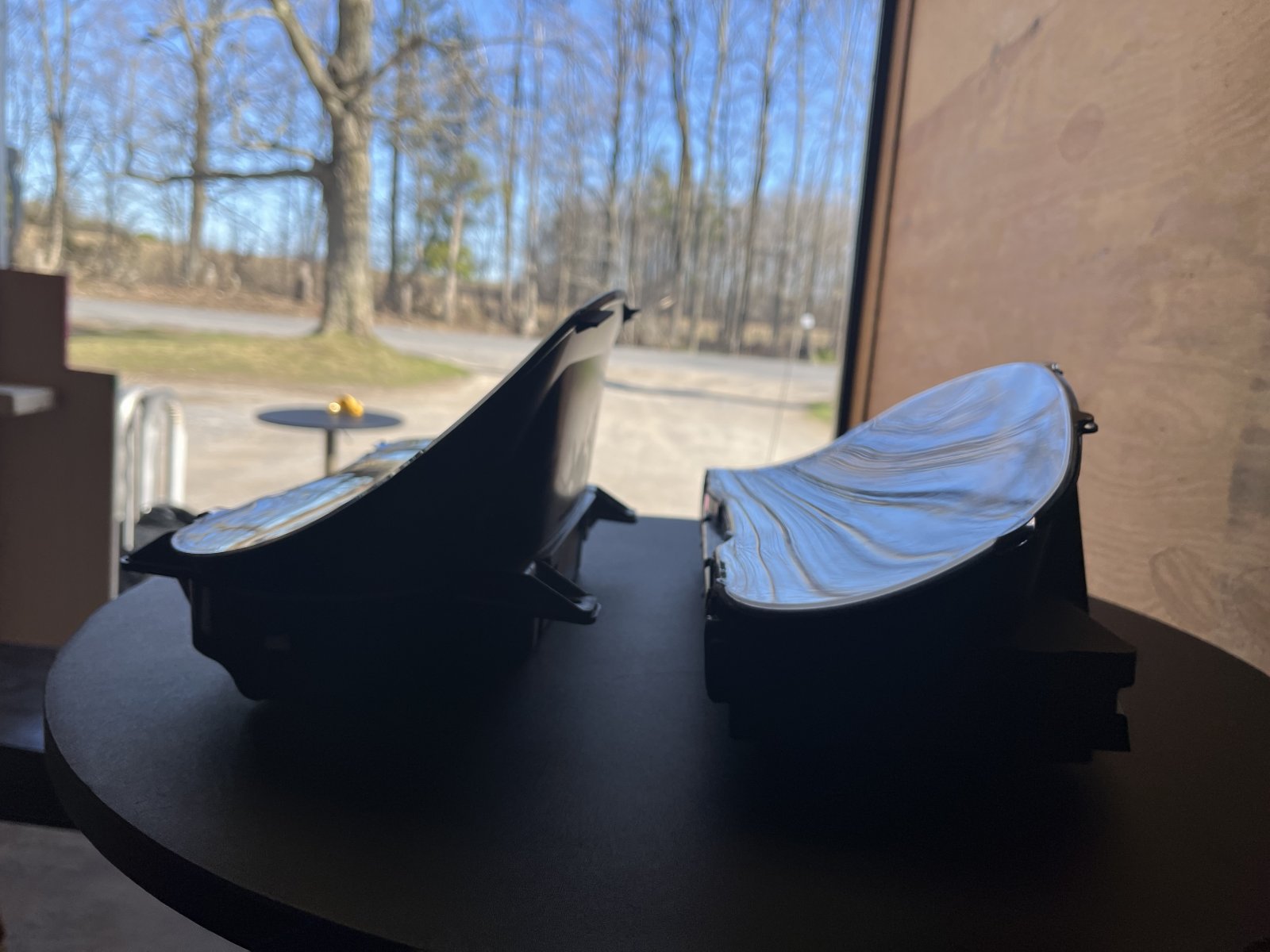

Definitely will need some cutting , not defeated yet , lol the dash trim will have to be fabricated, gonna try to get another suburban one to cut up . Gonna see how much material I can cut off the Escalade cluster (weight reduction) lol

Looks like you are ahead of me. I already knew it wouldn't be a direct swap in, when my goal is, is to swap the internals of the Esky IC, into the frame of suburban IC. That is my hopeful goal. Both of my IC's have shown up, and i intend on taking them apart to see if they can be frankensteined together into the stock frame some how.

Also, the more i look at the comparison photos, the more i'm pretty sure this can work. Keep in mind, even after transferring the internals around, the IC will need to get sent off the WAMS to get programmed. And depending on the donor your got, it may not work. I spoke to WAMS prior to ordering If you are like me, and are looking to also add carplay at the same time, ONLY a 2016 IC will work for you. That has to do with the programming on the tech savvy side of things which i'll be relying on WAMS for so that everything works after the fact. But assuming my half of the plan works, this will be a worthwhile project for me to have one of the only properly done Esky ICs on the planet. Kinda like how my 18 ram is one of the only handful in existence to have factory blind spot monitoring. Sometimes manufacturers just don't offer everything you want, so you have to rifle through their parts bins to get it.

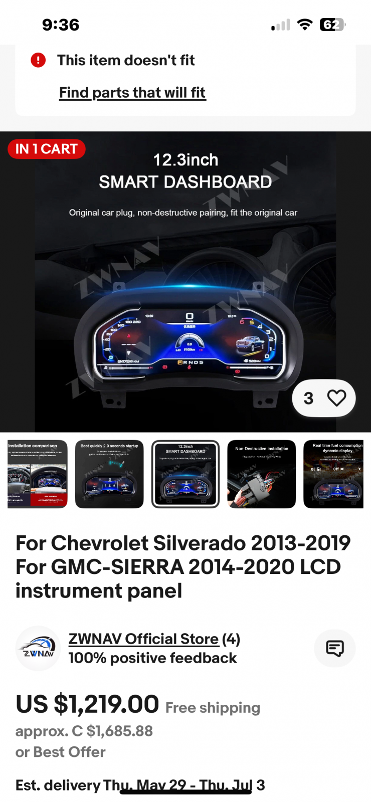

The only issue I see with swapping the internal parts is the icons on the Escalade cluster are wider ie , indication lights …I also found this , it’s $$ but I do t see a suburban option…
I've seen those as well. My guess is they are all cheap Chinese junk. And i don't know how well they will work with adding AA and carplay as well as running the HUD

Just waiting on asky IC to ship....looking at the bezels as well, they are close but also different. Should have a solid game plan once i get the two in my hands
