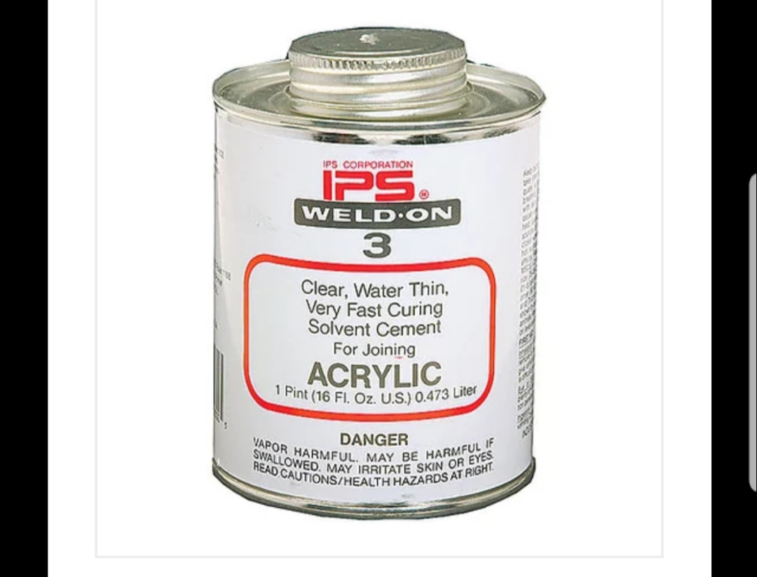

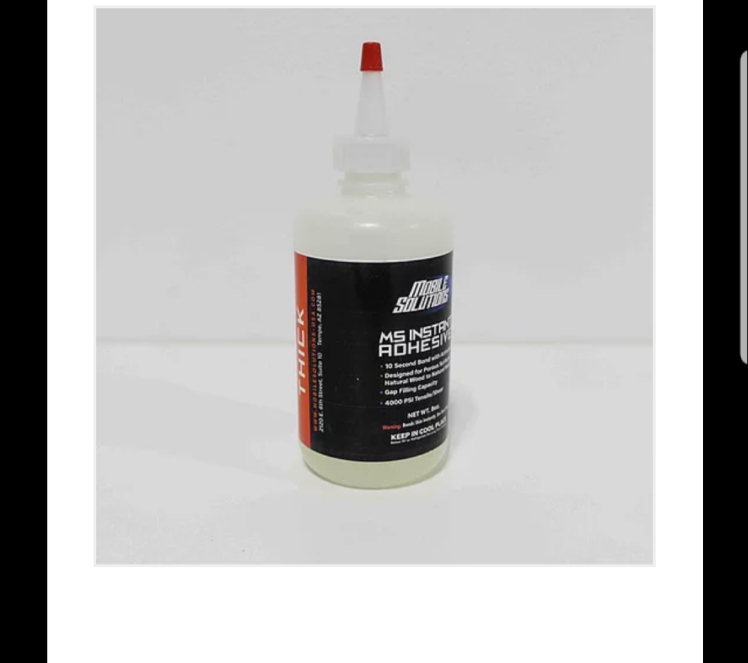

Mold the escalade bottom to the avalanche or tahoe top just like the beginning of the post. Cut it and glue them together with the plastic glue then use fiberglass filler and sand smooth and paint with a satin black to match dash
