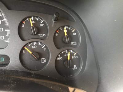

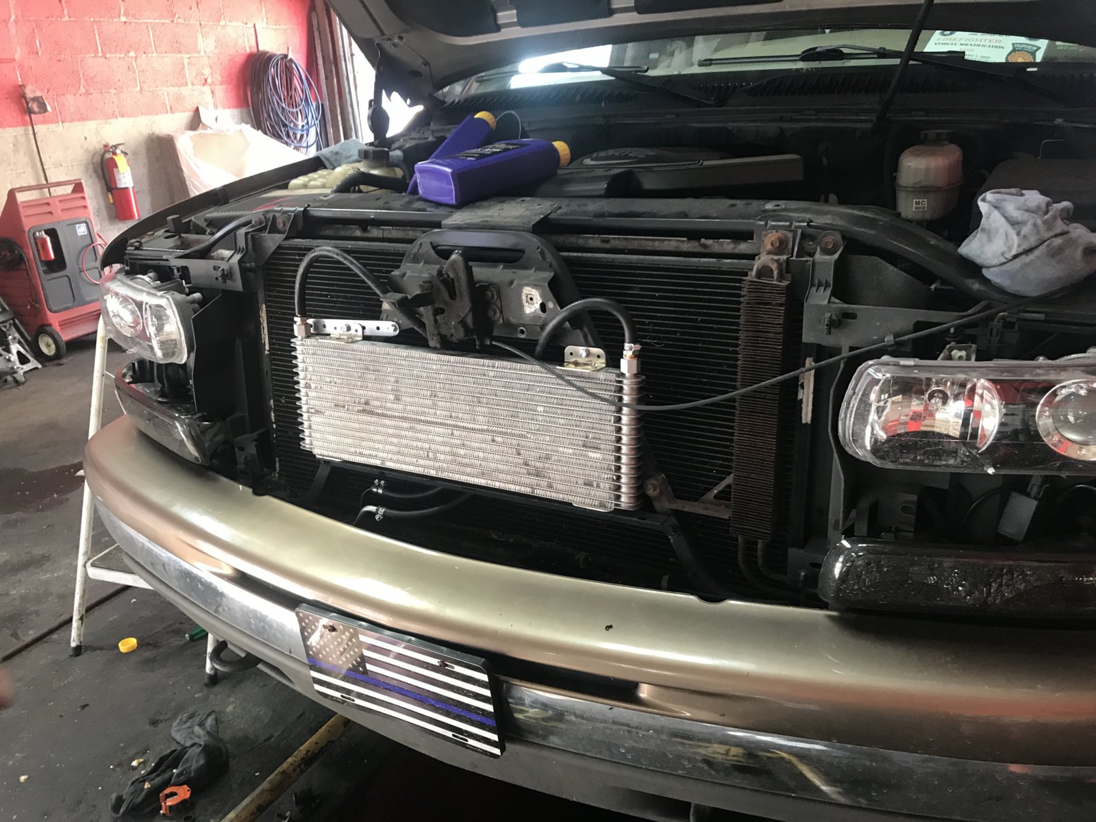

hello guys , so i installed a tru-cool maz 4000 transmission cooler on my 04 tahoe. After i installed i noticed engine running hot when at a red light or for long periods of times on hot days. When can i do about it?

Did you bypass the radiator's transmission cooler? Have you verified the integrity of your fan(s)? Might consider dropping it down a few inches so the radiator gets more direct airflow. Others will chime in.

how old is your radiator? my personal opinion is to replace them after 5 years they get clogged up inside, I have had the exact same problem before: getting heated at a stop or slow heavy traffic, replaced radiator and problem gone. I can't tell from your picture but there are also 2 size radiators that fit in these trucks, if it is the smaller one you can easily upgrade to the bigger one by just changing the fan shroud and of course the bigger radiator, the frame will accept either one and the existing transmission cooler lines/coolant hoses will still fit as well. the fan clutch could be another thing to check also, but if you weren't having problems before installing the trans cooler then it could just be the radiator is not up to ***** and is now rearing it's head.

i would go with swaths comment and drop it down a bit. currently your dead center of your radiator. the trans cooler does flow air through it as intended but it does also disrupt some of the air flow. the center of the radiator is also where most of the cooling happens.

I have mine in almost the exact same spot, doesn't run hot

Could be that OP is in a different climate from the poster above you. 20 degree ambient temp difference will do a lot!
I do agree with swathdiver that putting it right in the middle obstructs some airflow to the radiator and what air does get through is significantly heated by the trans-cooler.

Go back to the original aux trans cooler and see if it's still running warm. If it's not, then your problem is obvious, the larger aux cooler is interfering with the radiator's ability to cool.
