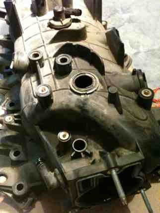

Spoke with the dealer today. After a lot of driving and not being able to replicate my problem, they began to close it up. The mechanic noticed the plastic engine cover was unattached and just laying there. Haven't seen it yet but the intake manifold had a hole in it and someone had put RTV over the hole and the stud was missing. Have to replace the upper manifold. I'll try to get pics of the old manifold to post.
B
Blessed1102
Jun 30, 2013
Found the culprit. The intake manifold was broke where the bolt for the plastic cover mounted in the front. The plastic that the bolt screws into was snapped off in the past and then RTV'd in place. Got a pic attached. Hopefully it works
