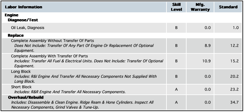

Here is the book shop time. You're looking at 15-20 hours, depending on how complete the replacement engine is, optional equipment, etc etc. At $150/hr. (high average), you're looking at $2250-$3000 PLUS shop supplies, tax, unavoidable broken bolt extractions, what not.

I'd pull the old one and replace all the seals in the replacement engine (all labor for provided parts) before dropping it in for $1,800. Drop it off Friday and you'll be driving it to work Monday morning. Pictorial documentation of all critical steps- TTY values, cover and seal alignments, internal findings, etc. would be included. :deal:
