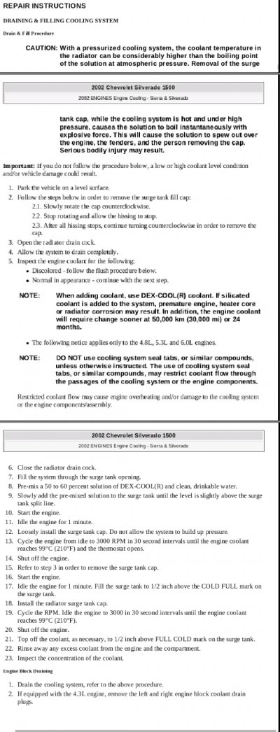

I figured it was the tstat not opening as there weren't any leaks that I could see and no coolant loss. Oil looks good. Changed tsat. Used the procedure shown in attached pics to refill. It's for an 02 but figured it would apply just the same. Maybe not?

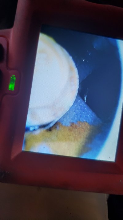

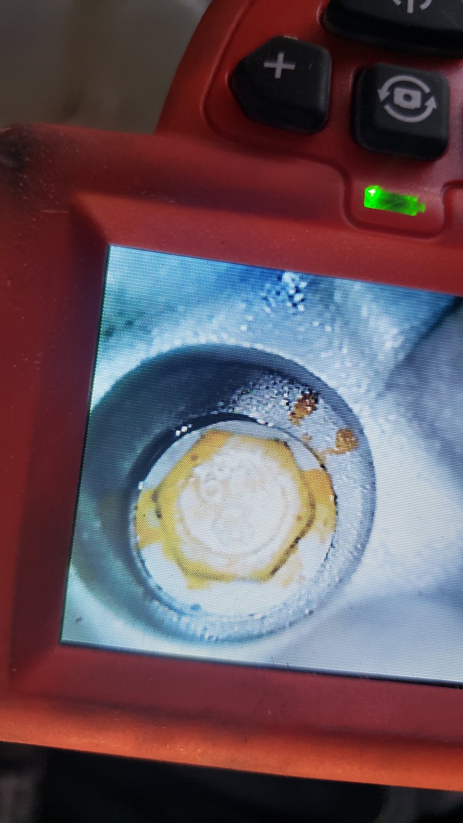

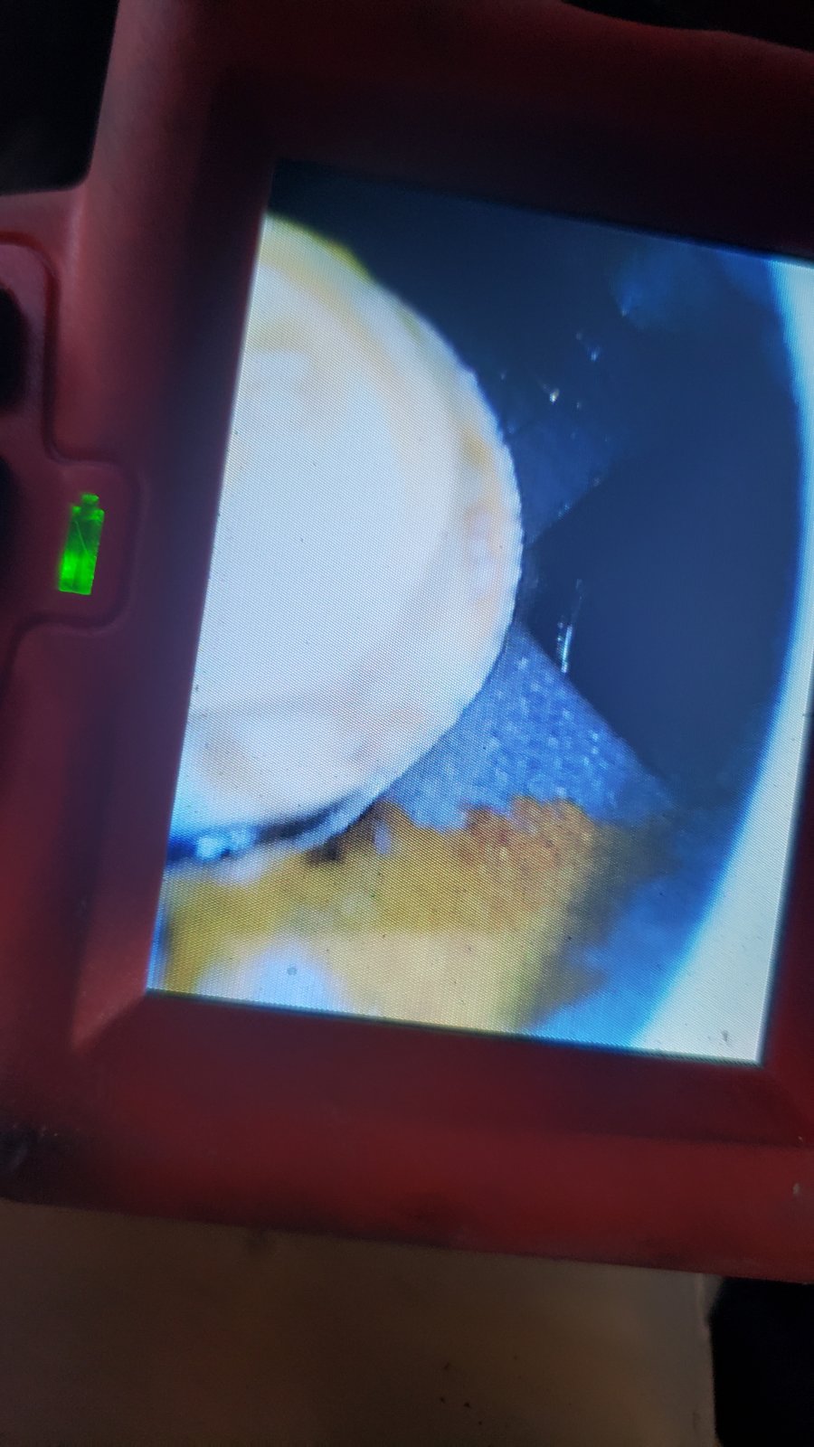

I had to back burner this for a minute but now with a change in situations, of course, it's now a dire situation of sorts lol. I've read about the Castech head issues for these model years. I have a 706. Pulled the right valve cover (will pull the left later today if I can) and found what I was hoping not to.
I was trying to find a crack somewhere but couldn't really see anything.
Even with a borescope, I couldn't pinpoint a definitive origin (pics attached). The head of the scope was too big to fit any deeper.
It's a long story, but I really need to get this truck on the road again asap, and have very little extra funds to do so. A new head really isn't within the time constraints I'm under, so I'm wondering if anyone else that has had this happen to them was able to "fix" it for a little while? It doesn't have to be permanent, just something for a few months even would be a life saver. Are products like bars leak or something like that worth consideration? Should I just JB-Weld it bro? My question there would be where would I even jb-weld?

I think you are putting the cart before the horse here,
even if the head had a hairline crack or any crack for that matter you would be loosing coolant, it wouldn't make it just overheat unless it was a huge hole and again you would be loosing coolant and blowing white smoke.
and you would most likely have coolant mixed in the oil.
not loosing any coolant and simply over heating indicates something is stuck (thermostat), very low coolant, air in the system or water pump failure, cooling fan failure, clogged radiator.
