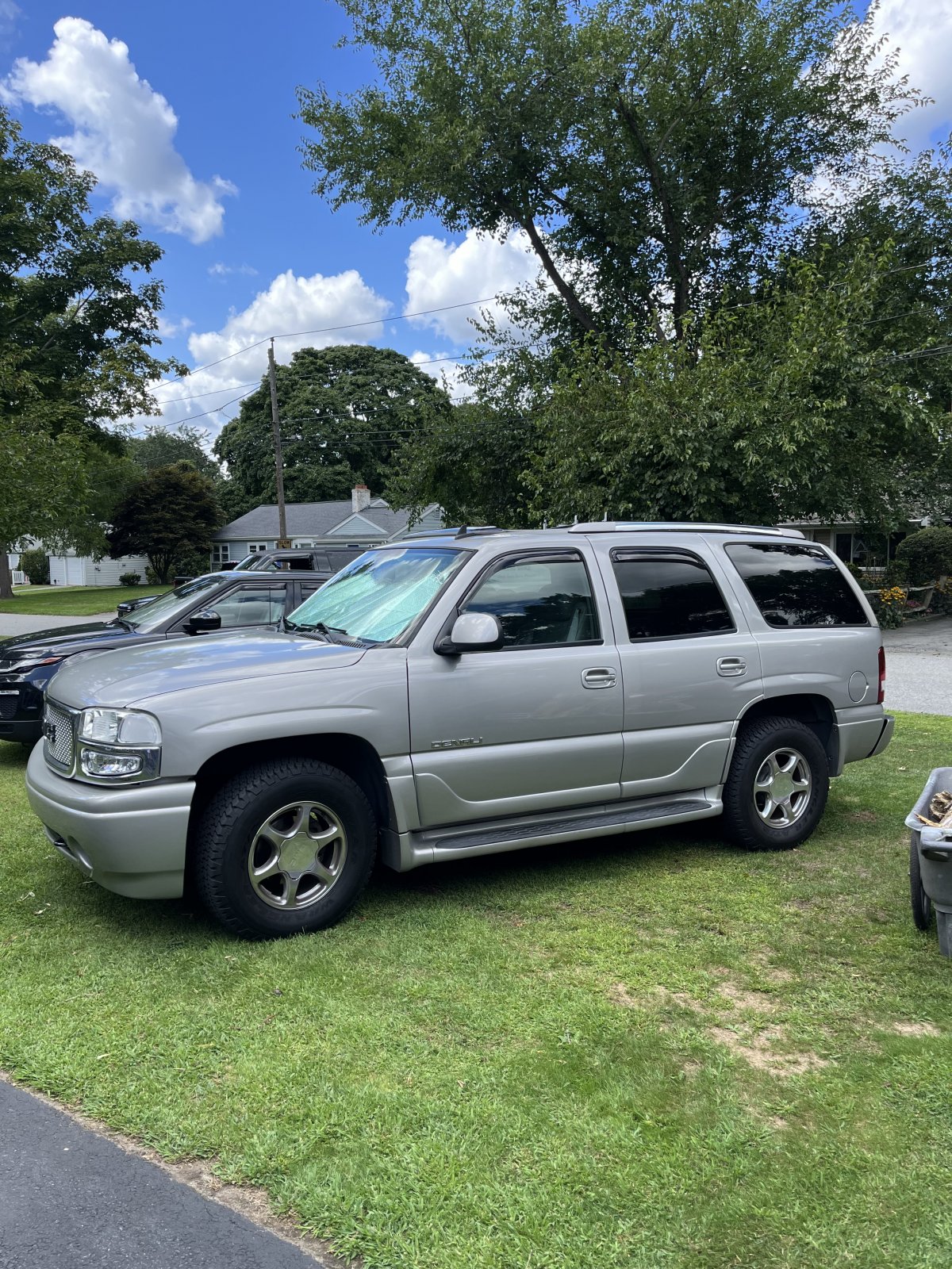

Good evening everyone. I just purchased an 06 Yukon Denali with 90,000 miles. It is in like new condition, garaged from FLA. I did the usual mods, Esky roof rack, new lights etc. Upgraded the audio with Apple car play, back up camera etc. I paid 17K. Thank God I found it and avoided paying big money for a newer SUV. But I’ve discovered something odd. The DIC only says 717 engine hours. That makes no sense as it would mean the previous owner drove an average of 125mph. Any ideas? Thanks

May be a replacement cluster that only had mileage transferred. When I replaced mine, I had all the historical data loaded (mileage, hours,….).
