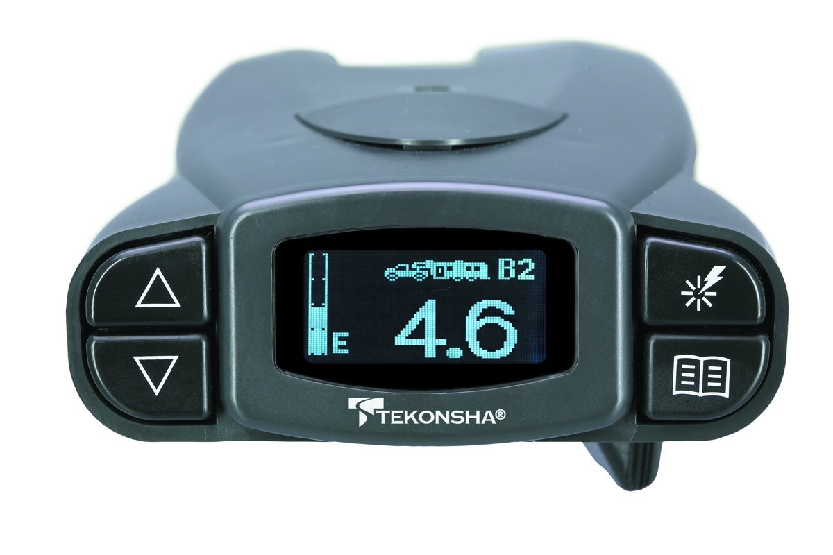

Hey i need to get a electronic brake control. I have been looking at this one
https://www.amazon.com/Tekonsha-901...spons&keywords=trailer+brake+controller&psc=1
i have the tow package on my 2dr 1996 Tahoe with the 4 pin connector, but im not finding a wiring harness for brake controls. What are you guys using, how are you wiring it?
im already going to add a bigger trans cooler as per the tutorial over on GMT400.com

I am using the better unit here: the inertia braking means no trailer brake snubbing in city traffic. My 97 Yukon had factory hitch so wiring was easy. There are two 40Amp connectors by the fuses under the hood.
