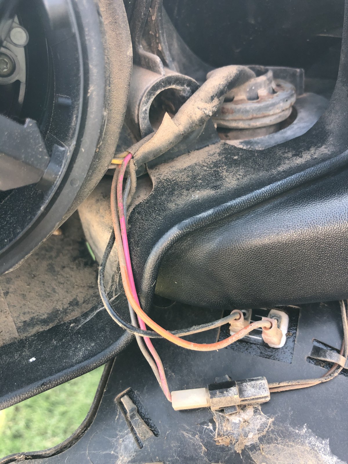

Are there any places out there that are reasonably priced for replacement glass. Mine are heated with puddle light. I bought a replacement but only has the heated wire hookups and I have a third wire. Can I get rid of the third wire and just not hook it up? Here’s a picture of what I have now.

You can leave the third wire unhooked. The OEM glass is ridiculously expensive in all variations (up to $300) and you can find aftermarket glass for cheap but you take a chance on it having a funhouse effect and sometimes it takes a couple before one looks right. The good news is most sellers will accept returns if the reflection looks bad. Look carefully at reviews.

what does the third wire do?

The third wire is what powers the auto dim feature. It’s tied into the center view auto dimming mirror inside the truck. mark is right, the replacement glass that’s the the correct ones are pricey. I spent like $160 on my drivers side glass replacement.

Will it affect the dimming on the mirror inside the truck? I just bought non electrochromic glass to replace it with

Yes, it’s the “monochromatic” feature, aka auto dimming. I think I paid about $40 for mine with heater and turn signals for my 08 but it took 2-3 exchanges with the seller before one wasn’t distorted. The OEM ones with turn signals, heat and auto dimming are close to $300.
