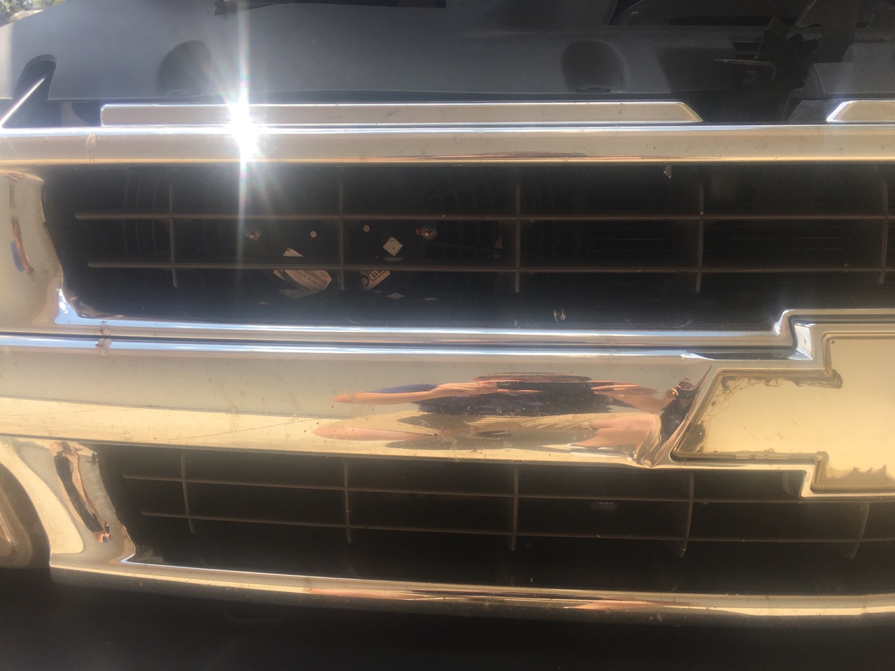

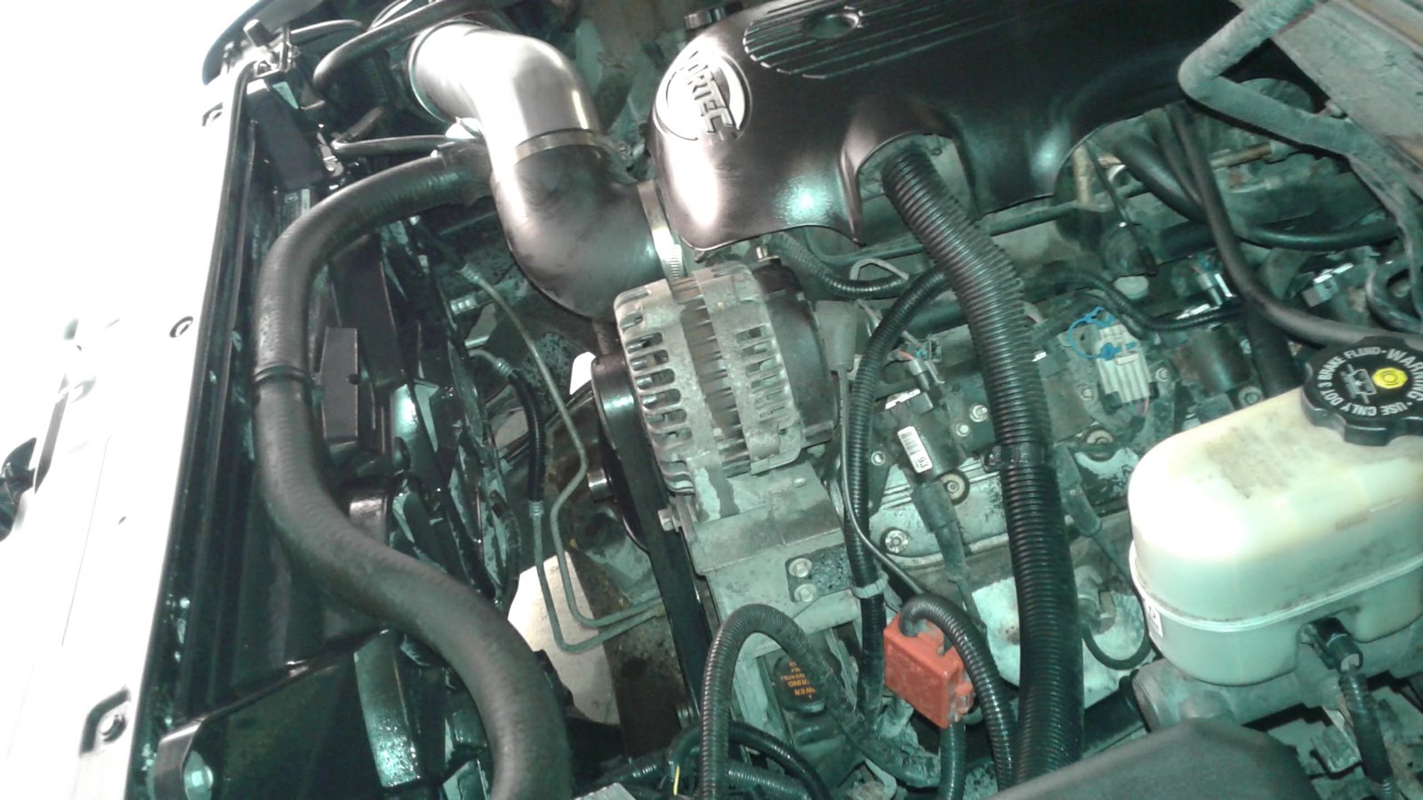

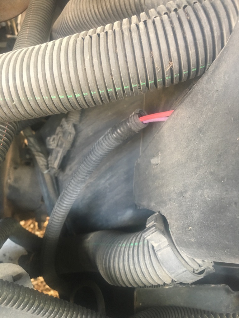

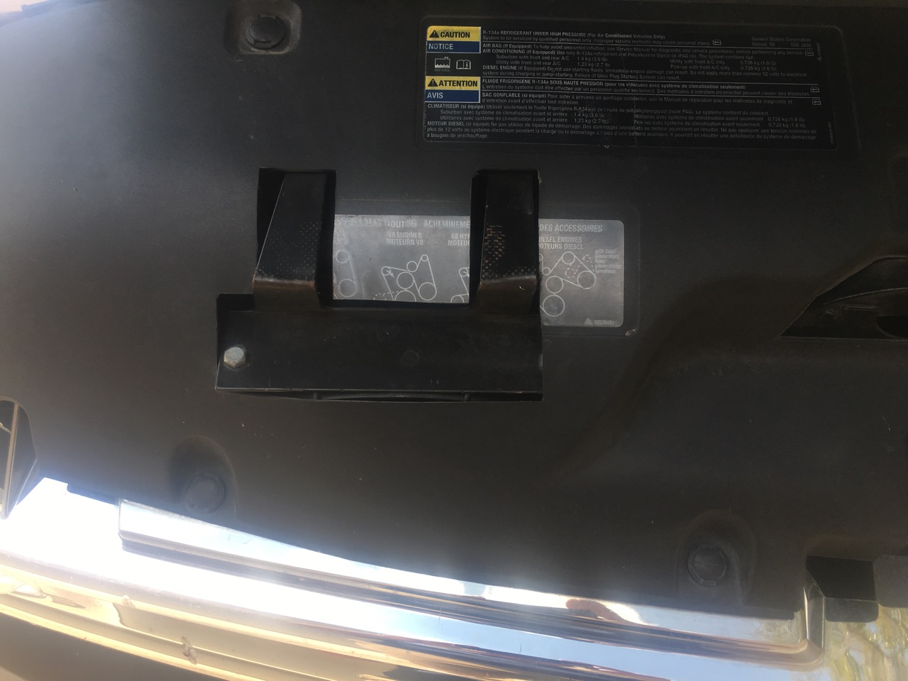

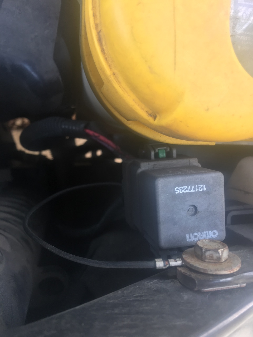

It is actually an oem part from an older hd model. https://www.amazon.com/ACDelco-15-8686-Original-Equipment-Auxiliary/dp/B0012PM154 is the fan assembly. http://www.ebay.com/itm/NEW-GM-COOLING-FAN-HARNESS-OEM-88880045-/160862845754 is the harness you need. Sorry if the pictures suck it's kinda hidden behind the grill. Upper bracket has to be bent different to fit the upper radiator support, mine is now riveted in the upper and lower bracket. Relay harness trigger wire goes to the ac clutch trigger wire on the bottom of the fuse panel. Relay power wire goes to power stud in fuse box. Relay ground goes to mounting bracket. Relay output wire goes to fan harness. Fan harness ground I put to trans cooler bracket. Hope this helps. Big difference in ac temp at idle compared to before.
