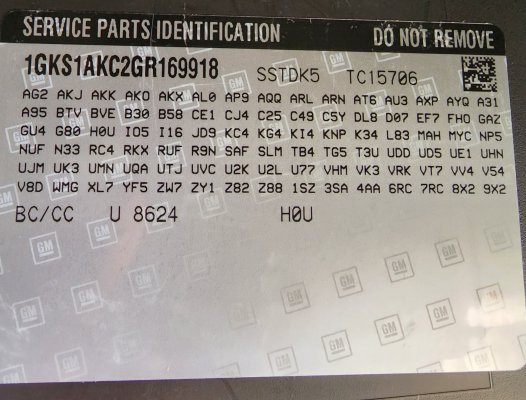

My vin eight digit is C and I'm trying to figure out if my engine is flex fuel there are no badges or stickers on the fuel door
1GKS1AKC2GR169918

gtarango71
gtarango71
Oct 10, 2022

Apparently not Flex Fuel. @swathdiver's post here:

You have an L83 which I believe can be optioned for Flex Fuel but not all are equipped. If you have no badging and a black gas cap, it isn't Flex Fuel.
His has the FHO RPO code:
Note: Vehicles equipped with RPO FHO, E10 gasoline are certified for this fuel type and cannot be modified to allow use of E85 flex-fuel.
