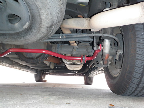

Hey guys I need some help. I just purchased these and had them installed by a local shop that I know very well does great work. However the tires rub on bends in the sway bar. Now here are outliers if you will. the end links that were on the truck before had 4in sleeves and ones on there now are 3in sleeves. The truck is lowered (2/3) drop and lastly the tire size is a 305/40/22. I'm looking for advice or opinions I am going to call them on Monday but I am hoping to find some answers sooner then that thanks.

Never heard this problem, sounds like the backspacing on your wheels, maybe you can get a small (like 5mm) spacer set. Are the 305's bigger than the OEM tire size?

Haven't pushed the ruck enough to really notice. I will say the cornering is FLAT when compared to OEM bars.
Really was a HUGE improvement.
Next plans are to install the Energy suspension bushings.

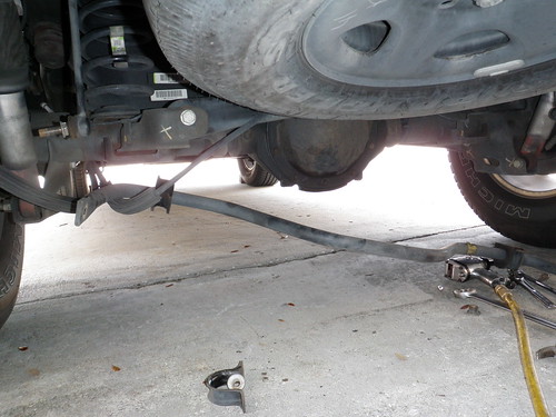

The bar will drop down easily.
Old vs New
Re-install everything, making sure to grease just as you did on front.
